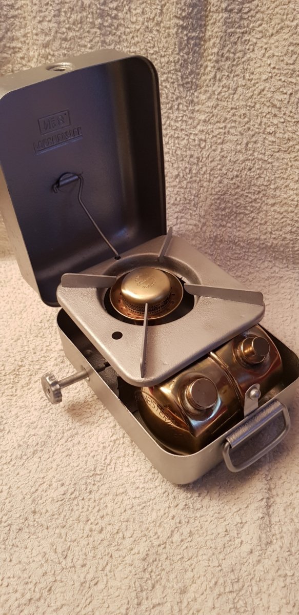

    Finished with cleaning, polishing as well as something special perhaps, the choice of paint metod. The original paint had a slightly special texture, almost like orange skin. Would try to preserve that structure. The surface with the original varnish was therefore given a varnish scrub, some removal of rust growth, as well as insulation of the substrate (something gel-like that binds rust), before the new heat varnish was sprayed. Did not get too bad, obviously far from perfect, as naturally a lot of the condition of the substrate appears. This also applies to the orange skin structure It was kept OK. Should light it when I have a better muffler cup. The one on the photos, is burnt to death.
    Lots of mounting bias on this one. Don't know how much of it was from the start. So far no easy opportunity to correct the position of the thought has been seen. May be this way. Now it's on the shelf.

    Forgot to tell, maybe not all now;
    Model 1 Fuhrmeister 8 was in production from 1947 to 1954 , when the more often sees Model 2 came in production.
    Model 1 has smaller tank, the cooking plate are not hinged, and the tank together could not been easly taken out of the box. And of course it was "lefthanded"
    Last picture hopefully shows the original color also was silver.

    Hello JP2!
    Well, not much to see, I`m afraid! It`s a burner from Radius (swedish) I don`t think it`s original! Fuhrmeister used Radius roaring burner at their first model 7 and 8. But I don`t think they ever used silent burner from Radius. By reading "something here and something there" about it, they produced they`re own silent burner, and used it for model 7, model 8 (first model) and 10. I seems that the burner was really bad, it seems that the brazing went up, special when use of heating top, whom was possible on the model 7 and 10. You can read about how bad reputation the model 10 got from that, on an advertising doc. from Fuhrmeister. They made Fuhrmeister burner model 11 for Cooking stove Fuhrmeister 8 and Chimney Fuhrmeister 12. In the advertising they offered to replace the old burner on Chimney model 10 with the new burner model 11. The modell 11 was a burner for the future as we see it now. It has its own cleansing needle, and the way they made it it could take the heat from the heating tops on the F8 (model 2) and the Chimney 12. As they write it, they got contract with the norwegian army with the new model of Fuhrmeister 8. It was a bit of a succe until around 1960 perhaps, when it seems to be replaced by Optimus 111. But when it comes to Fuhrmeister 12, it seems that they could have destroyed most of the reputation on the old type, N.10. The Fuhrmeister 12 dont seems to sell a lot. I`m sorry, it was a to long answer to your wish.

    Mostly F8 wich is expensive I think!:?It`s hard to say, exact! Maybe several reason:-k One could be that Fuhrmeister did`nt show up until recently (last 15 years) on the international arena? Maybe! Maybe it sems to be in someway genius, and important; The silent burner on F8 (model 2) One more thing; It seems that the F8, only in small numbers are sold to countries beside Norway. They are sold, at least the military model F8, outside Norway, I have seen instruction for it in german, and Egil Fuhrmeister grandsun claims it was sold to "other Nato Countries".

    The first model of Fuhrmeister 8 has other colors than second model F8. Most F8 model 1 that I have seen "live" or at photos are green, same color used on Fuhrmeister 7 and 10. Fuhrmeister 8 are mostly now`n in military green color, but as you see in Fuhrmeister section here at CCS, it also came in dark and light blue, and also lighter green.
