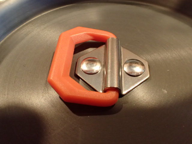

    The lid has a lifting tab that stands up when tilted one way and folds flat when tilted the other. Handy for not burning one's fingers.

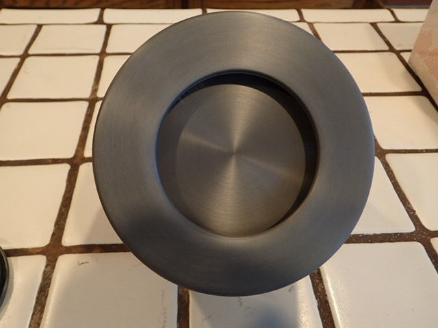

    There are 1 inch high heat exchange fins around the outside perimeter of the pan bottom.
    When placed on the stove the flames are directed up through the center hole in the bottom and out through the heat exchange fins surrounding it.

    Both the Fire Maple and my Primus Litech 1.5 liter kettles are made of hard annodized aluminum. They both have the same 6" diameter and the same lid hole size. The Fire Maple is 1 inch taller to accommodate the heat exchange fins and weighs 103 grams (3.6 oz) more for the same reason. 308 grams (10.8 oz) for the Fire Maple and 205 (7.2 oz) for the Primus Litech.
    My testing confirms the Fire Maple claim of 30% increased efficiency. It took 10.5 minutes to boil a liter of water in the Primus but only 7 minutes to boil a liter in the Fire Maple on a French Vesta stove under similar conditions.

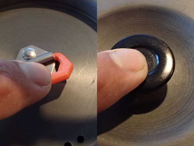

    With regards to the lids, I prefer the Primus over the Fire Maple not just for aesthetic reasons but for practical reasons as well.
    Both the Fire Maple and the Primus LiTech suffer the same problem. The lids don't click into the kettle they just sit there. So, when you tilt the kettles enough to drain them completely the lids fall off. That means you have to hold them in place with a finger of your other hand while pouring. This is more difficult with the Fire Maple tab (left) since it's rather small and flops around. No so with the Primus Knob (right) which gives you a large flat area to rest your finger on.
