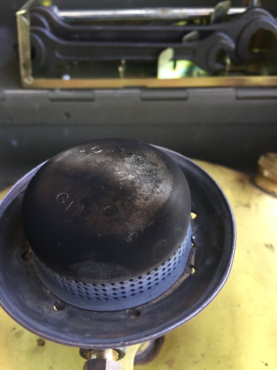

    My GENIOL stove's burner cup has dented.
    Please let me know which Optimus stove's burner cup can use?
    Thanks,
  16. snwcmpr
    snwcmpr Subscriber
    13,494
    I would think Geniol caps would be available from some seller in Germany.

  19. YOSH
    YOSH Subscriber
    Jan 26, 2016
    47
    Japan
    @teckguy_58
    Hi,
    Thank you for your helps!
    I got 205 inner and outer cap the bay.
    Thanks again,
    Yosh
