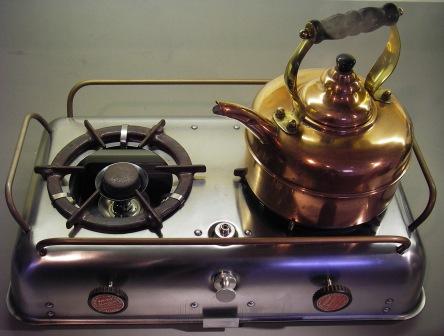

    I was a bit surprised to find one of these in the UK, but the seller was from the South coast so I'm assuming it came ashore with the rest of the boat in a refit of a Yankee Clipper or some such.
    Here it is fettled, kettle just about to boil
    As I said that was after the strip-down and some servicing of parts, of which there were quite a few
    An unexpected snag was that the non-return valve was inset in a recess at the bottom of the pump tube. The NRV had to come out because it wasn't working
    My regular, Primus, NRV removal tool (bottom in this pic) had a head diameter just a bit too big to fit into that recess, so I had to make up a 'special' to fit
    The pump washer was a nasty plastic gizmo that didn't work reliably
    Unfortunately, I laid out my stock of different sized proper pump washers (from Sefa of course) and though I thought the largest (Coleman-sized) might have worked, it was just that bit too big, so the plastic washer had to go back for the time being
    The control knobs proudly proclaim the stove's American manufacture ...
    ... but the reverse told a different tale about the origin of the burners at least
    The underside of the stove, spill tray removed
    One of the burners, intended for methylated spirits/alcohol only
    Under the silent burner inner and outer caps is a disc air-valve to adjust the mixture. Once lit, I tinkered with the setting to get a blue flame. It involved setting the valve, trying it out, letting it cool and trying another setting. Takes longer to write than it did to do
    Inner cap
    The advantage of having meths in the tank was that it could be pressurised, then each control valve opened to trickle some fuel into the priming cups
    Though I gave the tank a rinse, I wasn't too thorough I guess and a couple more tankfuls should see the orange tint to the flame disappear, I reckon. One of these shots shows a tracer formed by speck of incandescent carbon, you'll notice
    A leaflet on the model from the CCS Ref Library
    Leaflet

    In my experience, the burners can be adjusted for proper mix whilst burning. Use a large pair of grips and grasp the outer rim of the burner. That outer part will move and allow you to "dial-in" the proper mix while the burning continues.
    Early versions of the 205-32A came equipped with Svea 1915 kero burners that were converted to spirits with a restrictor tube and an alcohol jet. The same procedure used on the Optimus 111T. Those early models can easily be converted for use with kerosene again by swapping out the jet and discarding the restrictor tube. One caution, though. The hotter flame of kerosene does not treat the arm tips of the porcelined grates well. The porcelin can heat chip and bubble on the first 1/2" or so of the protruding arms. Works super well otherwise.

    Doc (Mark) had told me about that dodge with the pipe grips and I prepared for doing that by dousing the burner heads in releasing oil in advance but when it came down to it I couldn't get the darned things to turn and didn't want to force them and gnarl up the rims. Consequently, I went for the slower method.

    John, that's a very nice Homestrand you have there, and well done on the fettling!! As to adjusting the air/fuel mixture, to my knowledge, there are three different burners, and the two ways to adjust them are not interchangeable. If you have the disk inside the burner, as your stove does, John, I really don't believe you can turn the entire burner head to adjust it. If you can turn the burner head, that is a slightly different burner, and is easier to adjust. I have both of those types, plus a third time that has burners that cannot be adjusted, at all, and have, instead, a mushroom cap which sets on top of the inner cap, and under the outer cap. This third type burns just fine, without adjustment. At least, that's my personal experience. Others may have differing mileage. For what it's worth... Congrats on getting your Homestrand, John, and also for tipping me off to the "Made In Sweden" BEHIND the regulating wheel!! :shock: :shock: I'm going to check all of my different Homestrand stoves, to see if they have that same cool stamping behind the their wheels!! Very nice bit of information! Thanks!! :clap: :clap: Take care, and God Bless!
