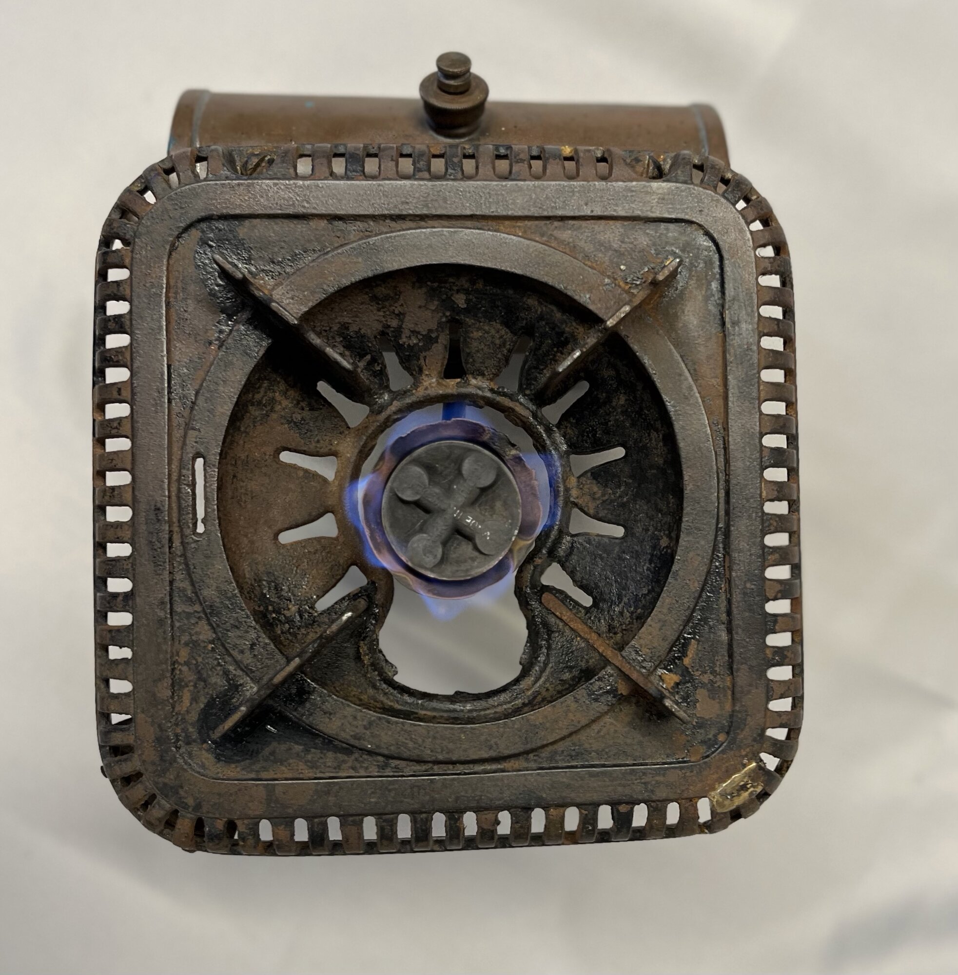

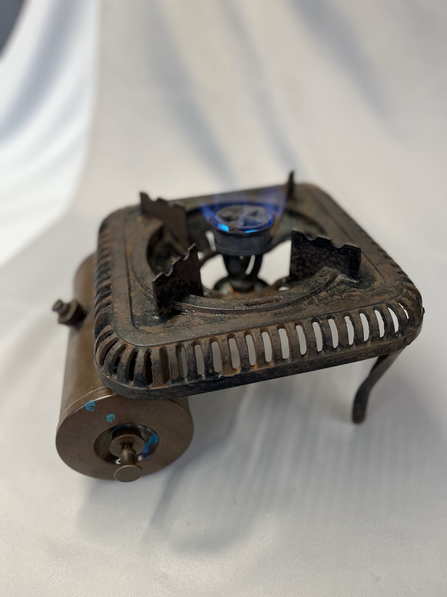

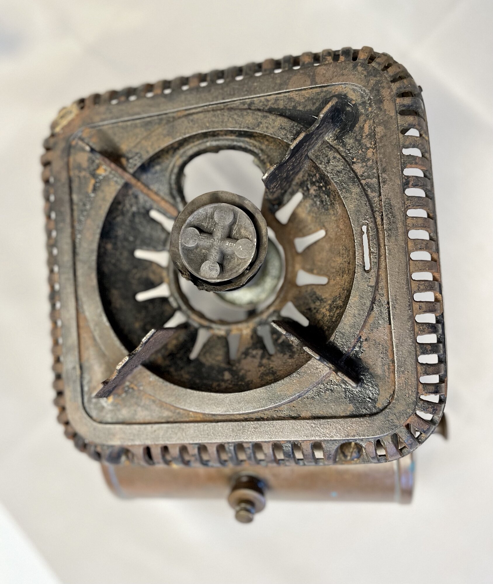

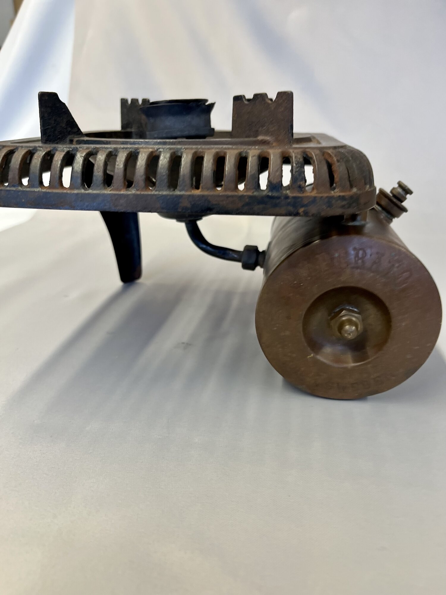

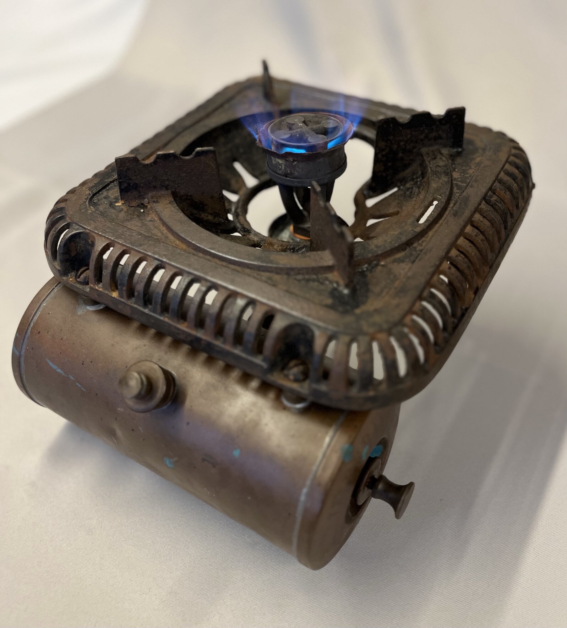

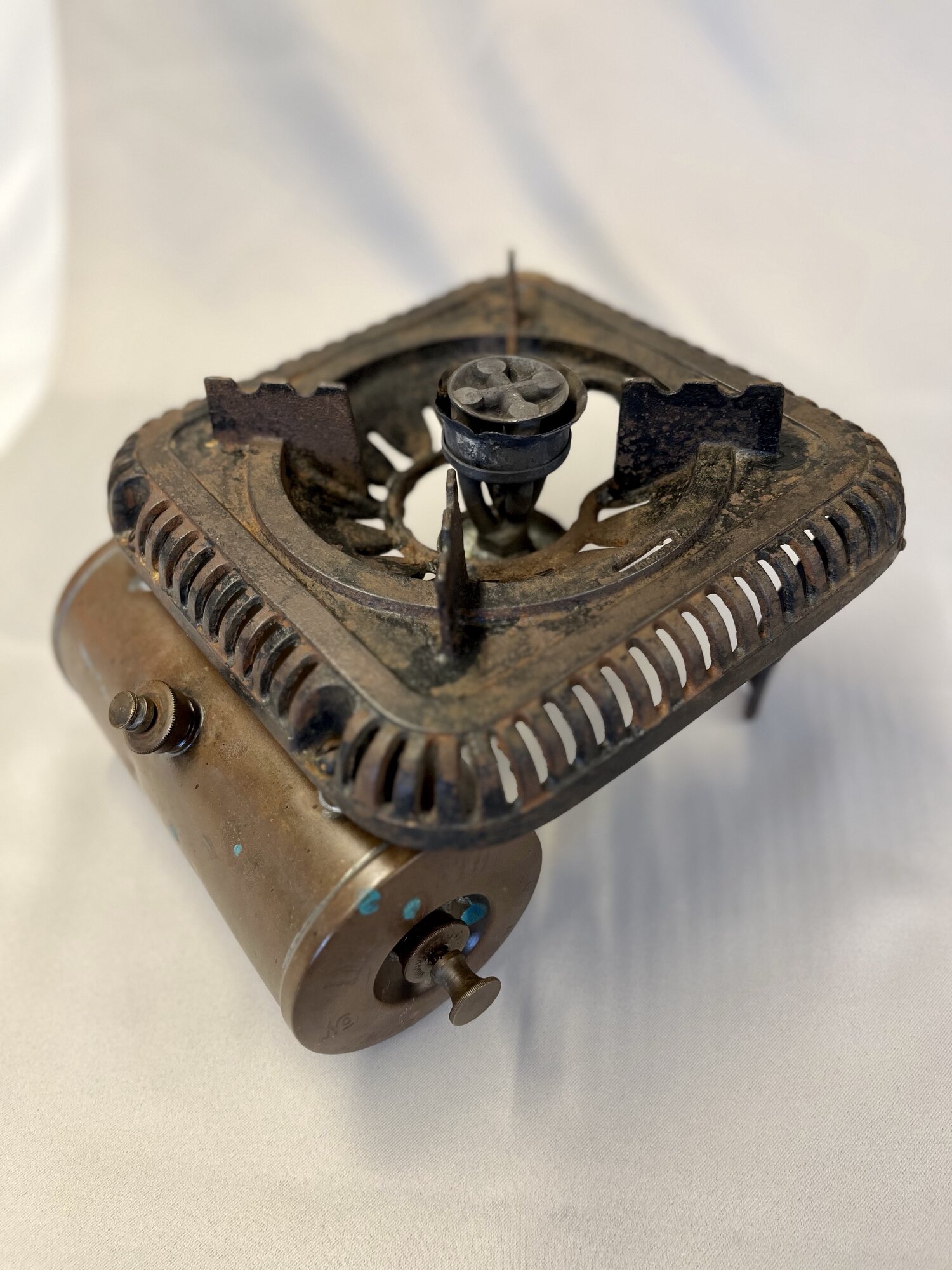

    Found this old stove a few days ago. May be from 1911, when it was first seen in K.F.Eriksson's 'Svecia' catalogue.
    Without spiritcup and missing one leg.
    The burner is from a Radius, I assume the original is a Svecia? On the tank it says No.1 so it originally had a roarburner.
    Out of respect for its patina and age, I have only washed and cleaned it, lubricated and changed the gaskets. Completed it with an old spiritcup with the right patina.

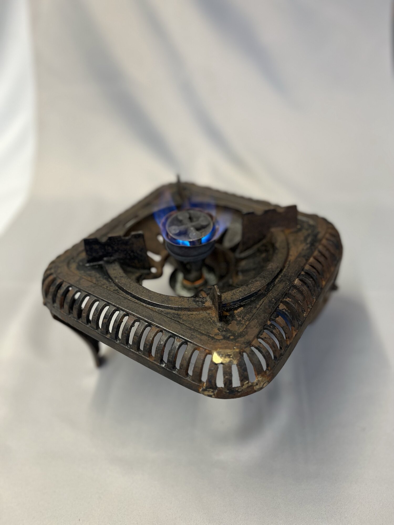

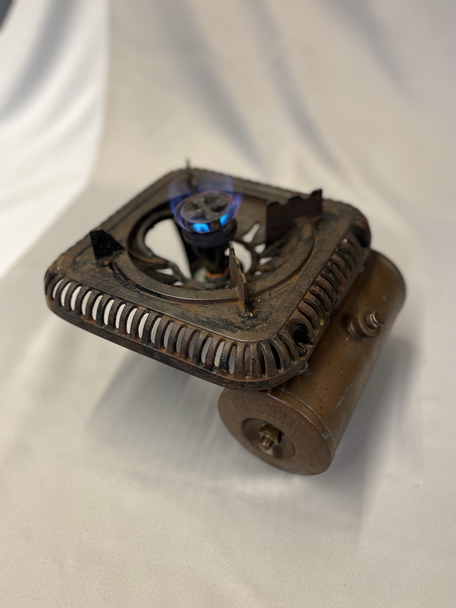

    I flushed the tank and filled in new kerosene, lubricated the pump gasket and cleaned the nozzle. Then I fired it up. At first it burned with a green flame, gradually it became a blue and pure flame.
    Someone has been happy with this and repaired it when one leg broke.

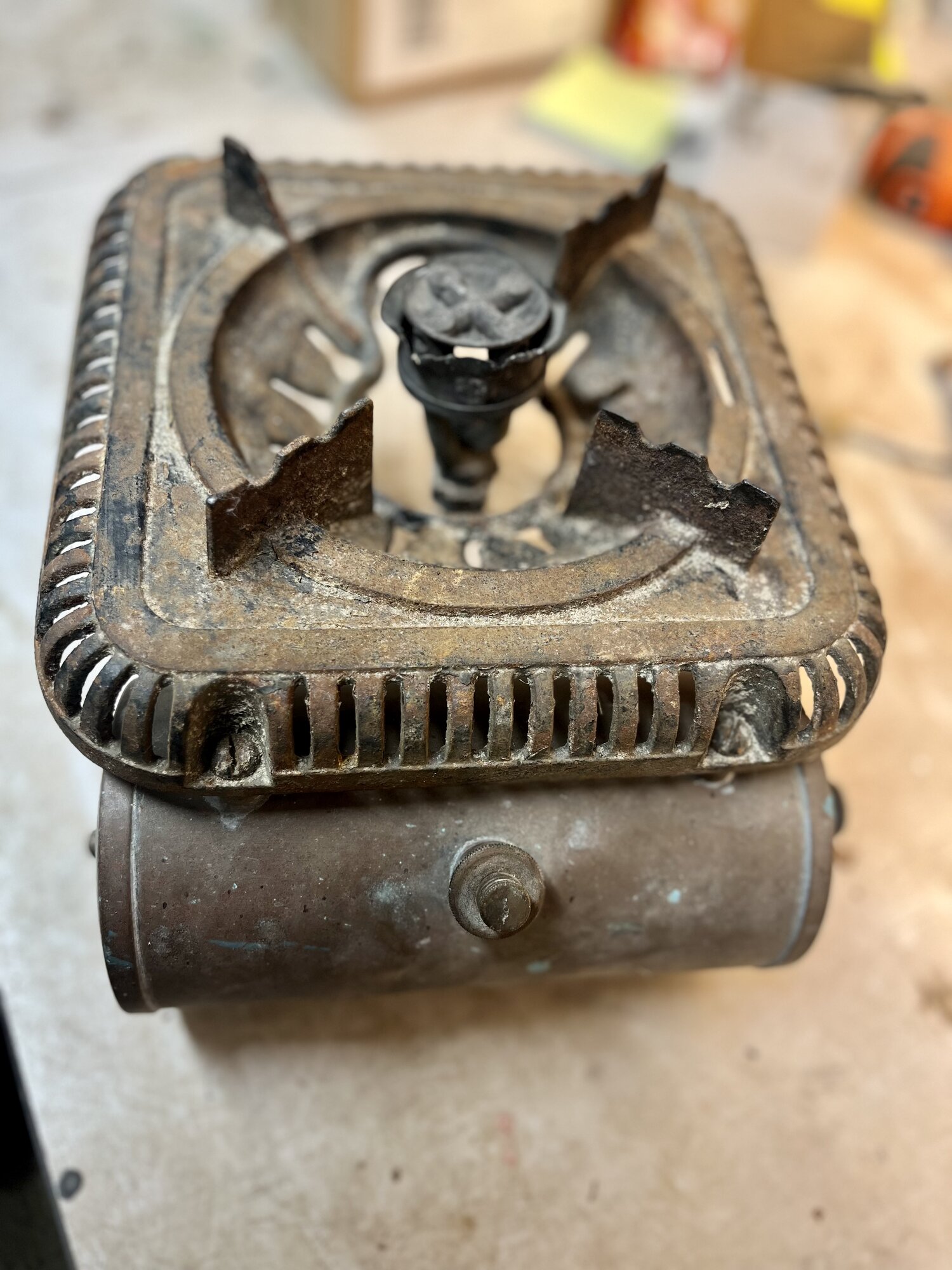

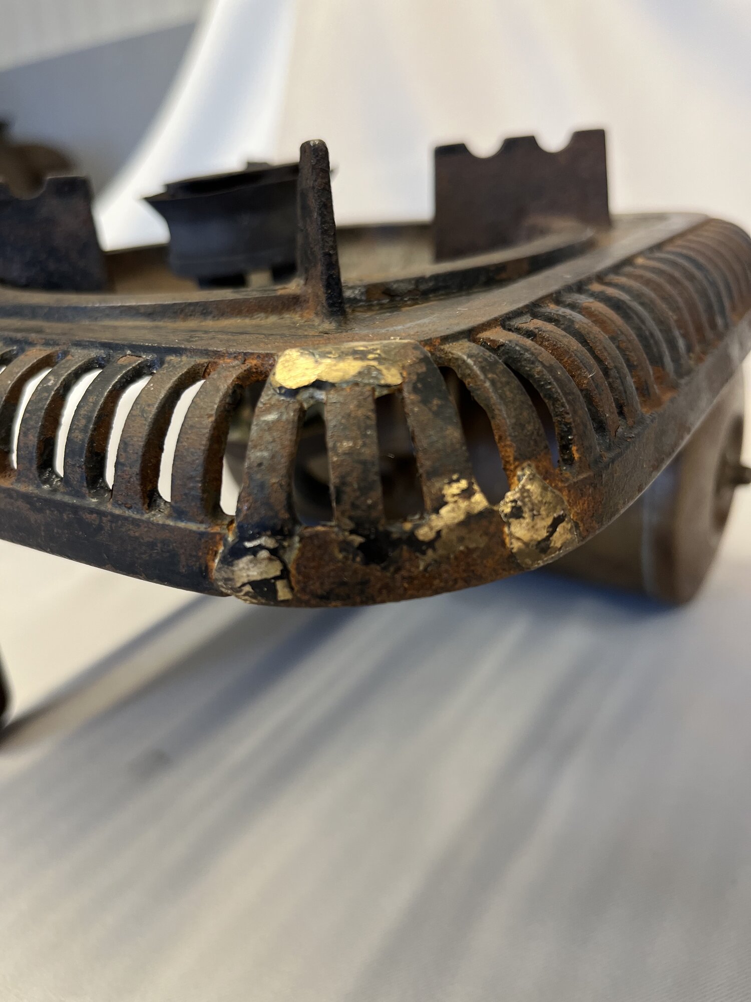

    This is how it looked when I found it
