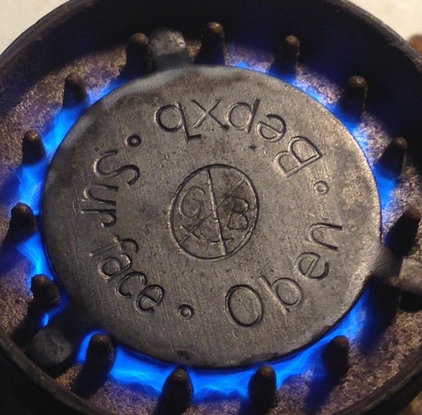

    In the last several years I have been interested in these Juwel # 6 stoves.Of all that ive seen in that time only a few had trivets or burner plates and I think maybe one or two had had both. As i think back im not sure if any had trivet,burner plate and the original box.This one has all that plus the instruction papers. The burners plates came in 2 styles,cast iron with 3 ribs and the three eared type. I believe this three eared type came later then the cast iron type.

    One more note,this trivet while it looks the same as other original Juwel trivets is slightly smaller then then box then other ones I have.The bigger ones don't fit in this.

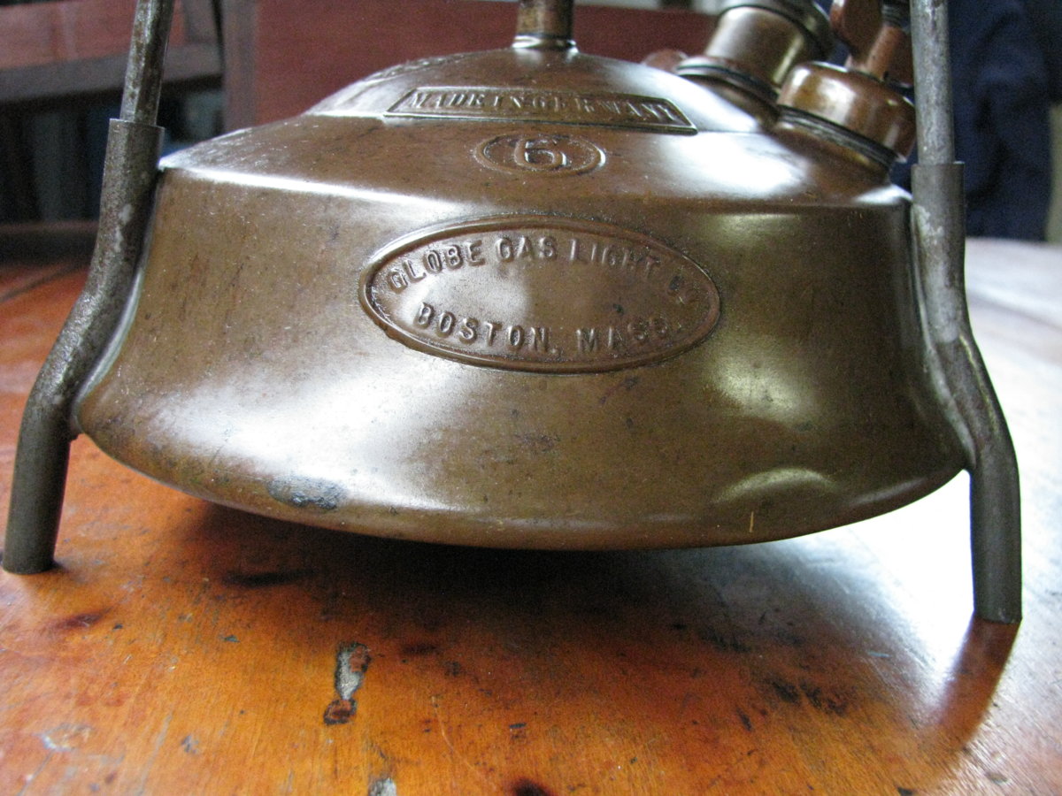

    Sizzler as I look at the ads in old boating magazines these Juwel 6 stoves were from 1907 to somewhere in the early or mid teens.My guess is the start of WWl may have something to do with that.By the 1920s Juwel has no model 6 in there ads.
    One more note,these stoves are mostly found in the the north east USA as the distributors were in Boston and New York

    Very fine Doug. A question: the flame plate clearly doesn’t sit on those burner bowl ‘spikes’ and evidently hasn’t the three radial ribs of the other type of flame plate to distance it from the bowl fuel vapour entrance hole, so what prevents it from covering the hole?
    Come to think of it, I’ve seen Juwel examples in the Gallery with the type of flame plate with the three ribs showing the ribs uppermost, which seems counter-intuitive if they’re intended as spacers. Same question would then apply, how come the plate doesn’t block the hole?
    You’ll gather I’ve not yet laid my hands on a Juwel burner of this type - fuel tank yes, absent the burner.

    @presscall at a guess the surface that the three spreader plate tabs rest on is sloping downwards leaving the correct size gap for the flames to get through.
    @Doug L how loud is this stove? I'm wondering if the flamelets start at the edge of the plate like on a Coleman (say a 400) or there is a flame underneath as there would be on a P96.

    John the ears are curved down to allow a the blue to escape and yes it sits between the spikes of the burner bell` same as the other type.

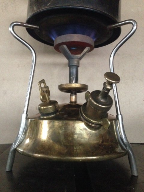

    Mine sounds more like a silent burner than roarer although it's a little louder than the typical silent. These are beautiful burners both in flame appearance and sound.
    There is only a 2 to 3mm clearance between the bottom of the burner plate and the burner itself and there is about a 12mm center hole so I believe the area under the plate is mixing air and fuel vapor similar to the inside of a silent cap.

    @Ray123 thanks for confirming that the Jewel 6 is like a silent burner. I'm surprised that this burner arrangement isn't much more common in that case. It seems much simpler and more robust than the normal silent arrangement with inner and outer caps.
