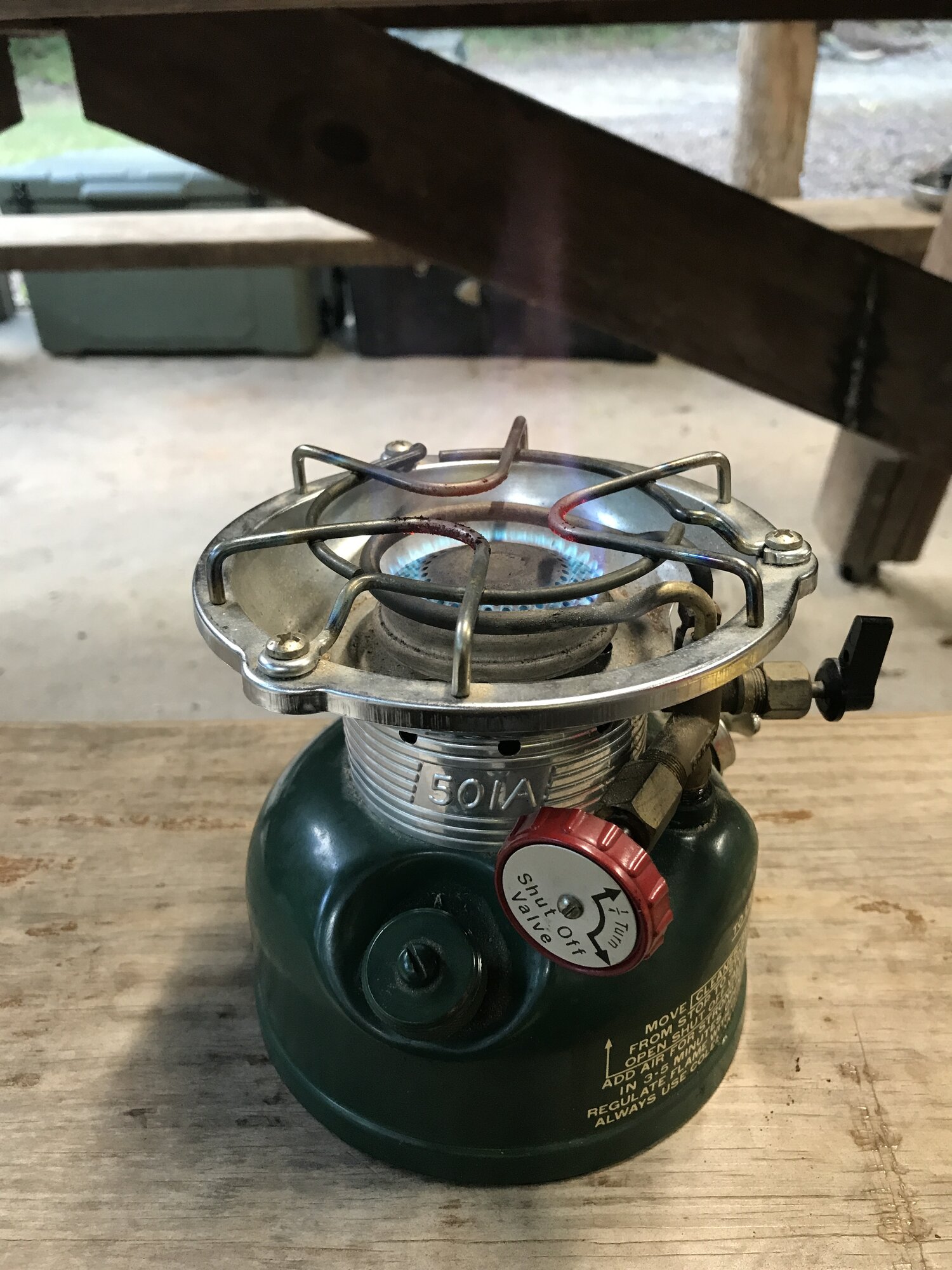

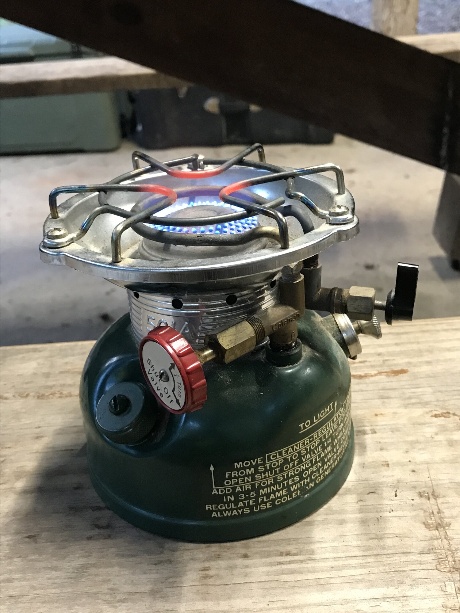

    Tricky stove to get to a clean run… 67772633815__B21DCFD7-3ACD-4D30-8CAE-285AE8B796ED.jpeg IMG_2879.jpeg

    Good on ya for lighting it up. Often people seems scared to death of these.

    @The Warrior , they have had issues of over heating the valves and running loose, they have also had an issue of the generator because of the way it wraps kind of around out from the burner and is not directly over the flame of then cooling to much and you lose the flame and you have a liquid build up in the bottom of the burner, and out of the air vent. Coleman had so many issues with them that once they had the 502 developed they discontinued the 501.. now with all of that said they are a prize for the collector, because of the issue and because of the limited number that were produced… If my understanding is correct Coleman had a re-call on these.

    Coleman wanted everybody with a 501 to bring em into the dealers, they would hand you a new 502 and take a hammer to the 501.
    My understanding (just hearsay of course) was that the generators would fail and then there was no way to shut em off, since valve was on the downstream side of generator.
    I don't have the foggiest the difference betweeen the 501 an 501A, they changed a few things trying to fix their issues.

    They moved the shut-off valve on the 501A.

    Love the flame patterns on the 501/501As.

    @Remus1956 , if you look at the pictures in this article, and look at the pictures of my stove you can see the change in the valve, the 501 had a valve that looked more like the pricker control handle on a stove, while on the 501A of mine you can see the black plastic handle making it easier to grasp and turn off.

    The date on the fount for this stove is 05/62.
