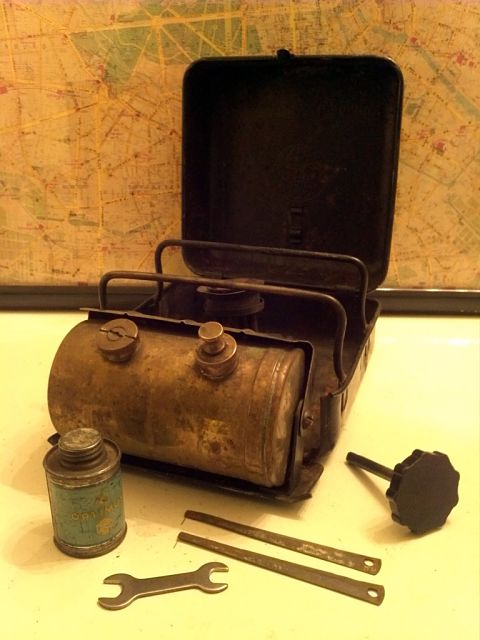

    Hi folks!
    Here's an interesting stove I was lucky to pick up recently.
    I have not done a thing to it yet, but it's near the top of the fettle pile!
    Though filthy, it's unmolested and I expect this one will clean up very well.
    My other Optimus 11 is a bit battered, so I bought this one from Sweden to replace it, figuring I'd sell off the rougher stove. While waiting for it to arrive and fawning over the auction pictures, I noticed some very odd characteristics, leading me to think this stove is a bit more special than I'd anticipated. My suspicions were confirmed when it arrived.

    I propose that there's a third distinct generation of the Optimus 11, this transitional one.
    I believe the one featured in this post is a very late Optimus 11, among the very last of them produced, and somewhat of a missing link between the Optimus 11 and the subsequent 111. I also propose that this was the first appearance of the familiar Optimus 111 style case, still seen today with the Hiker +.

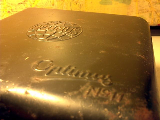

    One of my favorite parts of the second generation Optimus 11's is the globe logo.
    It's much nicer than the embossed 111 cases, and it's tough to capture it in a picture, but the globe stamping is actually convex! The downside of that fancy logo is that they don't stack well. See how it's domed and raised off of the case?
    On the featured transitional Optimus 11, the globe logo is stamped flat on the case, like on the embossed 111's.

    The featured 11's case is very similar to the early 111's.
    The most significant differences I've noticed are the model number embossing on the case, and the spirit cup retainer.
    Model embossing on Motoshi's early 111.
    Spirit cup retainer on Motoshi's early 111.

  2. Pinky
    Pinky Subscriber
    Mar 26, 2012
    320
    Oh! And here's a shot of the spirit cup retainer, clearly showing that this case is for an Optimus 11.

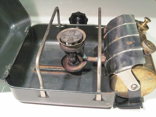

    Hello all!
    New owner of Optimus 11 stove joins in. I have not owned stoves like this before, just happpened to buy this stove from my colleque and started to find information from the internet and luckily found this great forum :p
    Thanks to Pinky, I can see that this nice stove is same kind of late transition model like his and dates in to the early 50's, I suppose? Wrench is different to Pinky's, but I suppose this older model could be the original one delivered with this model.
    This stove of mine has been stored over 30 years and has not been used within 40 years. Anyway, I am going to use it as soon as I can find some information how to do it...

    And it works! Couldn't wait any longer, drove to city to buy some purified gas (or what ever should I call it in English...), replaced tank lid's gasket with new, filled the tank, preheated with alcohol and ignited it :D/ And cooked a pot of fresh coffee for me and my wife, yes :!: Couldn't help to feel a childish enthusiasm with this and celebrated the moment by lightning my Savinelli Sienna ;)
    Pump is not working, I think I must replace the leather gasket, fortunately there are good instructions here for that, too. It was only +2 degrees Celsius outside while cooking and stove was working quite well - at least in my rookie opinion - without pressurizing. Cooked two liters of cold water and the flame was getting better all the time. Some pictures attached; first fires within 40 ears or so!
