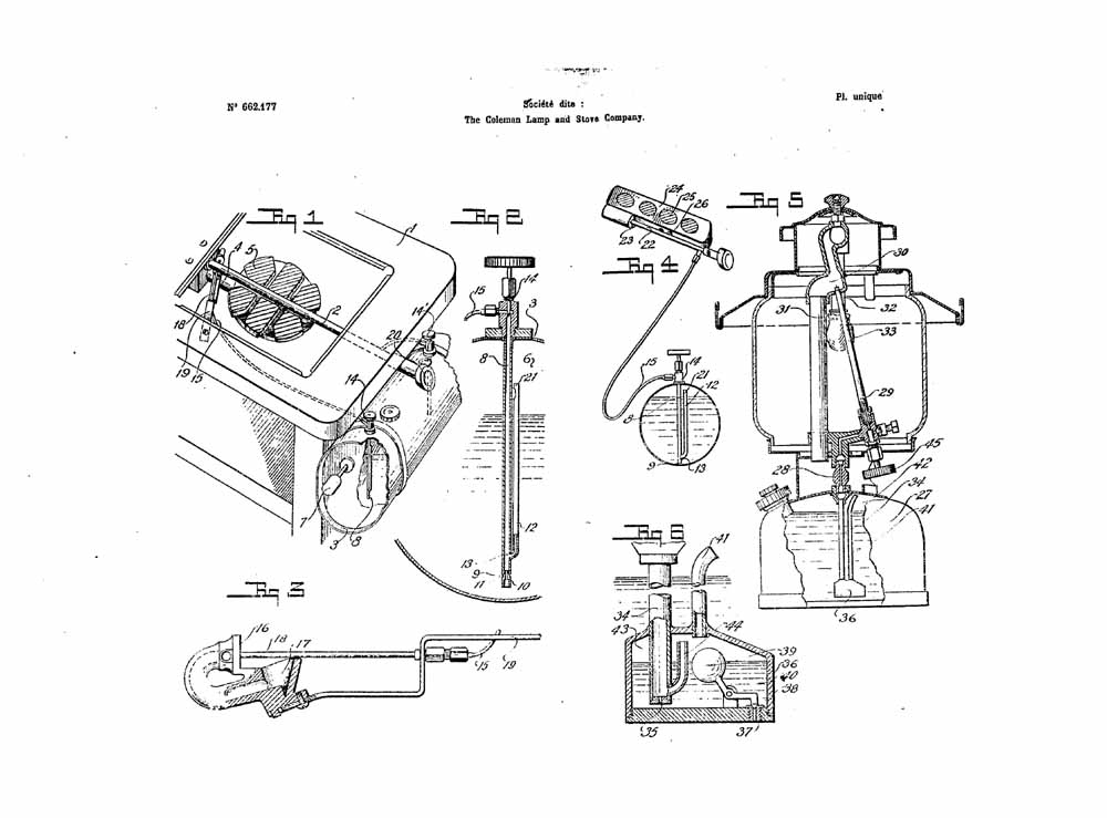

    I am familiar with that Coleman patent, as it is stamped on the tank on my Coleman/Jolp 800 stove.
    Here you can see that stove on CCS French Coleman (Jolp No.800) two burner stove
    That was my first stove restoration post on CCS in 2015.
    On the Coleman/Jolp stove, there is a three way control knob, but the principle is the same.
    /Conny
    Jolp Coleman logo.jpg Jolp stove valve control.jpg Coleman French patent FR 662 177.jpg
