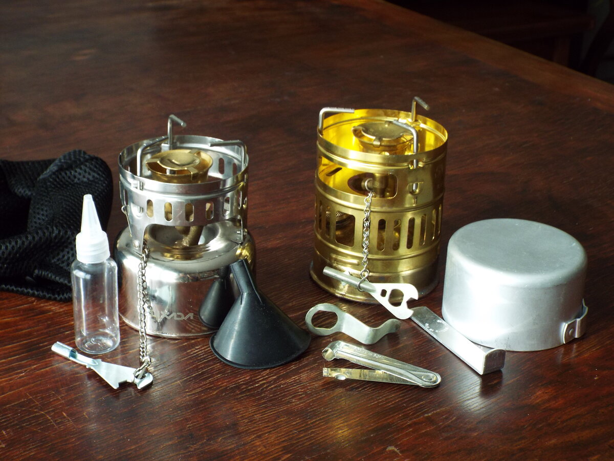

    This is LIXADA gasoline stove. I paid arround 40 euros.
    It would be a SVEA123 update. Both hasn't parts that can rust. SVEA123 is made of aluminum & brass. LIXADA is made of stainless steel & brass.
    In the LIXADA carton box I found the stove, a funnel, a key (multi tool), a spirit little bottle, and a mesh bag.
    In the SVEA123 carton box I found the stove, a key (multi tool), an aluminum pot, some handles and a prick tool.

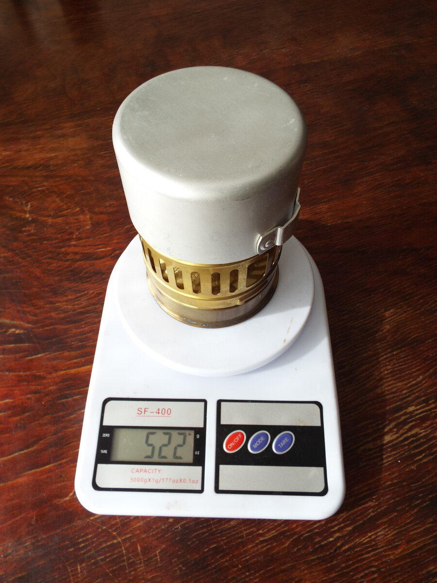

    The weight of the stove + key: Lixada is a little bit lighter than Svea.

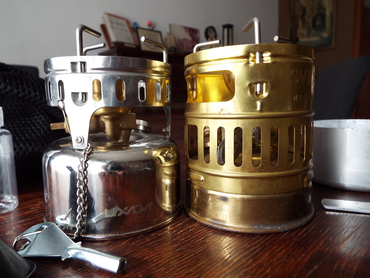

    Both are almost equal size.

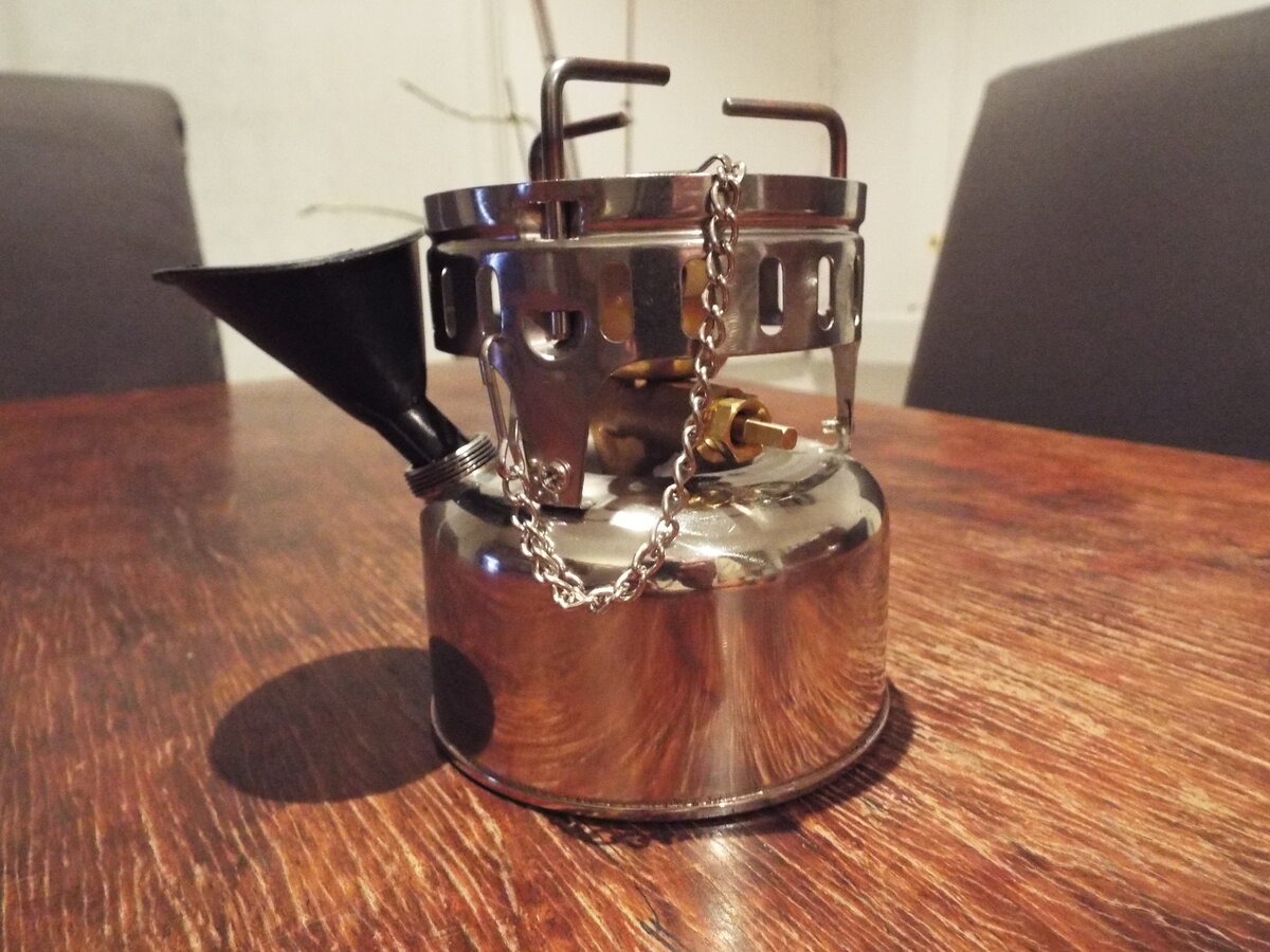

    Spirit cup is deep! Priming...
    Lixada fuel tank has more capacity than Svea. And Lixada is more powerful than Svea.
    :doh:It hasn't a safety valve!!! Even this I run full load fire and fuel tank became only "warm".

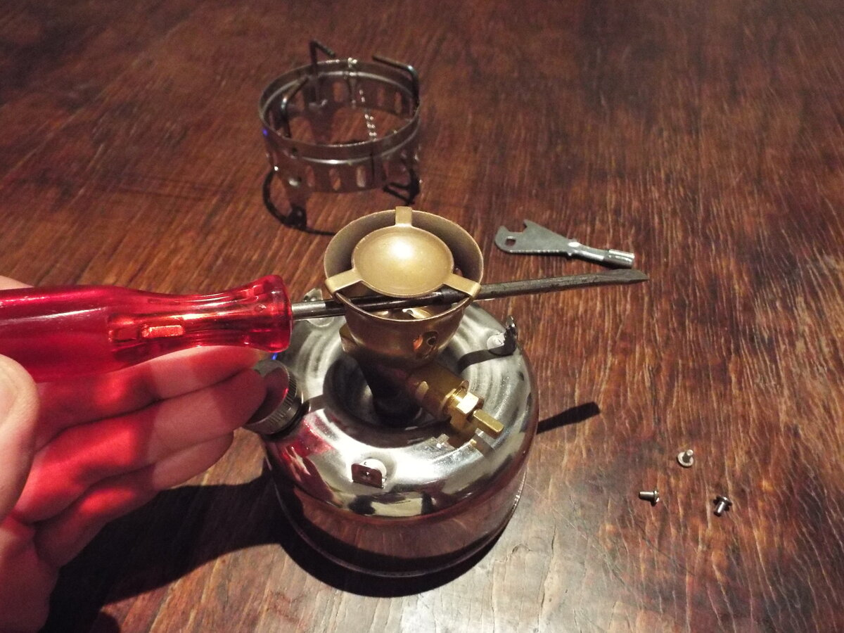

    I would like to know more about this stove. Very interesting indeed!

    A much more affordable option to a 123 and should be durable.
    The ‘overhang’ of the filler riser and cap beyond the fuel tank diameter seems quite substantial, but offers easy access at least.

    I unscrewed the windshield...
    I unscrewed the burner bell...
    I unscrewed the jet....
    Et Voilà! You can see the built-in jet pricker.

    Fill the tank is easy with the asymmetric or oblique funnel...
