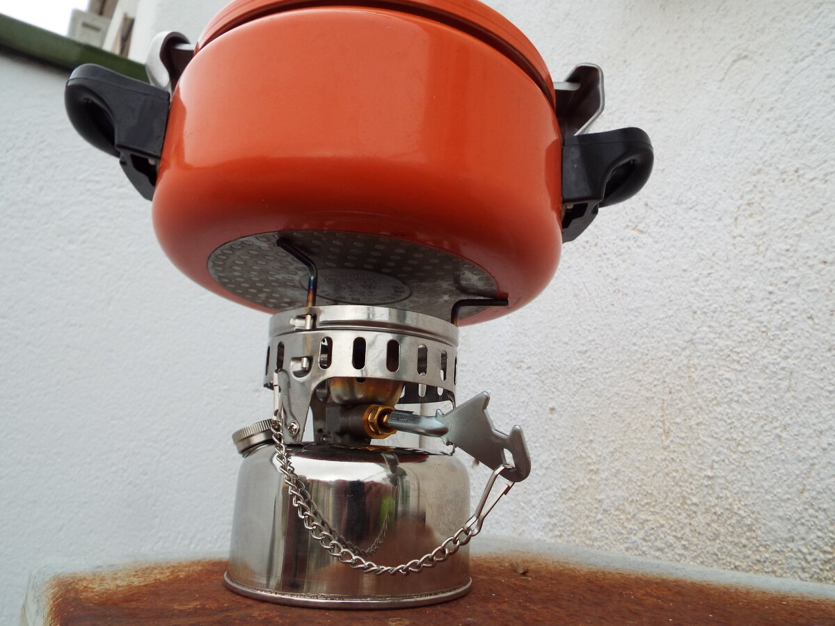

    This is a hard work for a little stove:
    At last, tank was hot. Arround 50ºC or 60ºC...

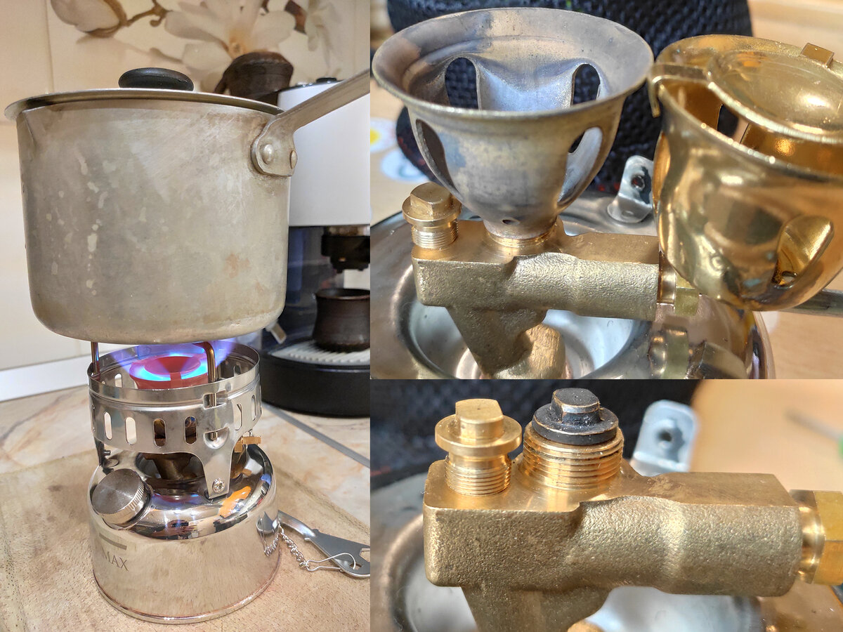

    Hi all. Have it stove.
    Made some winter tests today.
    BTW, jet & burner bell in Lixada and ussr PT-1/PT-2 (optimus 8r soviet clone) is identical! Think valve axel & jet pricker identical too. Burner visually is same/similar to ussr PT-2 stove
