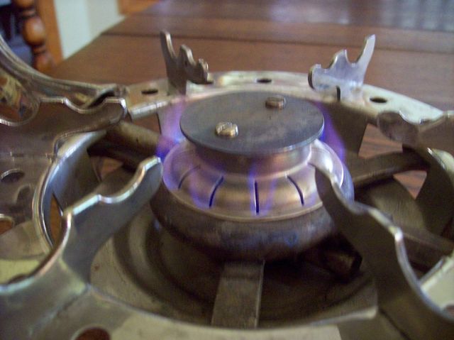

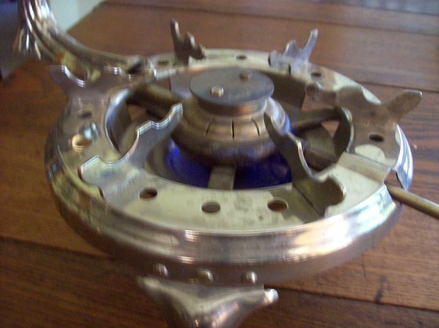

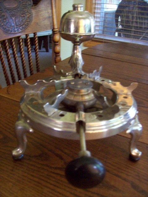

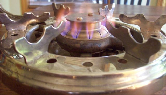

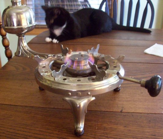

    Hi, I had picked this stove up at an antique mall a few days ago. The chrome is still very nice. I really havent done anything yet to the stove but light it. You have to pre heat the burner by opening the valve a couple of seconds to have a bit of fuel flow into the lower portion under the burner, (similar to any of the stove that need a pre-heat). I waited untill the flame died down, then I opened the valve and lit the burner. (You can hear the fuel moving from the tank into the lower portion of the burner). With the control knob you have very good control of the flame. It has quite a large fuel tank with a small cap and vent hole in the top. It is aprox 8"W x 16"L (tip of handle to fuel tank) and 5" tall, to the top of the fuel tank is 9 1/2".
    1244165282-Manning_Bowman_001_opt.jpg 1244165295-Manning_Bowman_002_opt.jpg 1244165312-Manning_Bowman_003_opt.jpg 1244165325-Manning_Bowman_004_opt.jpg 1244165346-Manning_Bowman_006_opt.jpg
    I'm not sure how to add the patent info but here is the link http://www.google.com/patents?id=kK...+stove&source=gbs_selected_pages&cad=0_1#PPA1,M1

    Awesome!!! I love it. Be careful not to polish too hard. It is nickle plated not chrome.(Chrome plating process was not common before 1928) Mike...

    Hi Very ornate and attractive stove. I would have thought that this was likely used in a (well-off) household to heat a chafing or warming dish, or make pancakes to table, rather than intended for camping.
    Seems to operate well and produce quite a powerful flame compared to domestic alcohol stoves relying on a wick.

    Hi and thanks for the kind words.
    Hi Flivver, Thanks for the tip, I dont think I would polish it, it is in very decent shape, maybe just a soap and water.
    Hi Kerophile, yes I agree with you, I wouldnt belive that this stove would be taken camping. But might be fun to take car camping though just for fun. Actually my wife really likes it and wants to use it in her antique store for her 3rd Anniversary Brouhaha to keep the food that she is planning to serve warm.

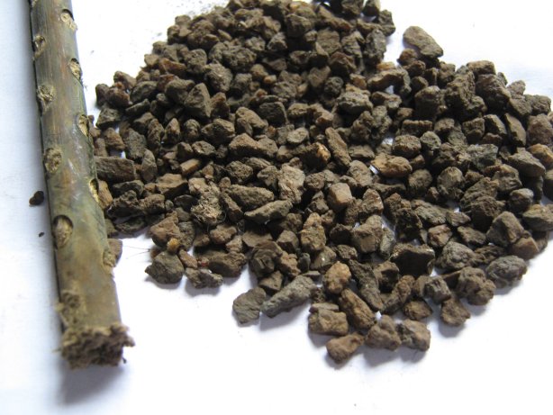

    I just wanted to post this pic of something very interesting I found inside my #70 stove. These "rocks"
    came for inside the fuel tube - labeled "H" on the patent diagram - and must have been in the circular
    section of fuel tube "H" as the long cotton filter
    part ( on left in pic) occupied the long straight section of part "H" .
    Rick_b if you ever fettle your gorgeous stove and take it apart , could you let us know if your stove has these same "mini-lava" rocks inside ? BTW be careful if you do as the tiny rocks will spill out of tube if turned up ; from exeperience I know this :) I almost lost my rocks as they spilled from the tube - I did not know they were there ! :shock: I had to sweep them up, luckily I saved them,but I suspect one could use crushed lava rocks to replace if necessary.
    Has anyone seen this before ? What are they for ?
