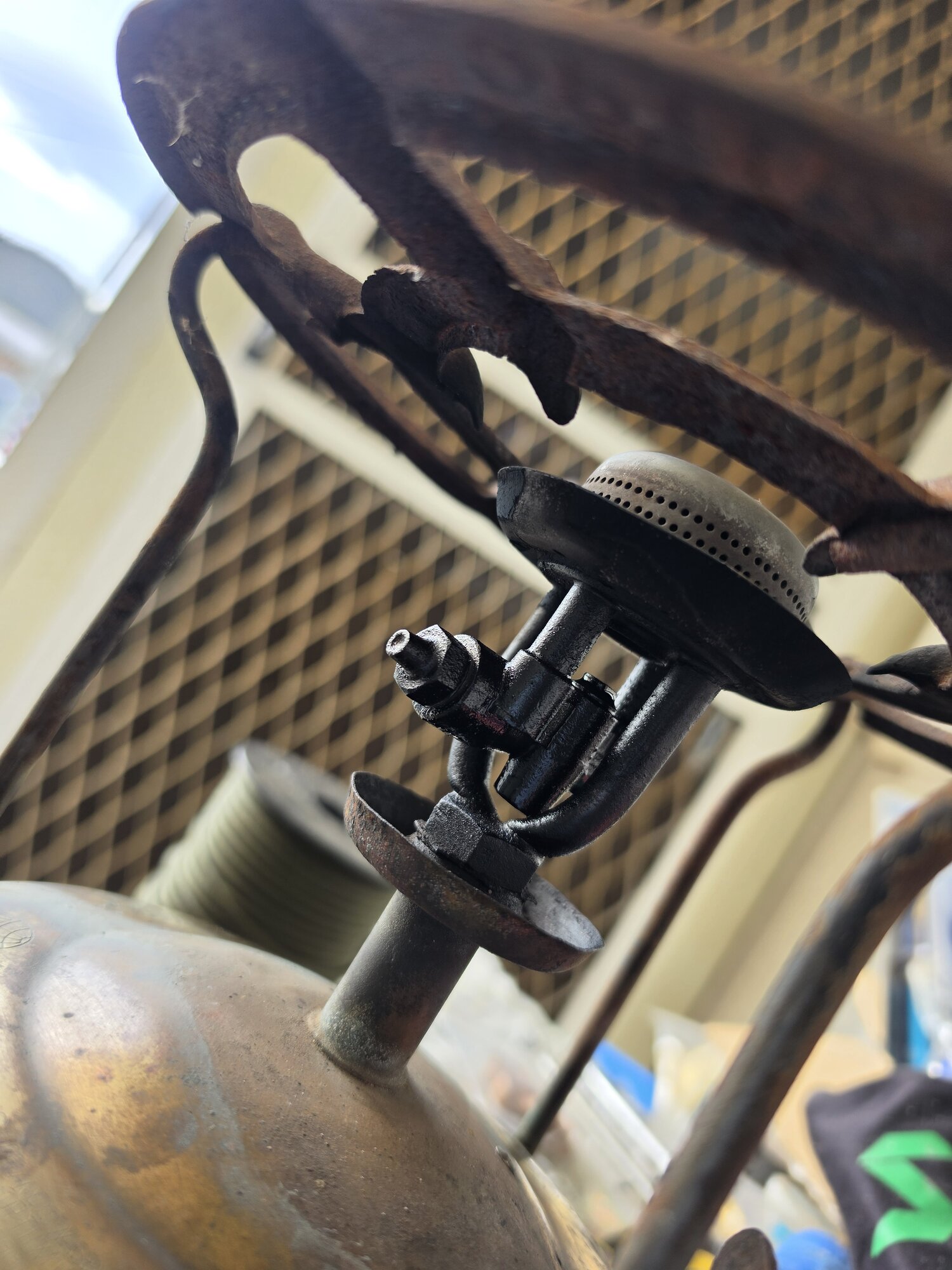

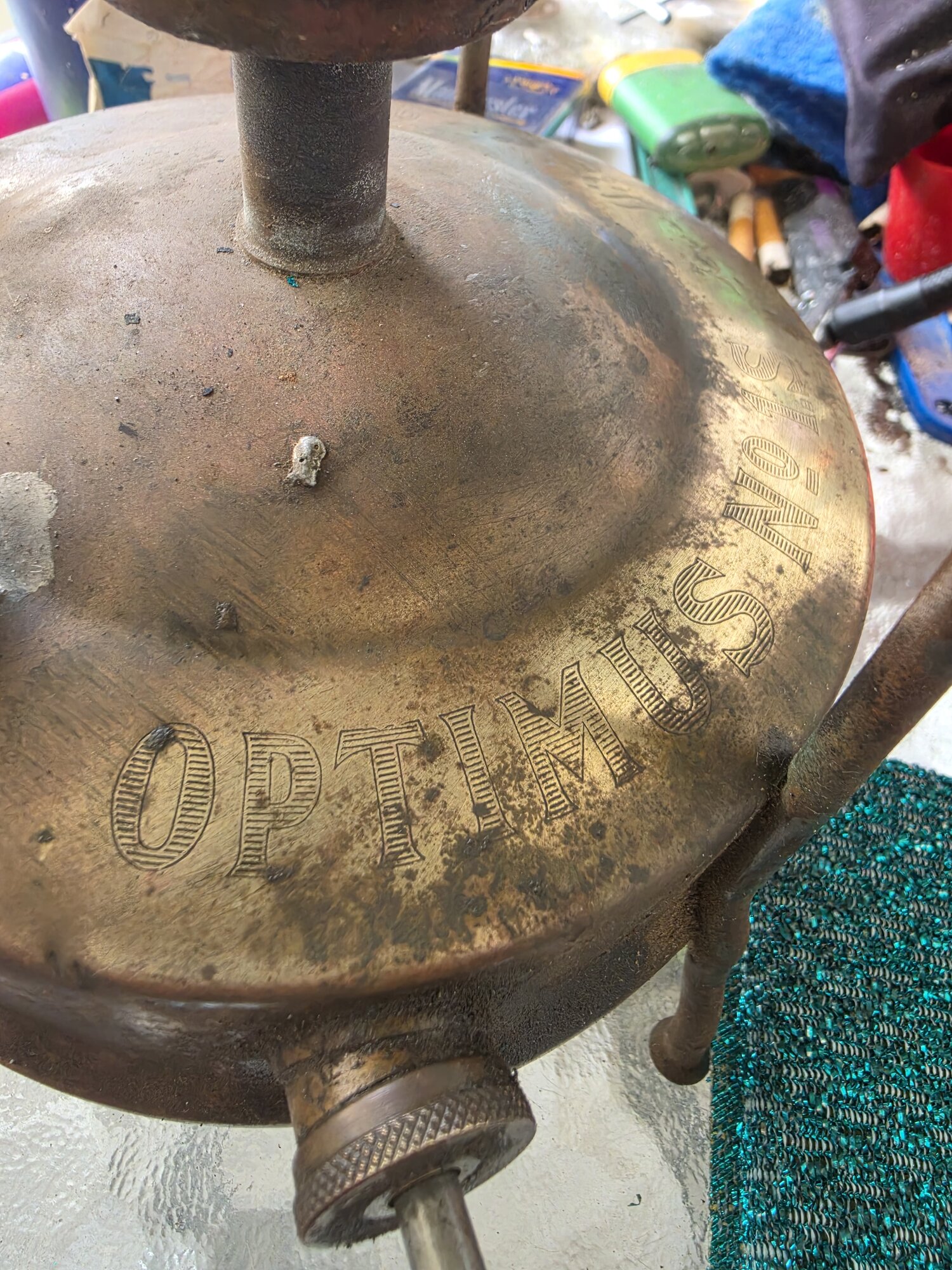

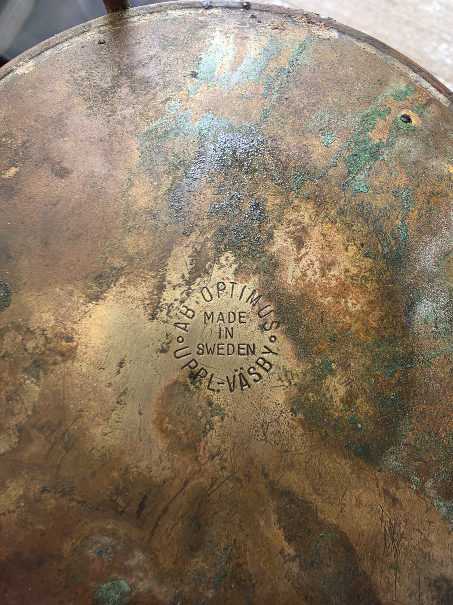

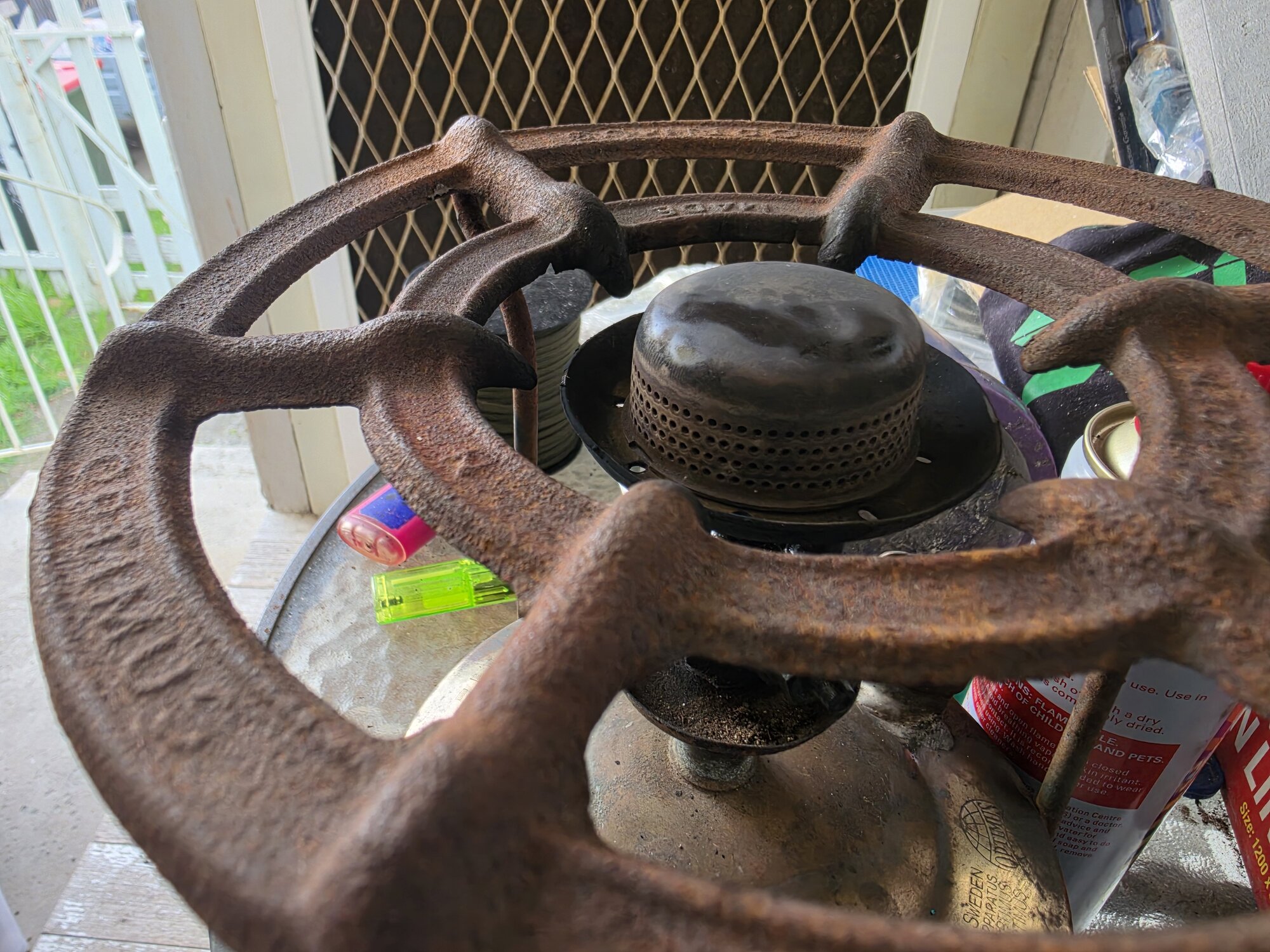

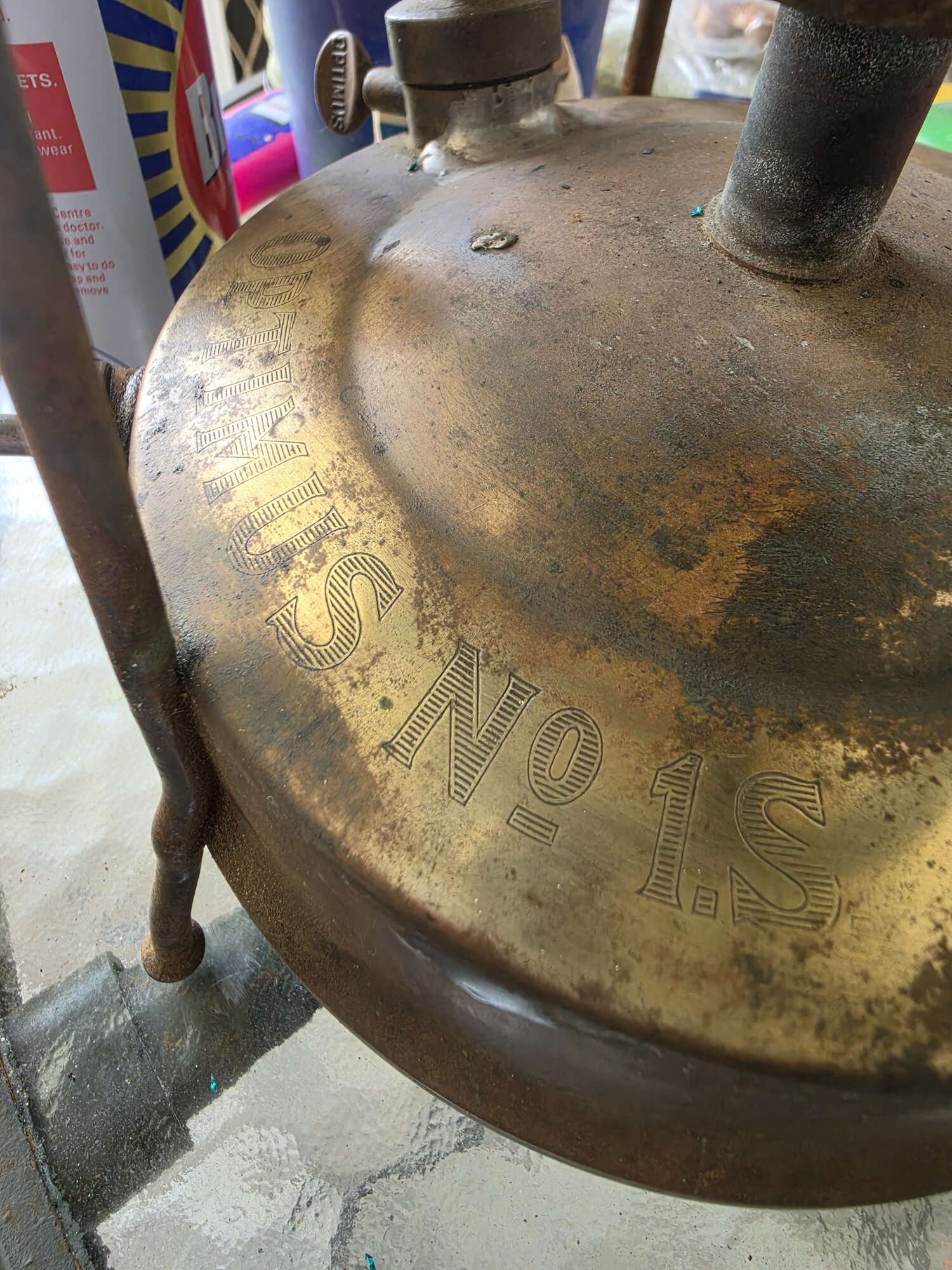

    Greetings I have just picked up a kero stove. The tank says OPTIMUS No 1S however looking at pics of others it seems a little different. The burner is what I think is called a silent burner which I thought only came with the No 1. The legs and feet are also attached. The trivet seems to be a pressed steel not cast. Anyway any assistance in advising me if this is the way it came from the factory or whether it has been mongoralised in the past would be most appreciated.
    I plan to clean it up and get it operational although that said it has compression on the pump so I tried to fire it up and it did however I think the non return valve is a little dodgy as kero came back up the pump under pressure. Oh well can't win them all.
    I have provided a few pics showing tank markings and burner.
    Cheers Rob

    You do indeed have an Optimus No: 1 s which most likely would have been equipped with a “roarer” burner, but has been exchanged (at purchaser request - or subsequently) to a “regulated silent burner”.
    Not “mongoralised”, but modified…
    Once you’ve replaced the seal under the tank lid, and the “pip” in the NRV (Non Return Valve) at the bottom of the pump tube, you will need find a method of operating the regulation of the burner too.
    As you appear to be in TAS @Tony Press may be able to guide you (I’m currently in NT)…

    Looking at the last photo, there is no spindle shaft protruding from the burner. It appears to be broken off or removed and the hole pluged.
    As it fired up, the burner isn't in the closed position so it will operate in an unregulated state. A rebuild of the burner will get it operational again.
    The stove should clean up nicely :thumbup:

    I just went down and looked again I must have had my blinkers on the first time because I totally missed it. However there is a companion mark on it. See pic.
  15. Tony Press
    10,856
    Ok! Definitely a Companion.
    TW Sands should have the parts you need for that burner (control spindle and wheel; outer cap).

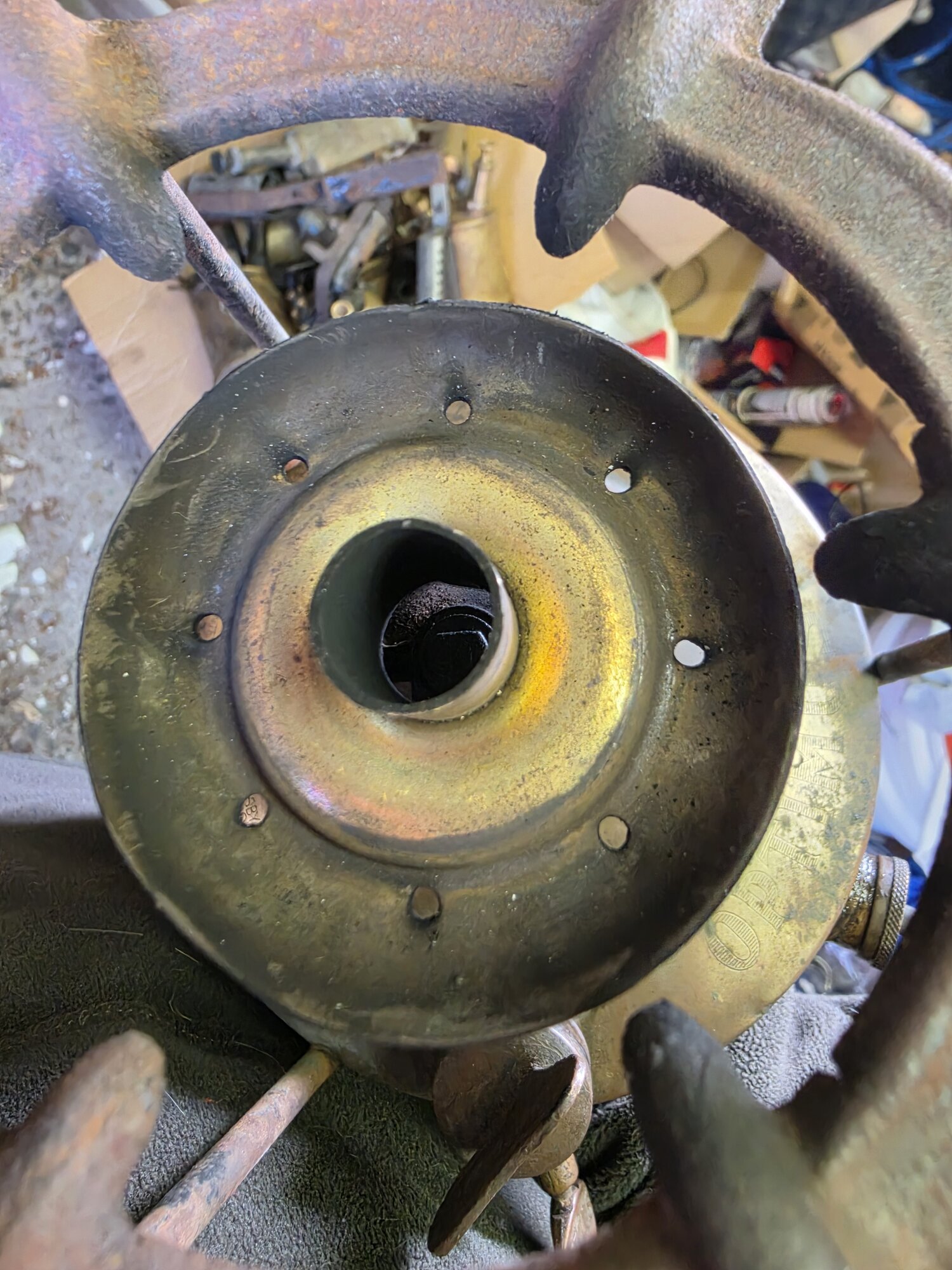

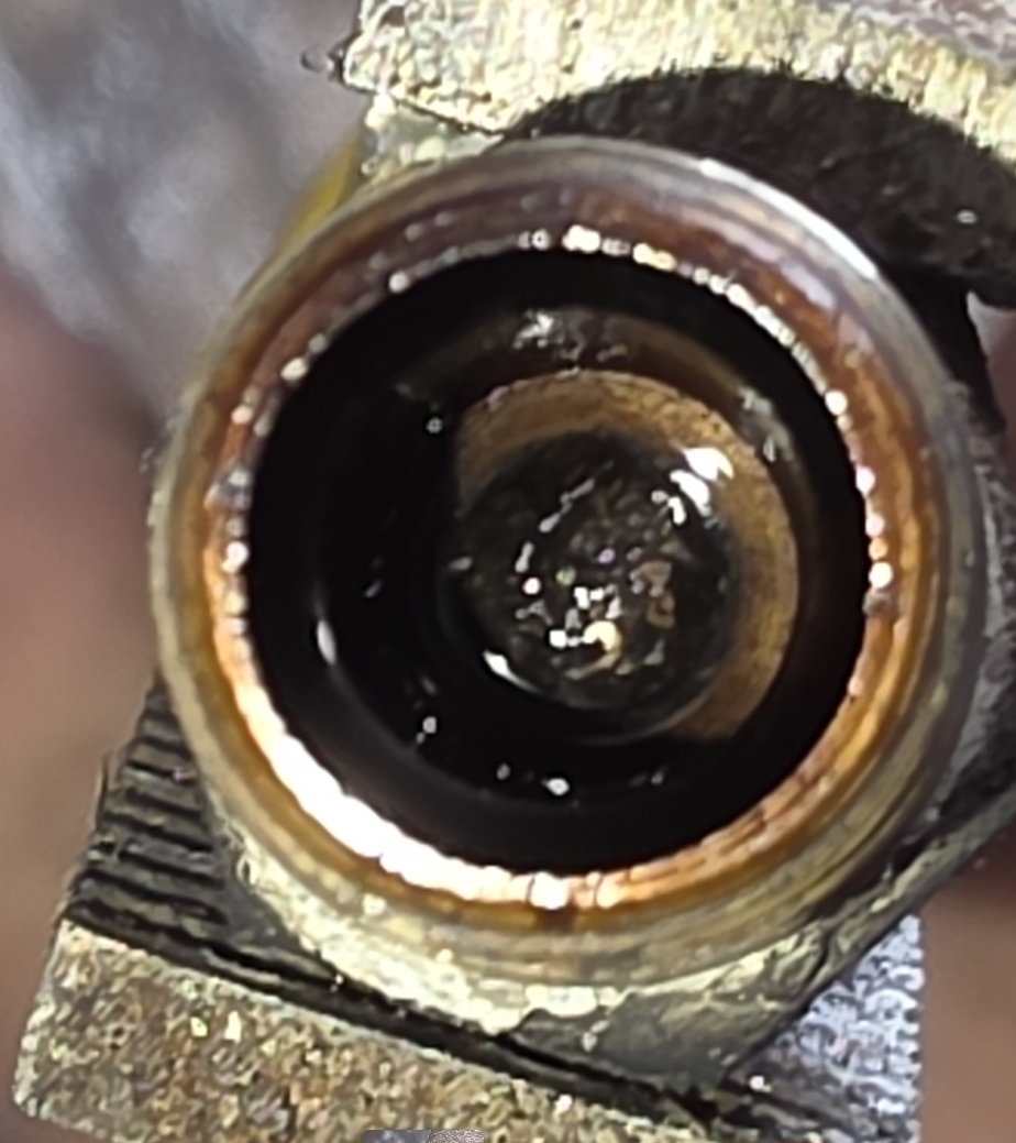

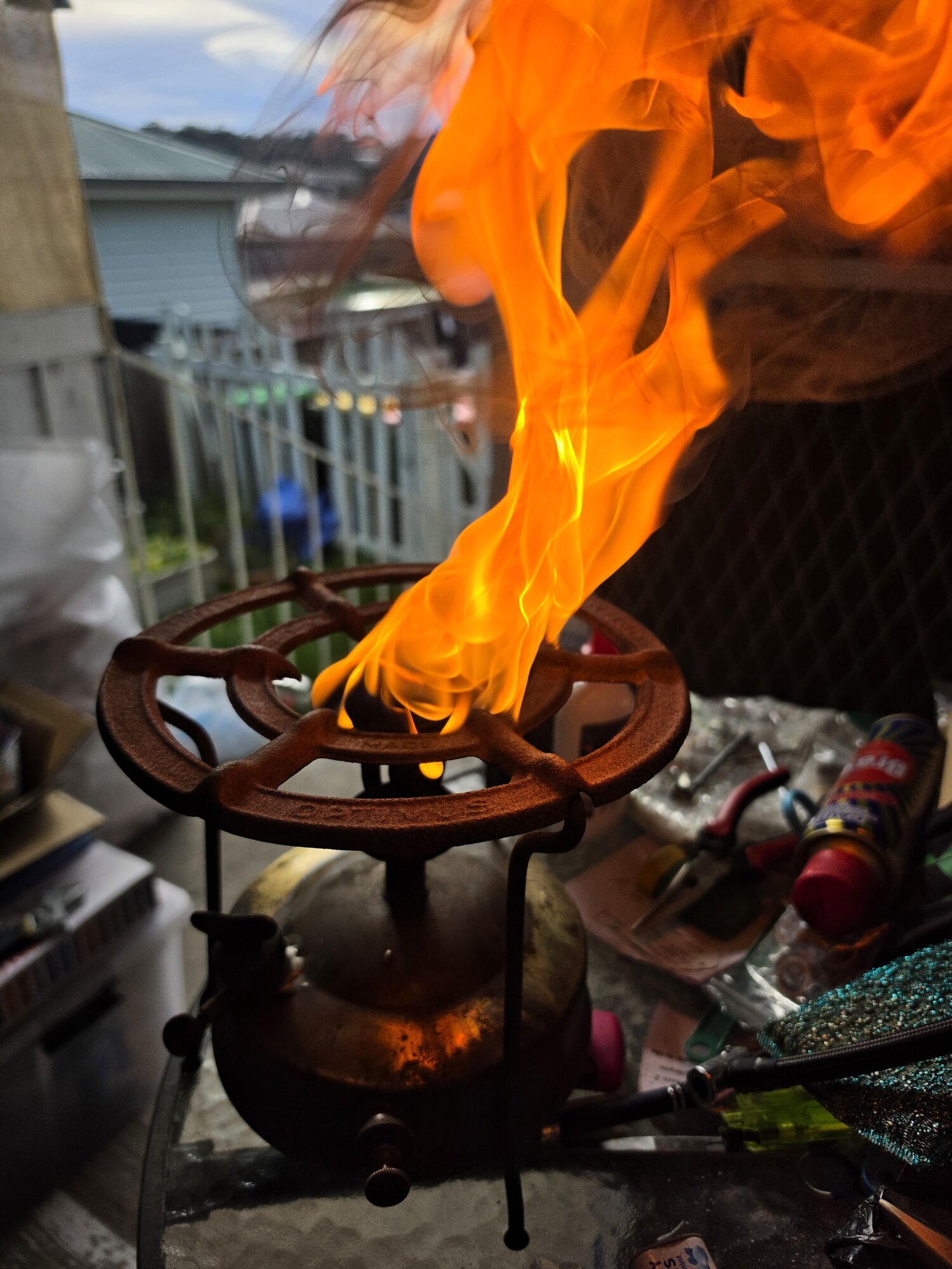

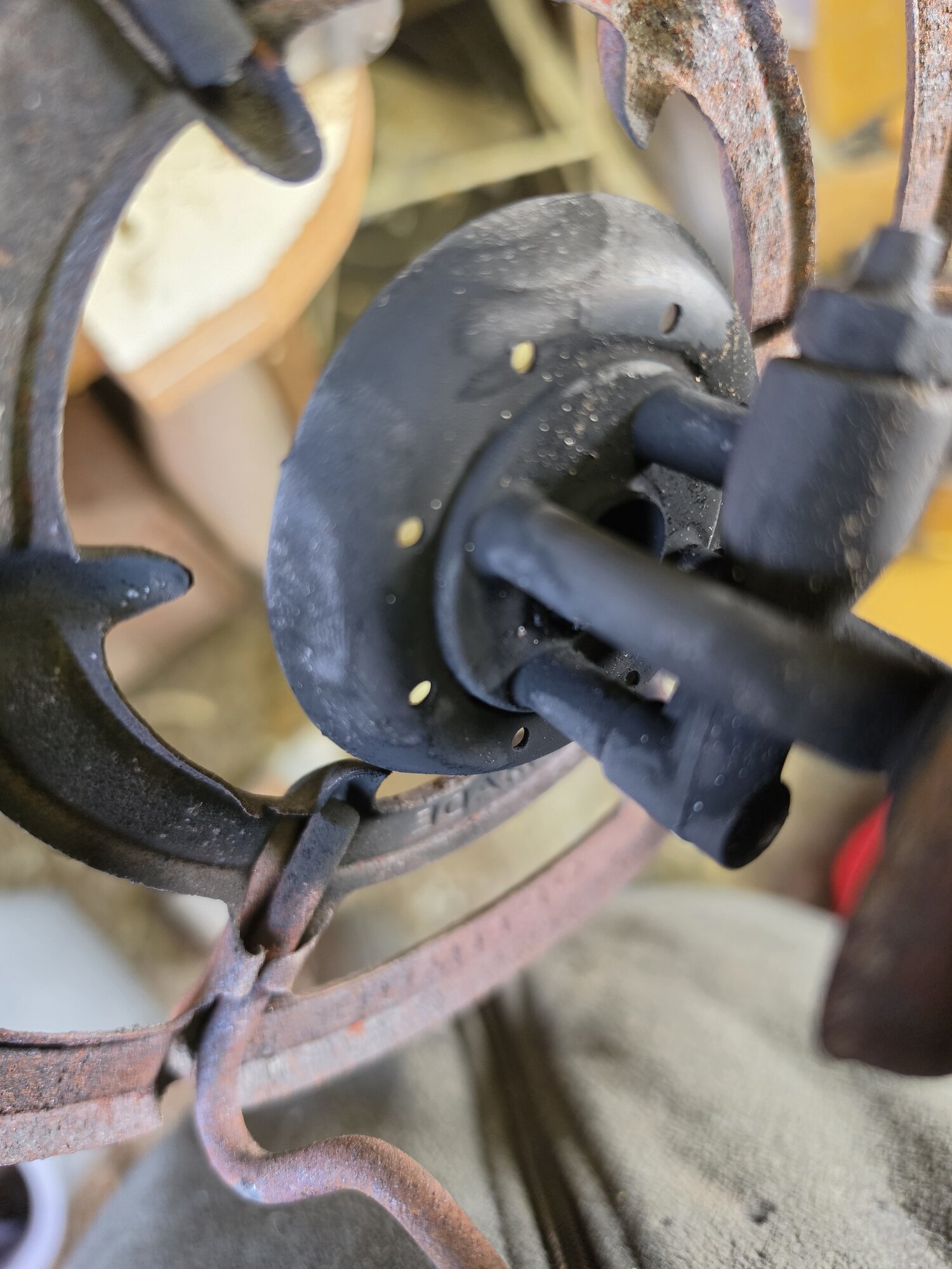

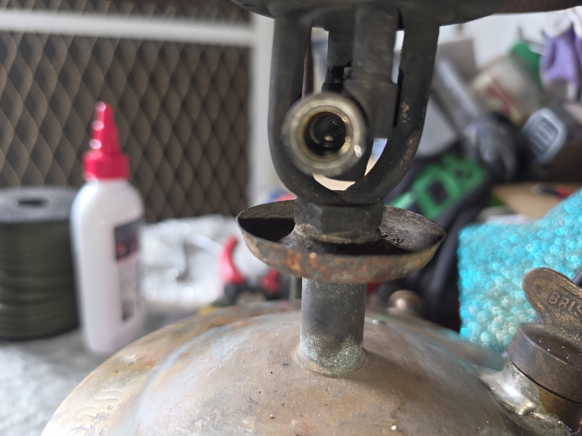

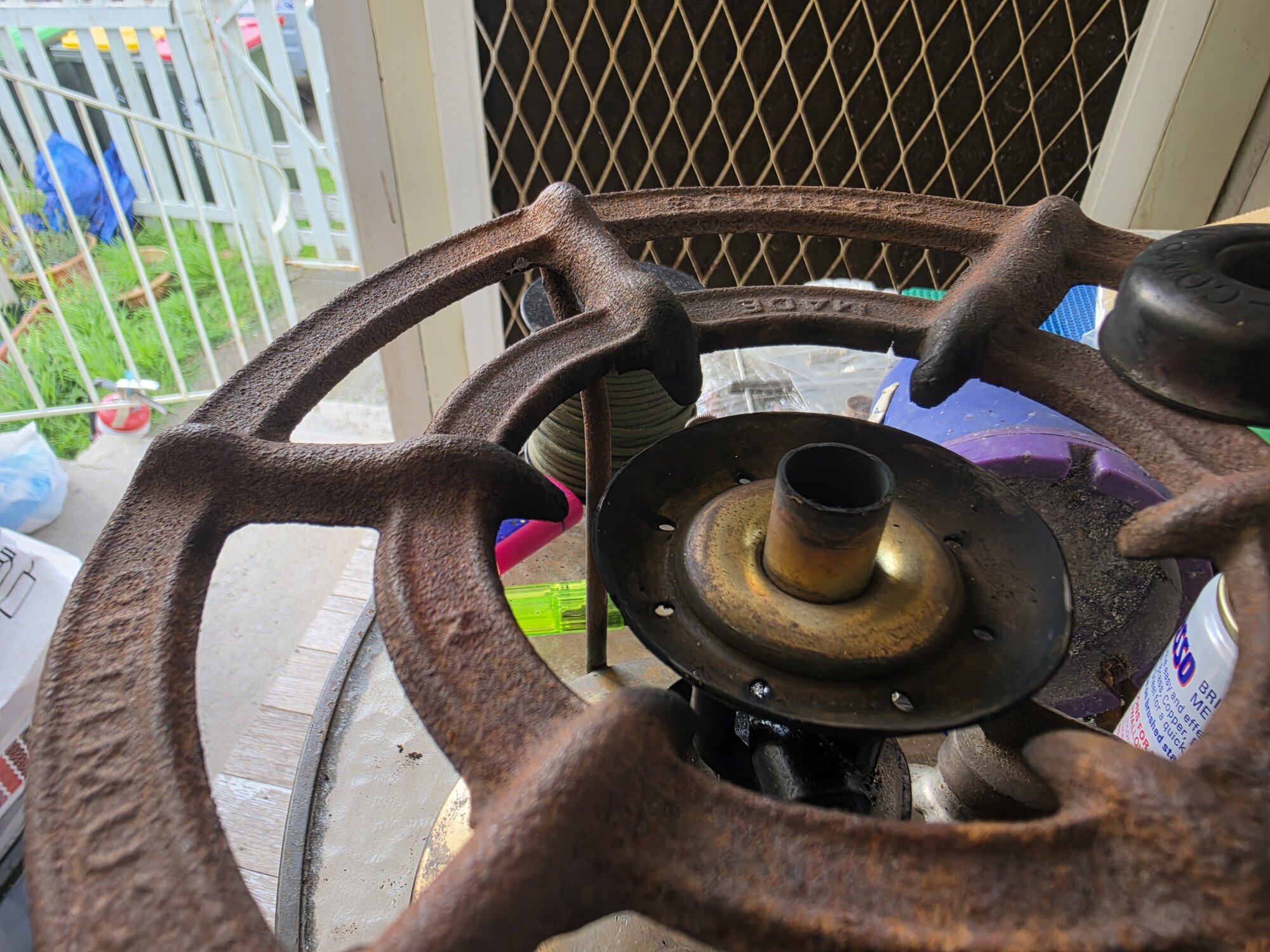

    Encouraged by the flame on my primus No 1 I decided I would try out the optimus. I pulled the cap off where the regulator should go but it looked factory? I screwed it back in gave a little bit of metho, sealed off the pressure release and gave it a few pumps.
    Well it seems I have a flame thrower. The more I pumped the bigger the flame, the kerosene seemed to be in a stream and not vaporise.
    Starting to think I should just replace the burner all together. I can not to find parts for "companion" assume primus would be interchangeable. Seems to be a few different parts that need to be assembled in order to make it work properly. I like simple.
    Anyway a couple pics including the flame and the part where the spindle goes, maybe someone here can identify the part.
    Rob

  18. ROBBO55
    2,685
    Sounds like you didn't preheat the burner enough.
    There is more metal in a regulated burner so it takes longer to preheat. Especially in cold conditions. Try a double prime and exclude any drafts.
    If that doesn't work check the nipple is tight and none of the seals are leaking.
    From the last photos the spindle and i presume the cleaning needle rack has been removed. A plug (not original) has been installed.
