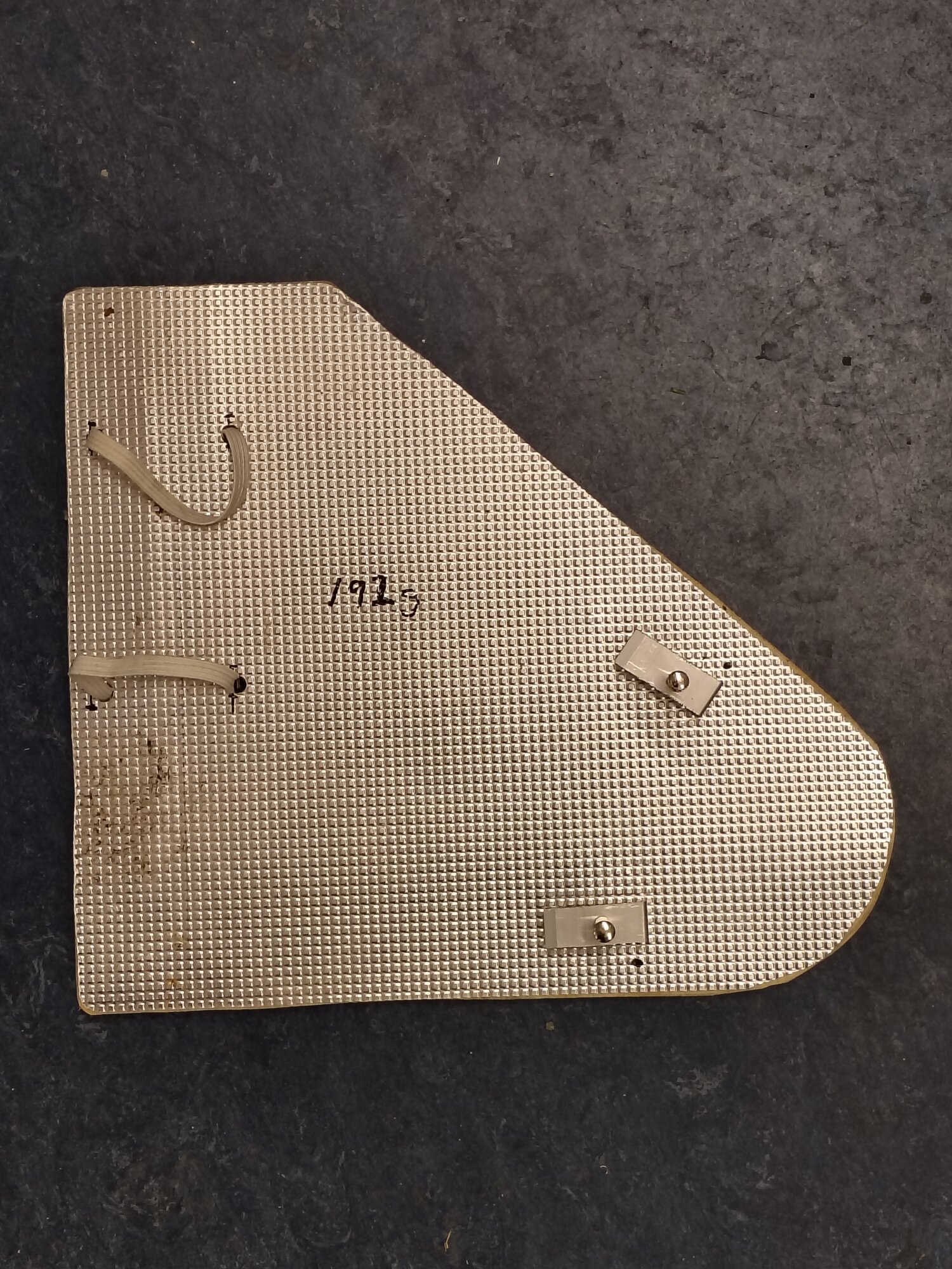

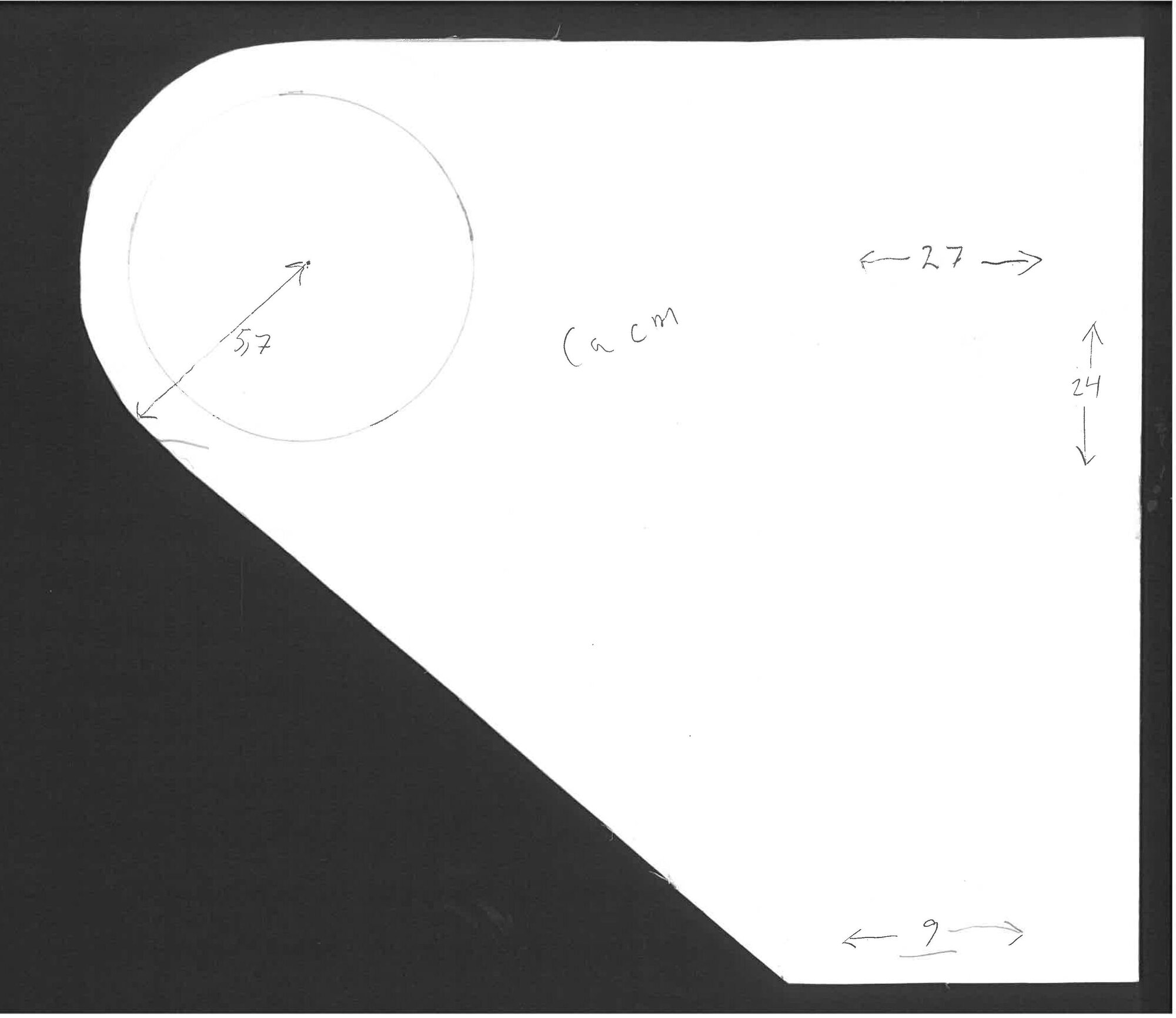

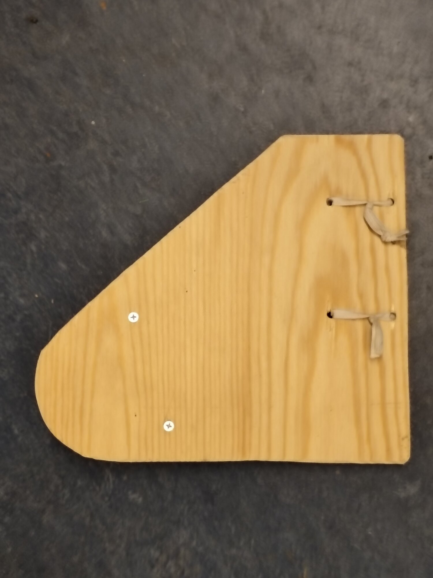

    Thank you all for this info, and Thank you to Doc Mark for all his help. I have had my stove un-fired for a decade. Now was the time for firing it up, just tested it so far with an old pump, but I will use it with a new pump and bottle.
    To have the stove sturdy I am making what we call a "Primus plate" in Norwegian. IMG20260601181446.jpg
