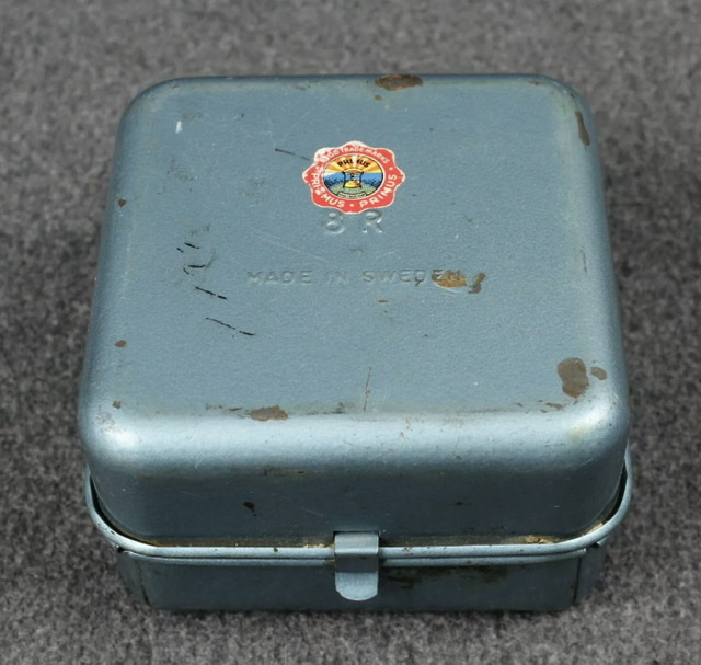

    Hello!
    I’ve just gotten myself into stoves and am the proud owner of several now, some new and some old, and one I recently picked up is this Primus 8R. I’ve only performed a rough polish on the mechanicals and cleaned the box with simple green. After a few tanks of fuel, it provides a decent blue flame. I’m new to fettling so I’d rather not dig in on this one, since they appear to be rare. Anyway, finding this site has been an amazing resource for my new hobby. BE006FF6-D982-4EC9-B7D7-24B48523580B.jpeg 7BDD64ED-40CE-4E35-BBC8-7F5CBDE17A19.jpeg Thanks everyone!

    Welcome to the forum, glad to have you here. I have one just like that. Nice little stove, congrats.

    @Jesse
    A warm welcome here.
    Lock up your savings - these stoves are known to breed in the dark, when left unattended ;-)
    You got a nice older version there.
    If youre not feeling for disassemblying the Safety Return Valve inside the filler cap - you can check its moveable by using a dull ended nail (not sharp and pointy) to check that the valve can move just a little bit when pushed from inside - with a springy feeling.
    If its stuck - you better disassembly and fix it, as its your safety on the line here.
    A flameshot would be great.
