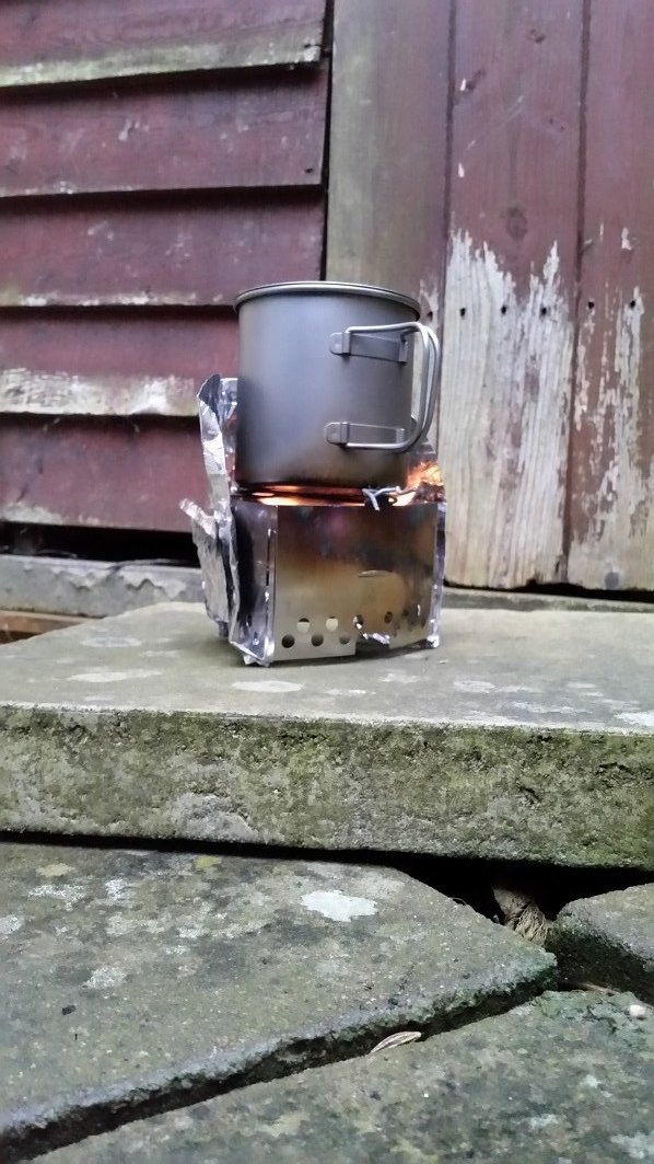

    I've used a Triangle for some time now. I can't comment on the Clikstand or Esbit alternatives - never used them - but I can say the Triangle is a real surprise.
    With burner support, wire for potstand and foil for windshield it packs flat, down to less than postcard size and that's more important to me than weight.
    It's as near as quick as a stormkök set as makes no difference and I have managed scrambled egg in an actual pan so you can do proper cooking with it should you need to.
    It is a compromise, like everything else. The 25-2 is a better cooker, no doubt, but there's a lot of bulk to cart around there. Pick the tool for the job and accept that there will always be compromises.
