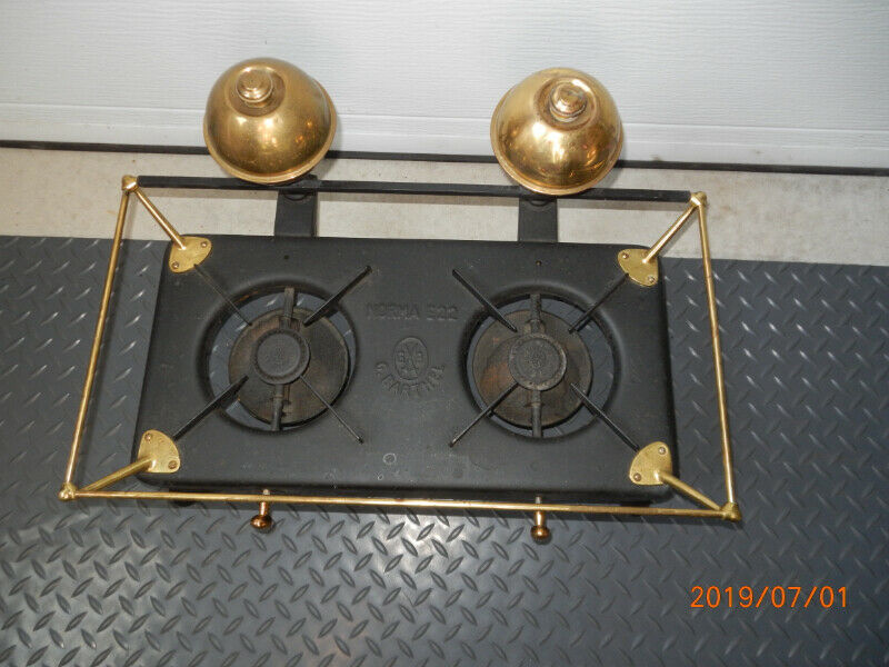

    Well I finally negotiated a good price and have it now in my hot little hands. Is there a tutorial in how to fettle the burners? I have one apart and am intrigued by the wicking device in the feed tube. Does this look reuseable, if not what are my options?. With all the innards removed from the burner should I be able to blow through from tank side right through the burner...not happening now.

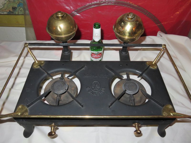

    I have Googled the model number...NOW E22 NOT S22...and have seen no others with the rail. Also noticed others have wooden knobs..this one has brass. No numbers stamped on the parts anywhere. Would like to know the vintage of this. Pre WW2 or later? Everything is sheet metal. Tubes are copper. Meths tanks are brass with some kind of clear coating. And what is D.R.P ? I have heard of D.D.R so not E.Germany but something of the mfg? Full fettle in progress, possibly flame shots later.

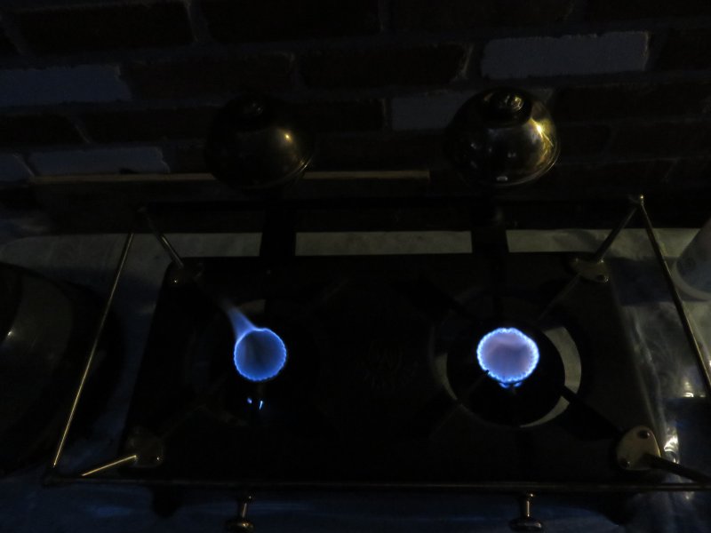

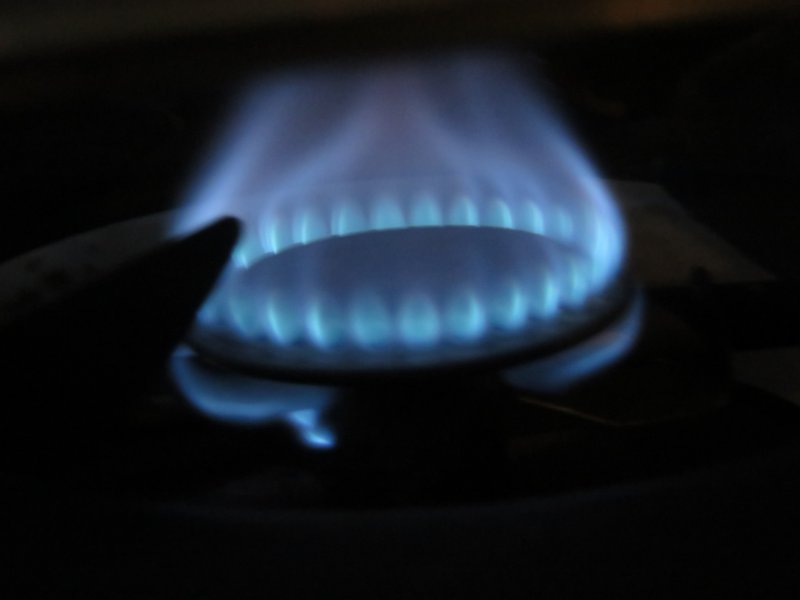

    So I finally reassembled it and it needed only a few repairs. One of the valve needles was broken off and lodged in the fuel tube completely blocking it. This was repaired by pushing out the obstruction from the opposite end. I then had to shape a new needle on the remaining shaft end. I have posted a few flame shots. After this I will try to beautify the beast because I like shiny things.
    I now understand why other models have wooden knobs...the brass ones get very hot.
