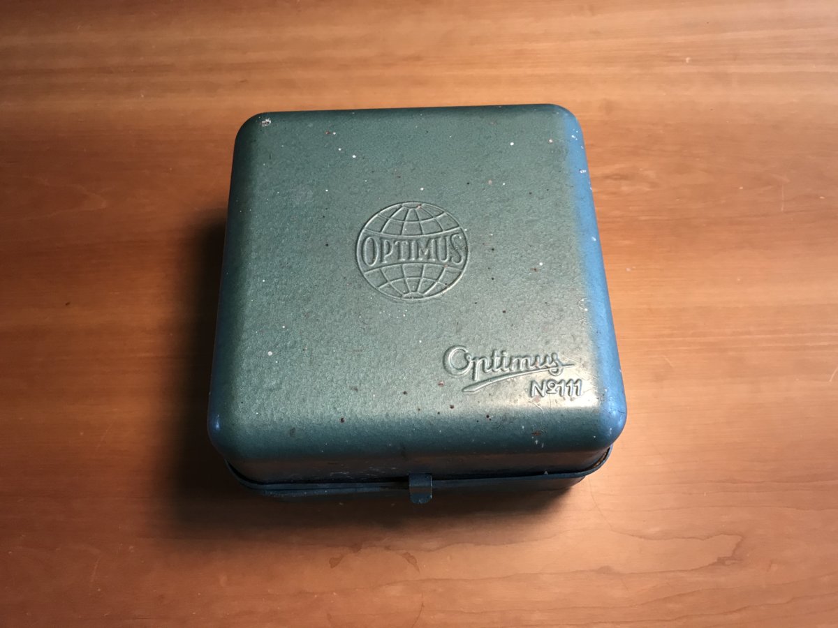

    This week I received my newest acquisition: green Optimus 111 roarer with a white cookie cutter-type knob.
    It came from France and the package included a spirit can, a reserve pump leather (which is bone-dry) and: the original wiper cloth, and the user manual.
    See for yourselves
    IMG_0508.JPG IMG_0509.JPG IMG_0510.JPG IMG_0511.JPG IMG_0512.JPG IMG_0513.JPG IMG_0514.JPG IMG_0515.JPG IMG_0516.JPG IMG_0517.JPG

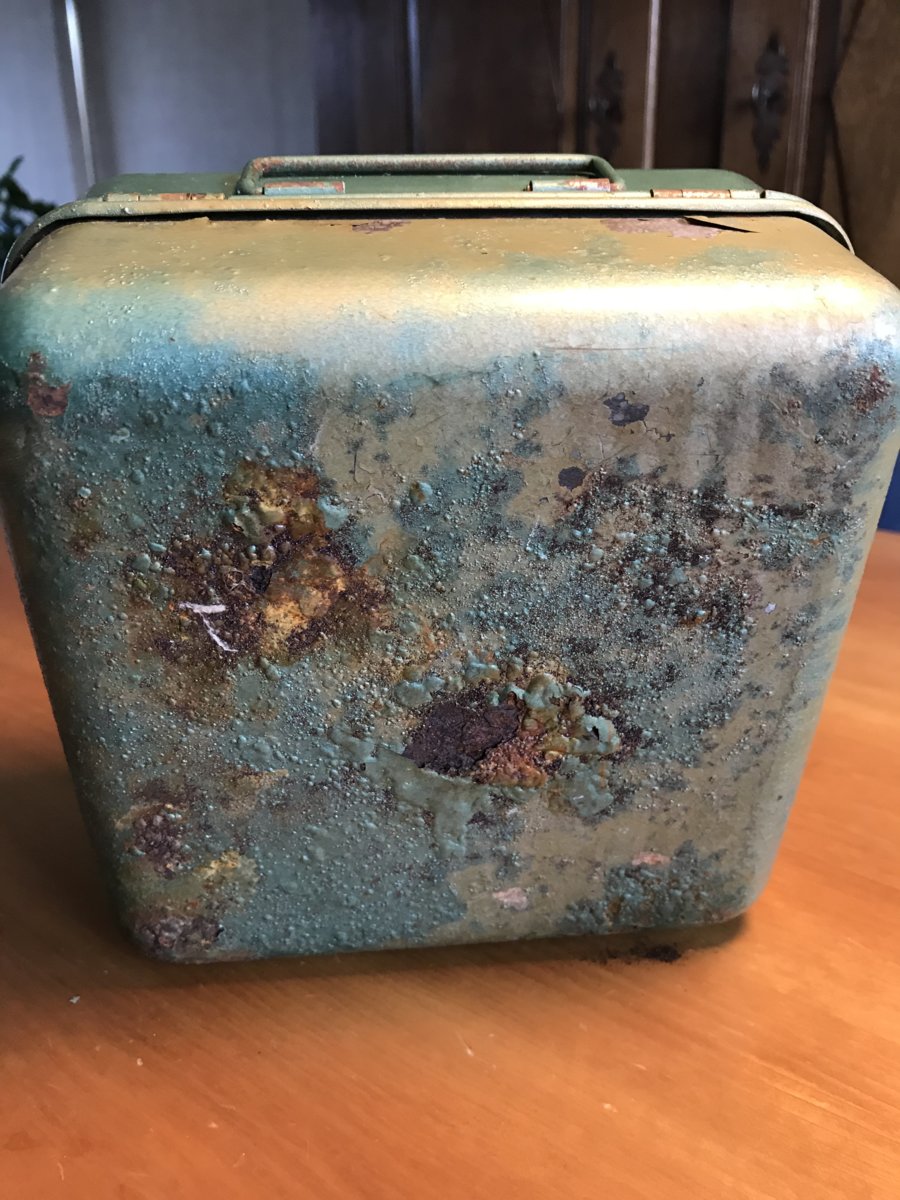

    The burner is marked Optimus Sweden
    The undertray is corroded, mainly on the outside/underside, but otherwise is in a a remarkable condition for a stove that dates from the mid fifties (as far as I can judge).
    Not a bad buy for EUR 50, I suppose.
    The pump leather within the pump does't do a thing, so replacement is in order. I will have a good look at is to see what else is needed to bring this beauty back to a roaring live.
    At this moment I would like to preserve the case as it is at the moment. It would be a pity to get rid of the patina. It is, no denying, more than 60 years old, why not show it?

    1. The carry handle on his stove has a more pronounced rectangular profile than the rounded corners on my stove. This is typical of the first Op.111 stoves.
    2. His stove has both the top-feed hole in the burner for alcohol priming, and a scoop-style feed on the side of the windshield. The scoop-style feed was the earliest form of alcohol feed on Op.111, dating from the early 1950s. This could be a transition stove to the burner top-feed piming model.
    3. Your stove appears to have no slot in the lower case to locate the closing clip attached to the upper case. This is also an early feature of Op.111 stoves.

    It is an early model, but not the first. The hinges is a tell tell sign. Latest edition Optimus 11 case was used as the first Otimus 111.
    Look at the hinges picture 3

    What ‘s your opinion about the undertray? Shoukd I try to preserve it or should I repaint it?

    Hi @burny pyromaniac . I am sure that you should treat the rusty areas of your stove to totally remove all rust and passivate the steel surface. You can then paint the prepared surface and go on to enjoy another 70 or so years of stove use.
    I find that Phosphoric acid is an excellent rust remover/ passivator. See section No.4 of this thread:
    Stove restoration. Parts 1 to 4
