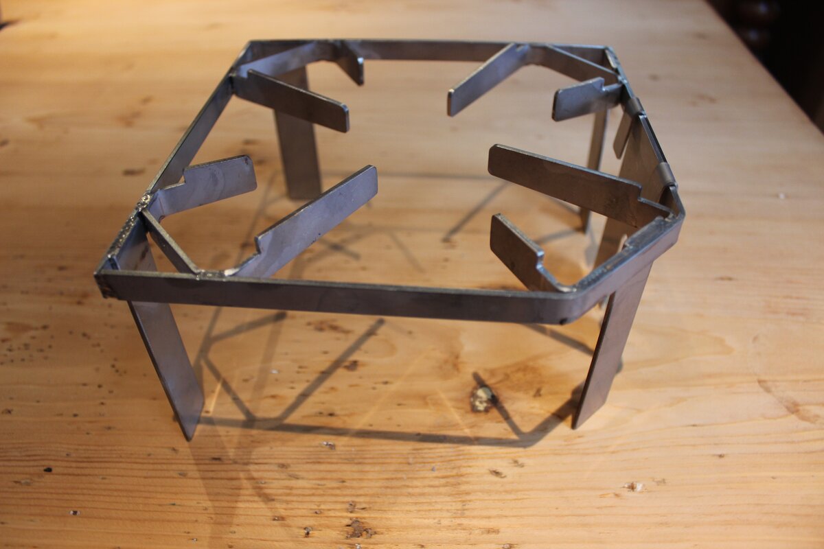

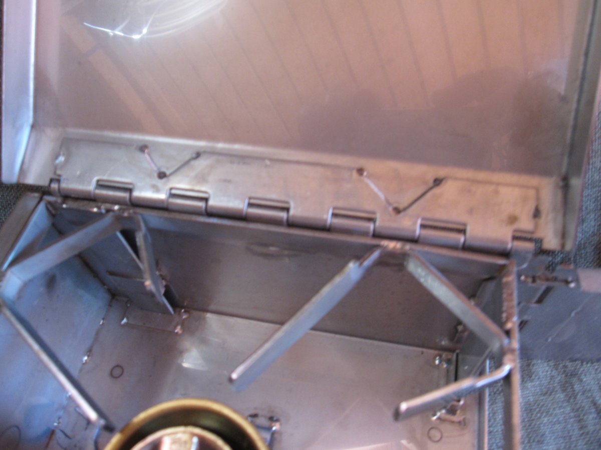

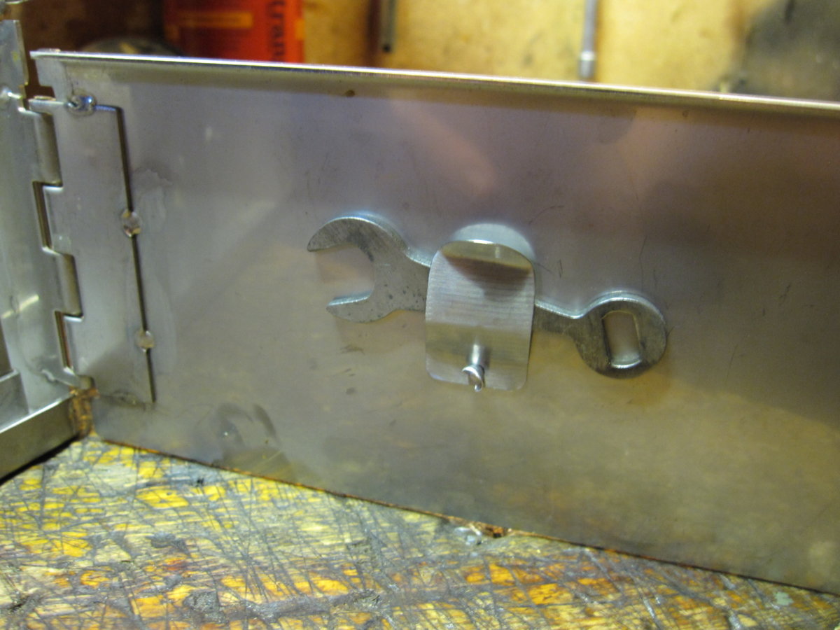

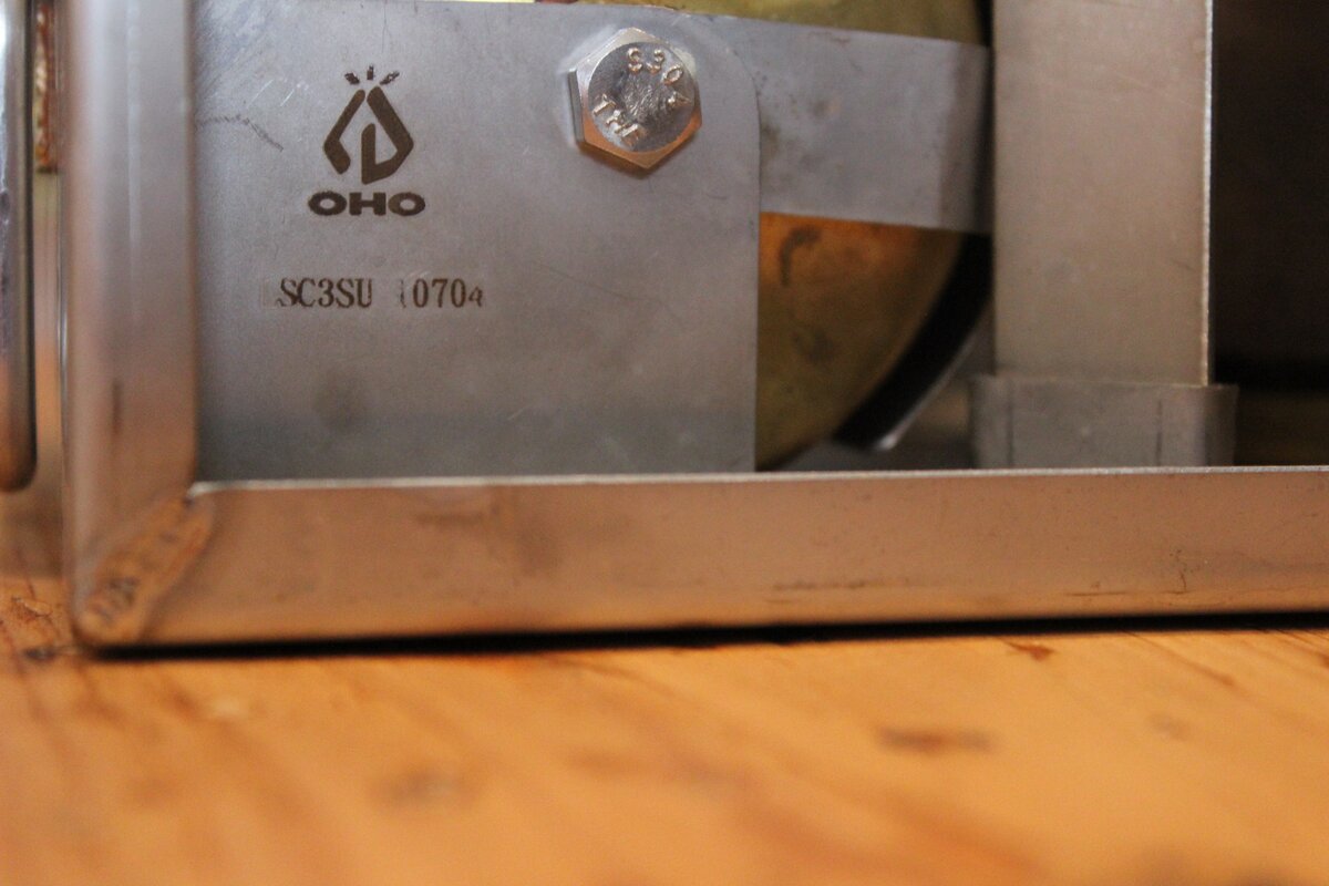

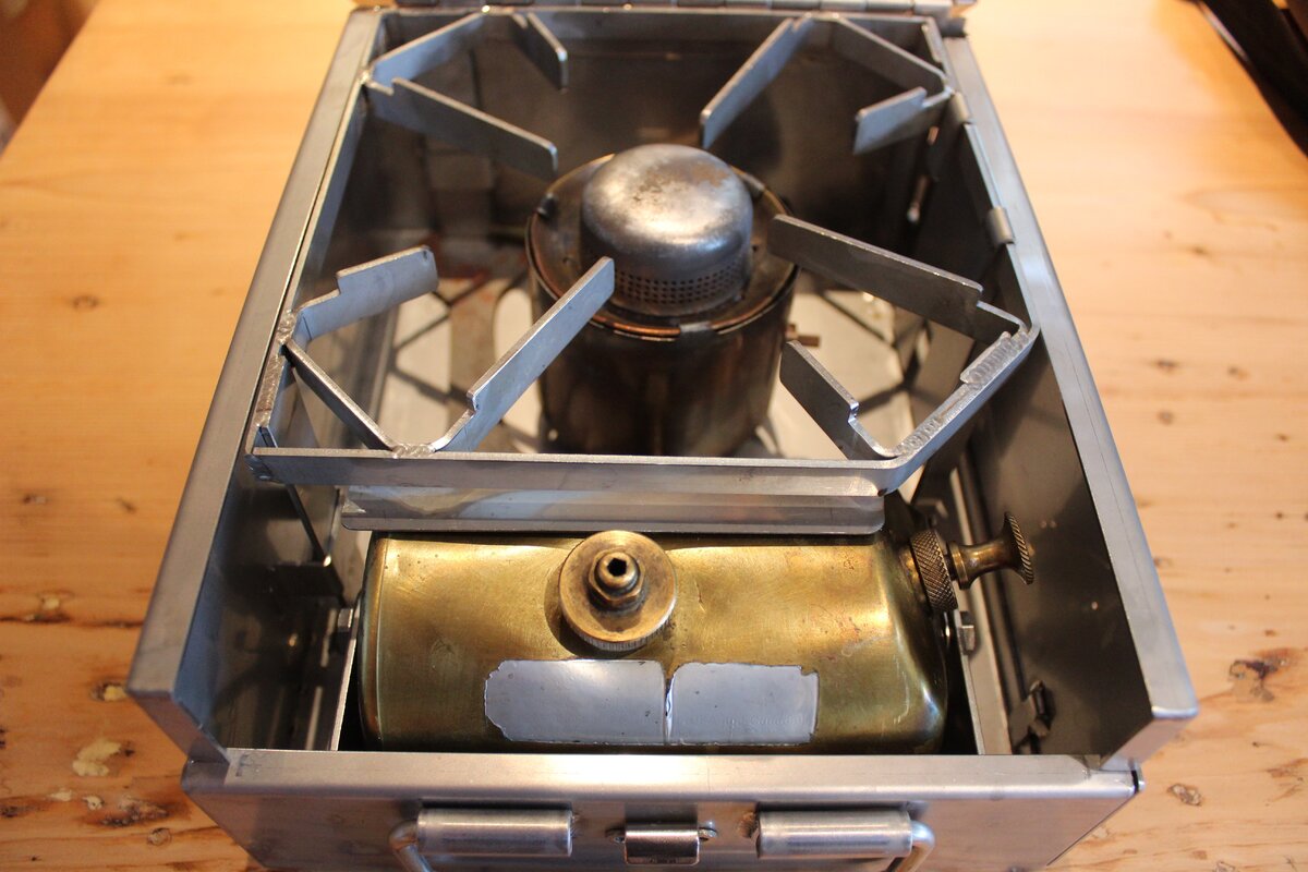

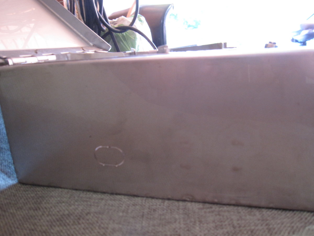

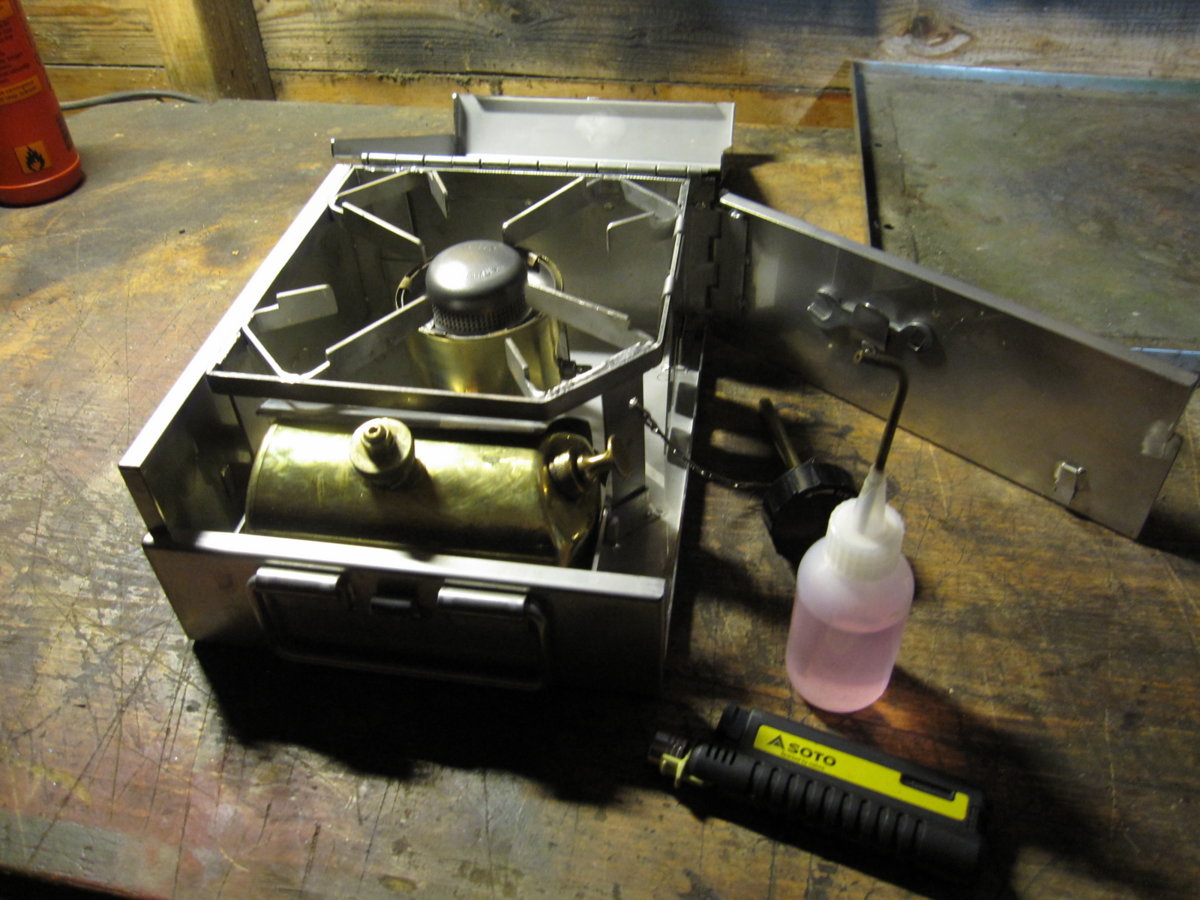

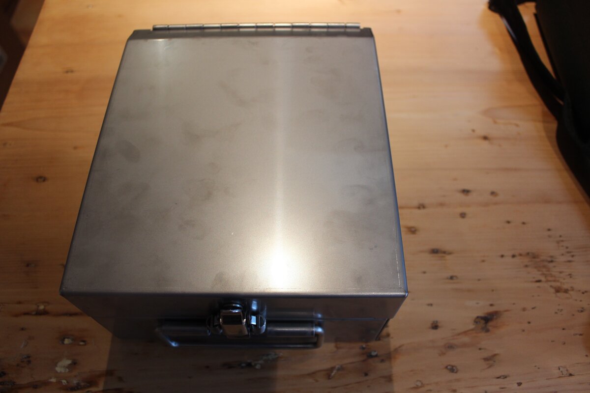

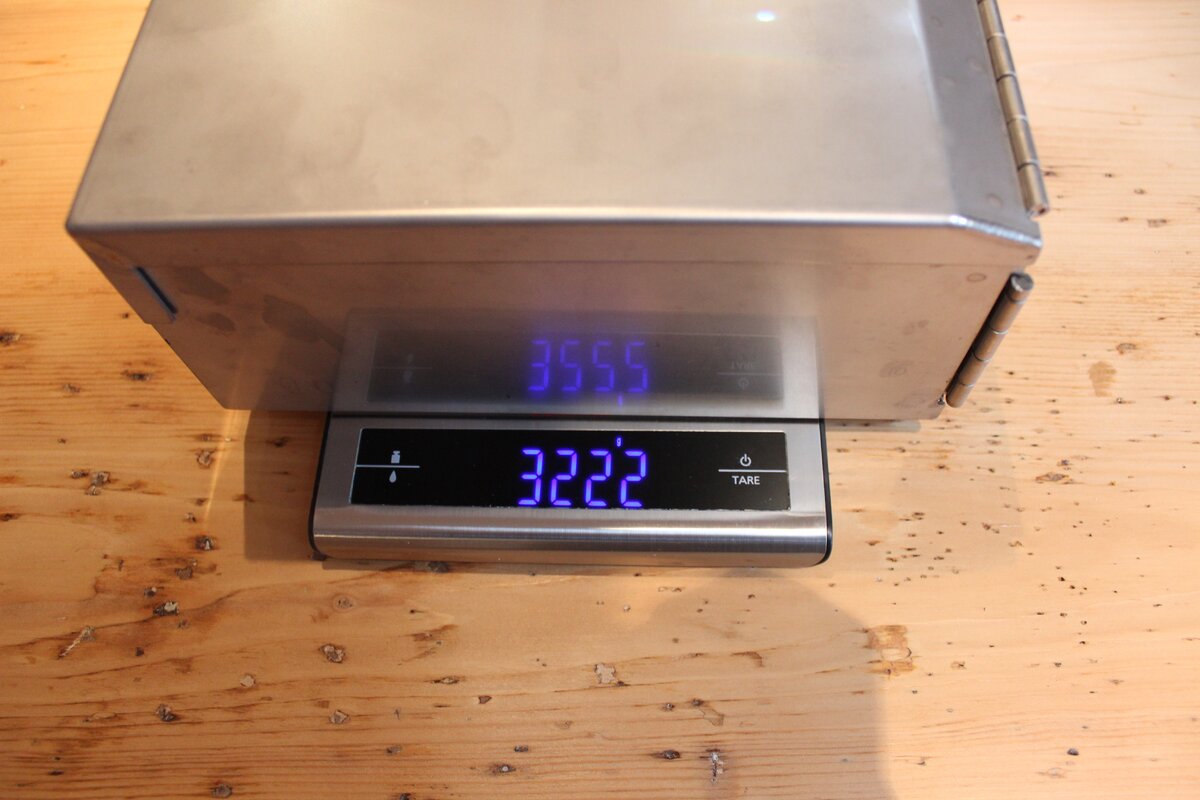

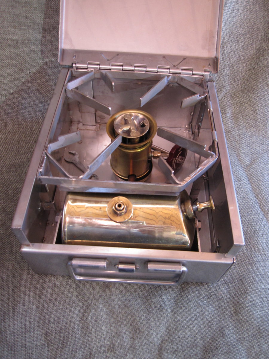

    Ever since I saw Bernie Dawgs brilliant post about Shelterbox Nomad boxed Optimus stoves, I have always been looking for one like it. Check the link below. This summer I found one similar on Ebay from Taiwan. And when I had an unused Optimus 111 without box , I ordered one. Box is quite well made of 1,2 mm stainless steel welded together. No sharp edges. Dimensions are 105x195x235 mm ( HxWxL ). With the Optimus 111 installed the weight was 3 kg pluss. I made two modifications. One for fastening the control wheel and for the small wrench I pot riveted a clip to hold it. I have not yet fired it up but will soon. The box also came with a carying case.

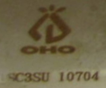

    Ah hah! Cookie you're in Florida and you've found this case, cool.
    Cookie, all,
    Our site frowns upon posting ebay links, except in Auction watch, can anyone provide the exact title to aid with an ebay search.
    You might even include price w/comment... BIN or sold price if available.
    I myself, and others too likely, find it is an interesting option and those of us who have not yet seen it offered would be interested to learn more.
    Thx omc
    PS OHO # on case, OHO logo on bag and case
  6. Christer Carlsson
    Nov 12, 2005
    3,292
    Yes, OHO indeed.
    Just search for oho stove case, and you will find them.
    There's also a version made for Radius 12 (and probably also No.10), and that's even more interesting since these tanks with burner often pop up alone on their own, without the stove range they belonged to.

    VERY sturdy case! :thumbup::clap: Rivet for jet&packing key clip seems a bit weird? :-k
  8. boknasild
    boknasild Subscriber
    Jan 30, 2010
    570
    @Afterburner
    I fixed the clip by riveting it in place. I did not want to have the key rattling around in the box.What is weird about that ? Use bolt and nut maybe ?:)

    on ebay search for "OHO 3S Stove Case for Optimus 111 - with bag - Stainless Steel"
    I was searching to make a perfect emergency stove for long term use during hurricanes and such. Not really looking for something lightweight since it will stay here at home. I have other stoves for carrying purposes.

    1,927
    @boknasild Ok, it was a DIY fix. I thought that it was original. Everything else is welded so rivet for the clip seemed a bit weird for me. Also rivet is extending from the surface so that increased weirdness factor few microns. :D

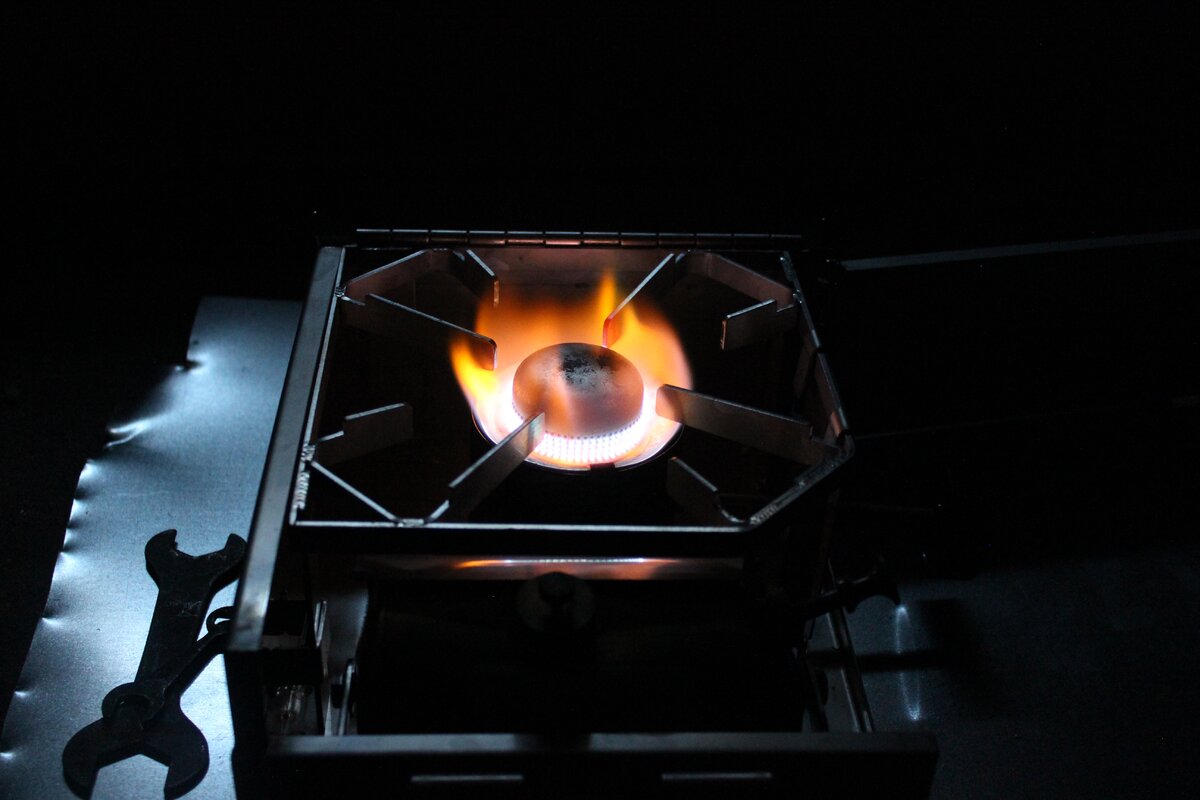

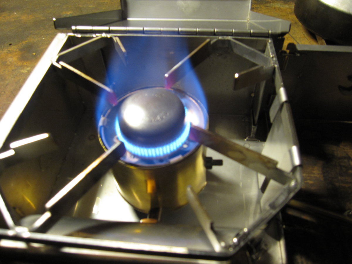

    Hello

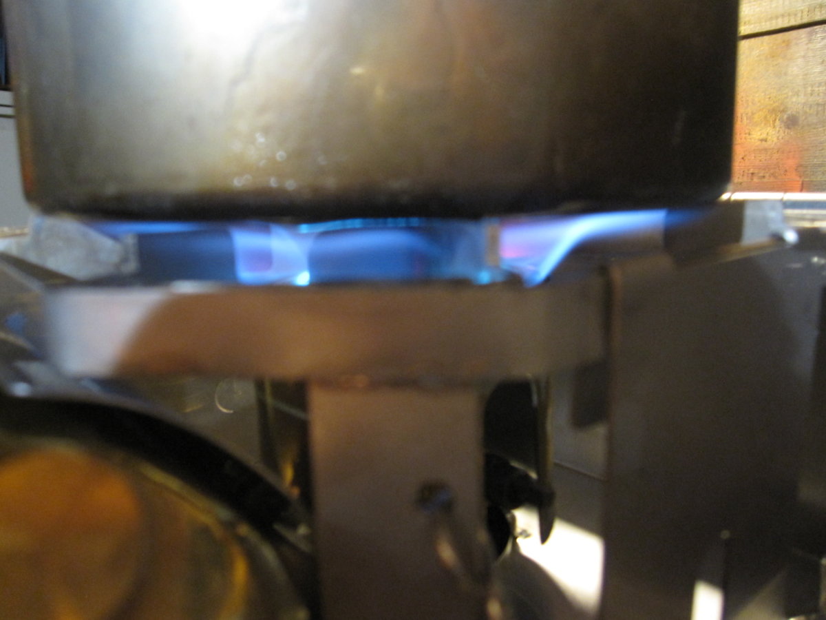

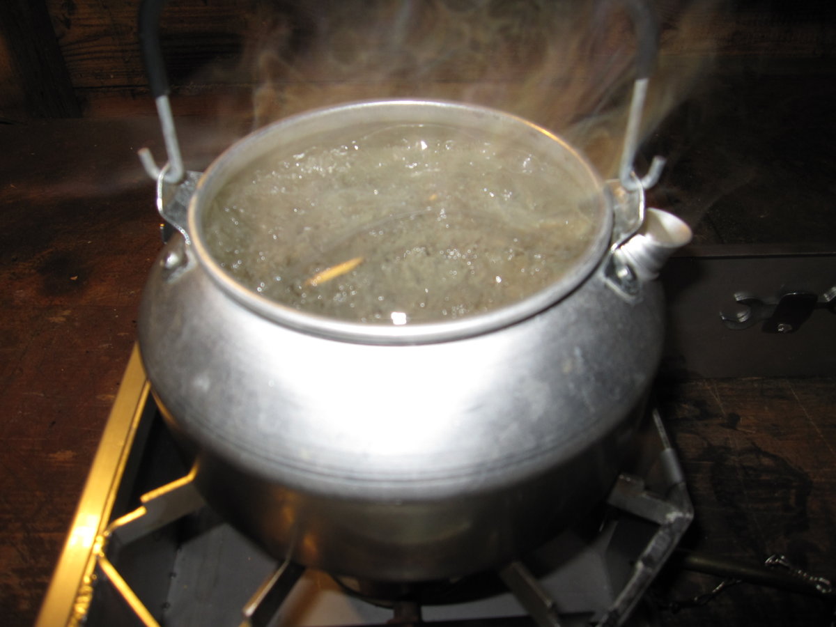

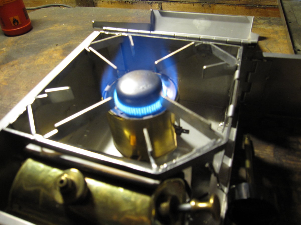

    Thanks to one of the subscribing members I was reminded to do a test fire up. First I replaced the roarer with a silent burner. The half liter of cold tap water boiled in 5 minutes. Pleae see the photos. The stove functions very well.
    Bjørn

    I member here told me this combination of burner and case looks similar to Svea 158. I agree as you for instance can open up the side panel and insert the regulating wheel
