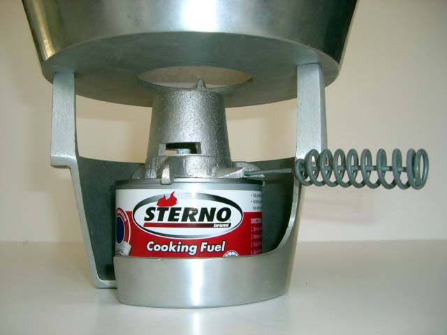

    Kerosene and propane are not your only options for a gimbled stove. There's also alcohol and Sterno (jellied alcohol). The Optimus 45s used in Sea Swings were often fitted with 209 alcohol burners like this one:
    They also came with a chimney that could be used with a can of Sterno like this:
    Alcohol fires can be doused with water which is an attractive safety feature considering how readily available water is to someone floating on it. You'd also be surprised by how well these Sea Swings do while underway even in bumpy conditions. The hard part is not spilling the hot liquid all over yourself after removing the pot from the stove.

    Yes, after I committed to and had purchased the kero version of my stove I learned of the alcohol and even Sterno versions.
    When I purchased my Sea Swing sans stove, it came with a Sterno chimney has you described. I carry a Sterno can as a back-up.
    As for the fuel, since I had already purchased the stove the choice was already made. However, I learned to appreciate the advantages of alcohol (easy to put out with water, only needing one fuel). On the other hand, I also was reassured that the energy content of the kerosene was much larger which negated any buyer's remorse. ;)
    Alcohol versus kerosene??? In the final calculation, I could have gone either way and been happy. :) :)
