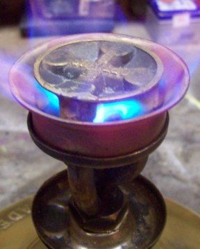

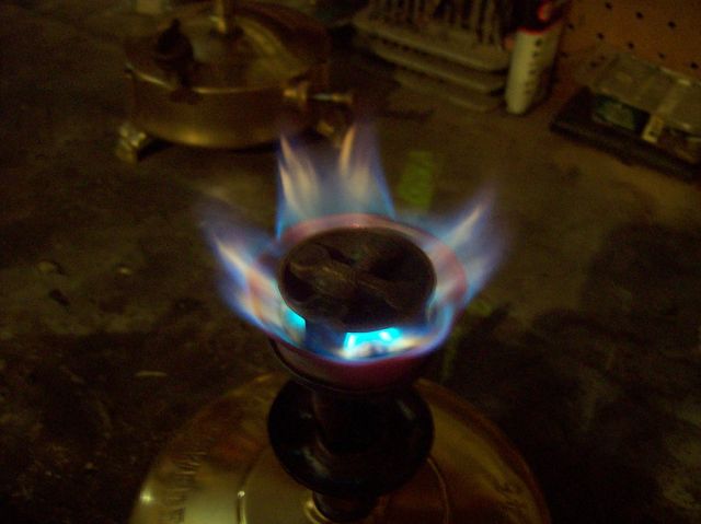

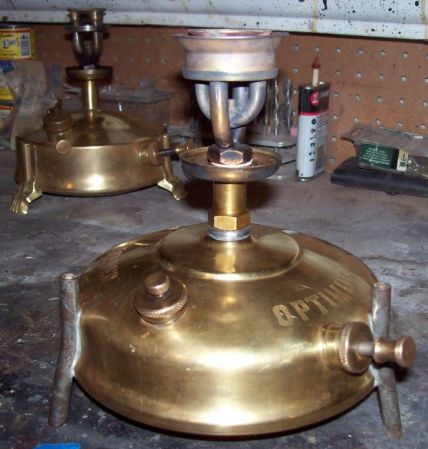

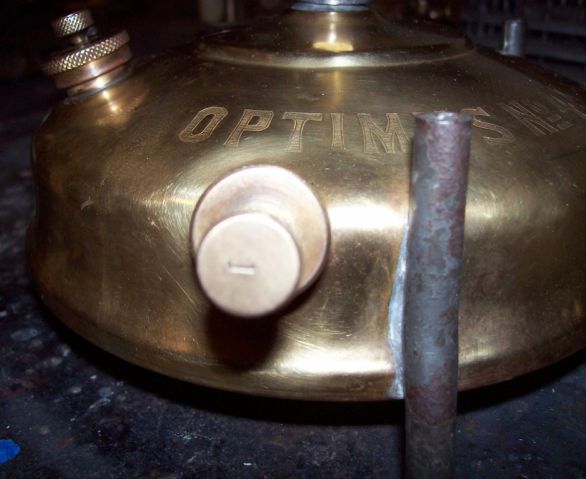

    I believe this is similar to Kerophile's '62 stove. This is my first kerosene stove, I got it after I joined CCS in Nov 2008. It has been a challenge to say the least, however today, I got it to run (I think like it should). I had to replace the nrv, the jet was leaking and I had Base camp ship me the Monitor spares kit with the swivel jet tool, that made all the difference and was a great deal too! I put a new jet in and got it tight enough so it no longer leaked. The washers that came with the kit fell apart so I used some exhaust manifold gasket material from the local auto parts store to make one. The washer below the spirt cup kept falling apart so I stuck a nitrile oring there. The lead washer below the fuel tube is fashioned out of an old lead weight that I pulled out of a tackle box (I had read where someone on this site had done that). There is a #7 (I think or maybe an L) on the bottom of the fount and a #1 on the end of the pump handle, not sure what that means if anything. I would like to do some more work on the brass at some point. But just getting it to run :D/

    Hi Rick, your Op.45 stove is looking good.
    Unfortunately Optimus did not date-code their excellent stoves, so you are left looking for dates on accompanying instructions, or consulting catalogues to try to date small design changes etc.
    I am glad that you eventually got seals made and fitted. Have you seen this post on Heat-resistant washers?
    https://classiccampstoves.com/threads/8382
    I think that your lead washer between the tank and riser-tube might be rather big. The original would have been fairly thin lead washer (Part 289)fully contained within the riser-tube, where it sits in its own machined groove.
    https://classiccampstoves.com/threads/9292
    Are you sure it is still not there? They can become very discoloured and dull as the lead oxidises.
    If you do need to replace it I will check the dimensions later today so that you may make one.
    Nice Fettle.

    Hello Kerophile, Thank you for all of the information and kind words. How do I go about ordering a set of your heat proof packing (set of 5)? I thought when I received the Moniter spares kit that I would be able to use the ones that came with it, however, as you read in my post they basically fell apart. I knew the size of the lead packing at the bottom of the riser tube was probably incorrect, but when I received the lead packing I had ordered from Base Camp, they were way too small (they must have been for the nrv), so I left it as is for now, if you have the dimensions I will try to make another or try ordering again from Base Camp. I had looked at all of the instruction manuals etc, when I started to fettle the stove, what throws me off a bit is the spirit cup which has the dimple. Maybe, who ever owned the stove before me had replaced the cup with another.

    Hi Rick, I can supply DB heat-resistant washers for both 1.75/2 pint stoves and the 1 pint size, at the moment.
    I will send you a PM.
    If you are buying Heat-resistant washers I can send a lead washer at the same time.
    The dimpled spirit-cup is not an original for this stove, being somewhat earlier. However it is very useful and better than the later style in my opinion.
