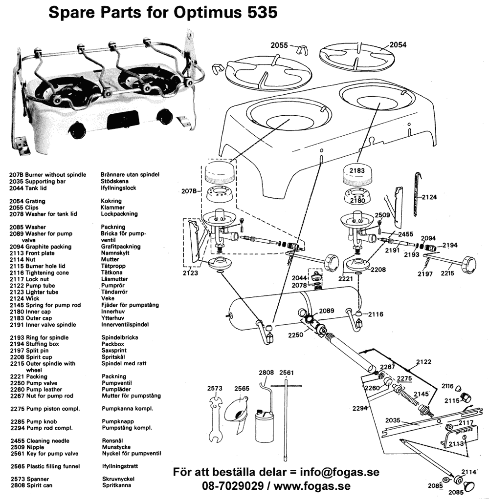

    I just bought this fine stove today. It comes from a boat and it seems to be special made for boat use but is it rare, I have never seen this model before.
    Niels Chr.

    Hi - nice example but fairly common. This is the 535. Originally a Primus model.

    Thank you for the answers - by the way the fillercap has puzzeled me a little. Is it a safetyvalve as well, and when you want to shut the stove down, do you just unsrew the fillercap or is there an other way, it seems a little awkward to reach over the burners to open the fillercap.

    the regulated burners should completely shut off and the filler cap will be the wrong one. Yours is for a 123 or similar but should be one the same as the optimus 00 which is the same thread but has an air bleed

    Hi, Check out the photos of Primus 535 stoves in the Gallery. I believe that the tank was not fitted with an air-release screw, but sometimes a safety pressure-release cap.
    If the regulated burners shut of completely, as they should and you are using the stove regularly for a period, as you might if you are using the stove on a boat, it makes sense to leave the tank pressurised for the next time you want to use it.
