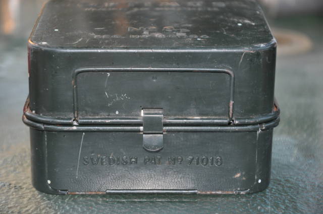

    Here is my early Optimus 8. I dont know much about this stove just what i read from the previous posts. If anybody knows details about this stove i would love to hear from you as i've really come to love these older clam style stoves. Bryan's post helped me date it to early to mid 1930's but beyond that most info i found is for the 8R with rounded case sides.
    It has three optimus poker sticks made of metal but i dont see a pump so i dont know how it works.

    These date from 1931 to 1947. That said I don't think the early 30's is right as there was a earlier model of the 8. Late 30's seems to fit better.
    There is no pump like seen on the later 8r's. These are self generating pressure stoves. The Svea 123 is another stove like this. They need to be primed. That priming creates heat and vaporizes fuel and builds pressure inside the tank which forces fuel out the jet. Simple eh. Well fuel will try to leave other places like the fuel cap, safely release, control valve, burner connection. They burn only Coleman fuel. Caution should always be taken when using a Coleman fueled stove.
    The metal bits are called prickers and are used to clear the jet of carbon.

    Good catch! I've never seen a 'square side' tin like that, nice one! They are dead easy to run, given the tidy state of it, I bet a new fuel cap seal will have it blasting away nicely. The only other thing that may or may not give you gyp could be a cooked fuel wick. Petrol stoves use a wick to sop up fuel, running them right out 'can' char the wick where it enters the fuel pipe, resulting in a lack of power or none at all. Easily replaced, even more easily avoided, just dont run it till it stops. The fuel tank needs a good sized air space at the top, dont fill past a skinny 2/3's until you get a feel for it.
    8r's have a deserved following, tough little buggers. If you develop a liking for it, they can be very successfully pimped out, Berniedawg posted a benchmark example a couple of months back.

    Yours looks in great condition and has excellent paint. As such, you have a rare and valuable old stove there. Please treat it carefully. I agree with Jeff that it's likely late thirties. If you check the link above I have a picture of the wick from mine. All these 8 series stoves are self-pressurizing, no pump needed. The "poker rods" are what we here at CCS refer to as "cleaning needles" or "prickers". The "pin" on the end is a "pricker wire". The "generator opening end" is known as a "jet" or a "nipple". It is a threaded bit of brass that screws into the burner. The "burner cover" is called a "flame plate". I'd advise leaving it as is. It's very unlikely you will find a proper replacement for this 75+ year old stove and it's just fine the way it is.
    The mark under the top of the case is where a clip was spot welded to hold the prickers. Most all of these early 8's are missing the clip.
    The seals (cap seal and the cap safety release pip) are probably hard and need to be replaced should you decide to fire the stove.

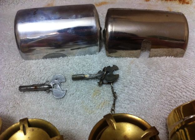

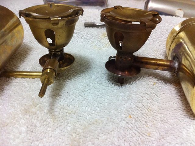

    The earlier 8's had a different design to the feed tube.
    The early 8 is on the left and the later 8 is on the right below. The heat shield and key are different as well.
