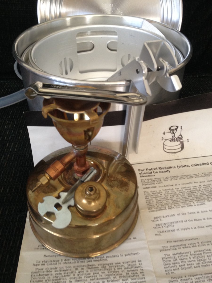

    just picked up a Svea 123 that had most of a optimus 88/124 pot set with it. missing the larger pot and the lid/pan. want to retire my msr whisperlite and use this as my main stove.

    also , the Svea 123 stove doesn't turn off until I turn it all the way to the left and use the cleaning needle to block the jet. turning the key to the right lets the stove still run.

    Different burner but same operating principle. You can see how the valve closure and cleaning needle are synchronised in this cut-away:
    Regulated burner cutaway

    You have an Optimus Svea 123R and a
    recap, you shared you have an 88 missing larger pot and pan/lid, 88 is a small/solo? cook set.
    Brad suggests, what you have is (the best) as good as it gets.
    Can you post a pic of your incomplete 88?
    With all due respect, what Brad might be describing? is the, often praised, Optimus Svea 123 / 123R with SIGG Tourist setup.
    FYI, here is one example of an 88, smaller, note lower windscreen
    source
    here is an Optimus Svea 123 sold with SIGG Tourist, larger than 88, note lower windscreen
    source
