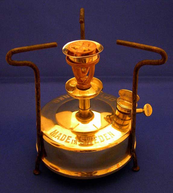

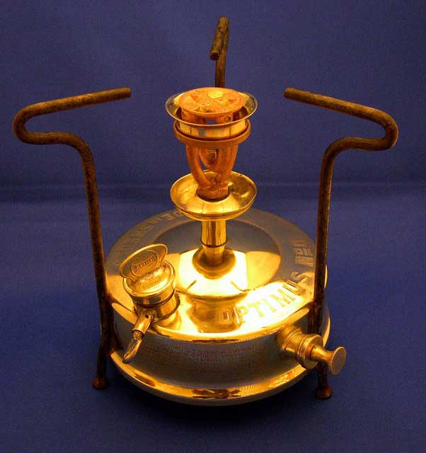

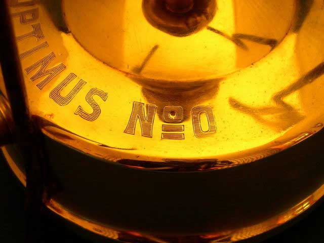

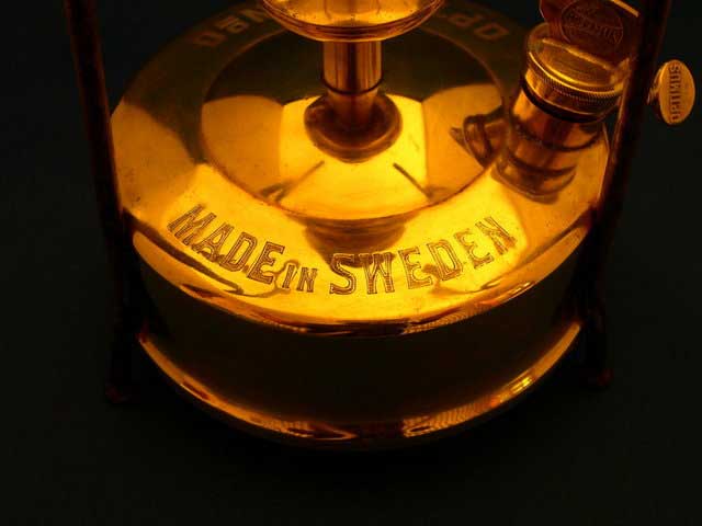

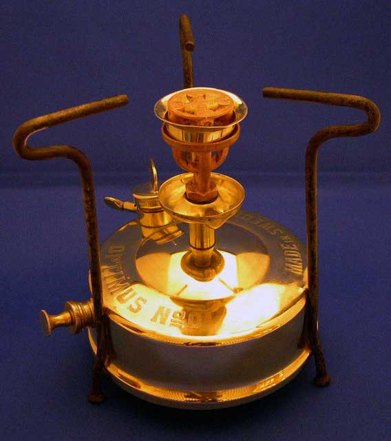

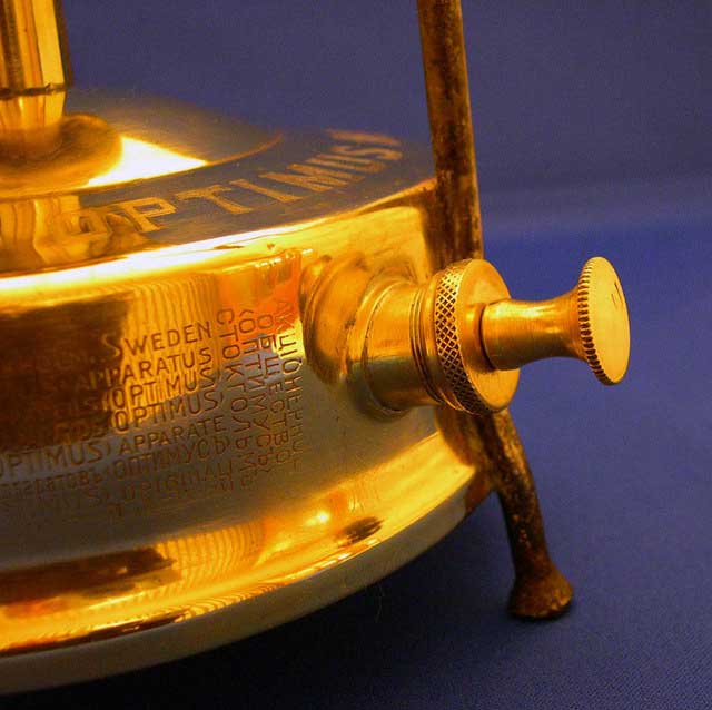

    Hi, I thought I would share some photos of a stove I have been working on today.
    This is a rather rare stove I think; an Optimus No. 0 from the mid to late 1920s.
    The Optimus No. 0 is a 1.5 pint paraffin stove with fixed legs, which shares the same burner as an Optimus 00, 1 pint stove.
    The spirit cup has a dimple, again as shown for the 1929 stove. By 1939 it had been replaced with the more familiar "modern" version.
    The engraving on this stove is still sharp and clear despite its 70 plus years age.

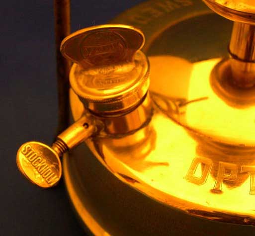

    The filler cap is an early type and is shown in the 1929 catalogue/ spare parts listing.
    The pump size of the Optimus 0 is the same as on the smaller 00 stove.
    Has anyone else seen one of these stoves?

    G'day Bruce. I think the dimple in the spirit cup is there so that when essentially all the spirit is burnt away in the rest of the "doughnut", there is still spirit, and a localised flame at the dimple.
    This flame can be directed upwards, using a shroud tube, to ignite the burner at the higher level, once pressure is applied to the tank, and paraffin vapour starts coming out the jet. This was called the Auto-igniter I believe.
    See the items in this attached link to the 1929 Optimus catalogue:
    http://
    This means that you don't need to have a match handy, and in the case of a silent burner you are much less likely to get the dreaded "underburn", where vapour ignites at the jet rather than at the apertures of the outer burner cup
    Later, Primus developed their own tubular "Igniter", which has an asbestos wick within its expanded base, and does not therefore need the dimple in the spirit cup.
    Thats's what I believe anyway.

    The legs on this stove had rust on them when I received it but there was little metal loss. I removed the loose rust and treated the steel with Phosphoric acid solution to neutralise the rust by turning it into a phospate-containing layer. This looks dark, and a bit patchy but I will do no more at this stage. I could take the legs back to bare shiny metal but I would then need to protect them in some way to prevent later rust formation.
    Originally the legs would have been tinned with solder to allow them to be easily attached to the tank and give them a degree of corrosion protection. They have lost this layer during their 70+ years life and for me to re-tin them would require me to remove them from the stove, tin them, and then re-solder them back onto the tank. I would not feel confident in doing this.
    My friend "Exeter Yak" has dome some development work on tinning stove legs but the proximity of legs to the bottom seam of the tank means that you have to be very careful when soldering in this area. if you want a non-leaking tank.
    I think I will stop at this stage of restoration, which is conservative, and if techniques develop in future, leg improvement will still be a possibility.

    @kerophile Hi George, I'm going to suggest pushing the production date of this marvelous stove of yours back to 1930/1 at the very very latest. The reason for this is information I've discovered in some more recently available catalogues while trawling through them trying to work out how put a rough date onto a slightly later example of an Optimus '0' (which I will now add to the gallery). I have found that the 1929 catalogue is the last to show the sail-type filler cap being used for the '0'. The illustration of the whole stove wasn't updated to show the new plainer filler cap until 1934, but the parts lists in the 1932 and 1933 catalogues make it clear that the change of filler cap design had already taken place by then. :thumbup:

    Hi Ian @igh371 thanks for the information and knowledge. I just realised that the original post dates back to 2006. We certainly have many more catalogues available on CCS since then. Perhaps I should revise the title date to mid to late 1920s?

    @kerophile, "thanks for the information and knowledge" - I can't claim any great knowledge here, just applying and passing on newly available information. However, on the basis of what can now be seen in those more recently available catalogues from the early 1930s there doesn't appear to be any reason to question the dating of that "c.1939" Optimus '0' gallery example. On the other hand, for the same reasons discussed above, the production date of the "1920-30s" No.4 can probably be narrowed down more closely to simply '1920s'. In fact pinning down the dating of the change from the 'sail'-type filler cap to the plainer form to between 1930-2 can probably be applied fruitfully to assisting the dating of many other Optimus stoves. But catalogues and parts lists from 1930 and 1931 may yet surface which will make it possible to date the year of the change even more precisely, we can but hope:thumbup:
