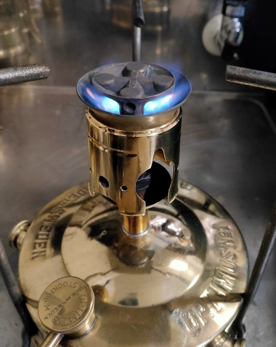

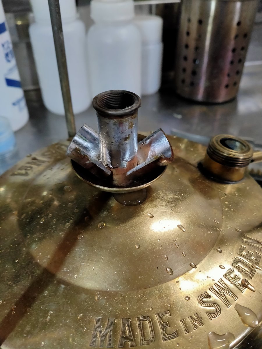

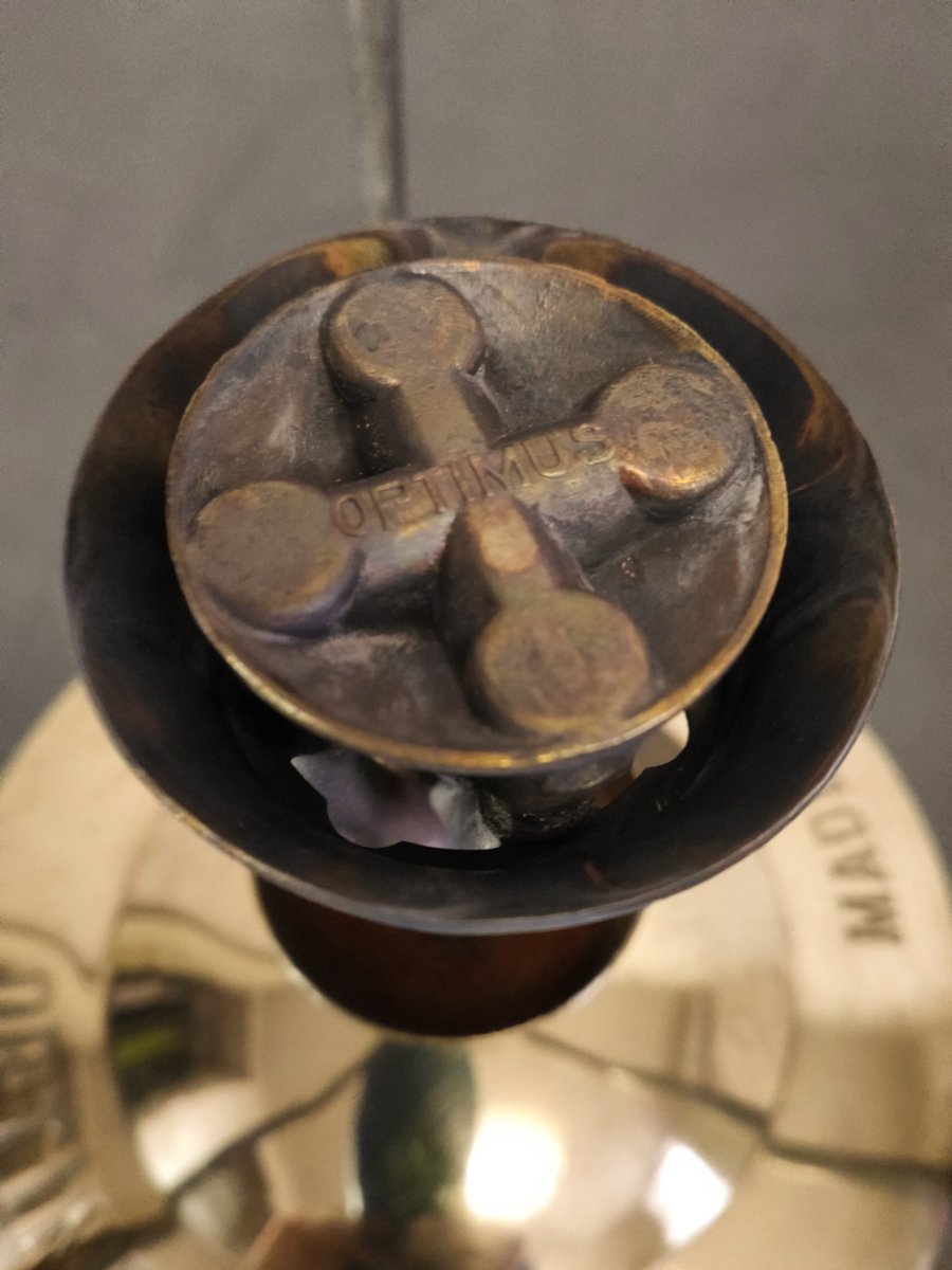

    Hello,I've just finished repairment of OPTIMUS No .1.
    I would like to know when she was made.
    I try to learn from CCS but difficult for me to judge 1912 -1915 -1918?
    IMG_20200229_214332.jpg IMG20200227193459.jpg IMG20200227193935.jpg IMG20200227195325.jpg IMG_20200302_200626.jpg IMG_20200229_214739.jpg
    Please give me an idea of her age.
    My best regards
    HONDA

    Thank you Honda,
    The undated Optimus stoves and an earlier example... :-k (Q&A in a ref post)
    Without considering more details in-depth,
    I suggest circa 1918.
    Seeing the No.1 use of external NRV ended by 1921 production year (pump valve caps not offered in 1921 catalog). Definitely, for ref. post that's all I've got for now.
    It appears your burner is original. I checked a discussion re Optimus roarer burners (in sequence). Year ranges have not yet been associated with the different vintage burners.
    Thanks again.

  4. HONDA
    Feb 17, 2018
    78
    Thanks OMC and gieorgijewski
    So she was made in between 1912-1914?
    RegardsHONDA

  6. abbahco1
    abbahco1 Subscriber
    Aug 17, 2007
    307
    I would also say 1912-1914 - based on the catalogues (I have one of the same vintage exactly).
    Peter

  11. kerophile
    11,821
    Hi @HONDA Optimus did not date-code their stoves. The random letters that you sometimes find on Optimus stoves are perhaps for internal control in the factory but are not a code for dating the component or stove.
    We have to rely on specific features of the stove appearing in illustrations from dated catalogues, or accompanying dated papers, such as instructions, to indicate likely manufacturing date.
