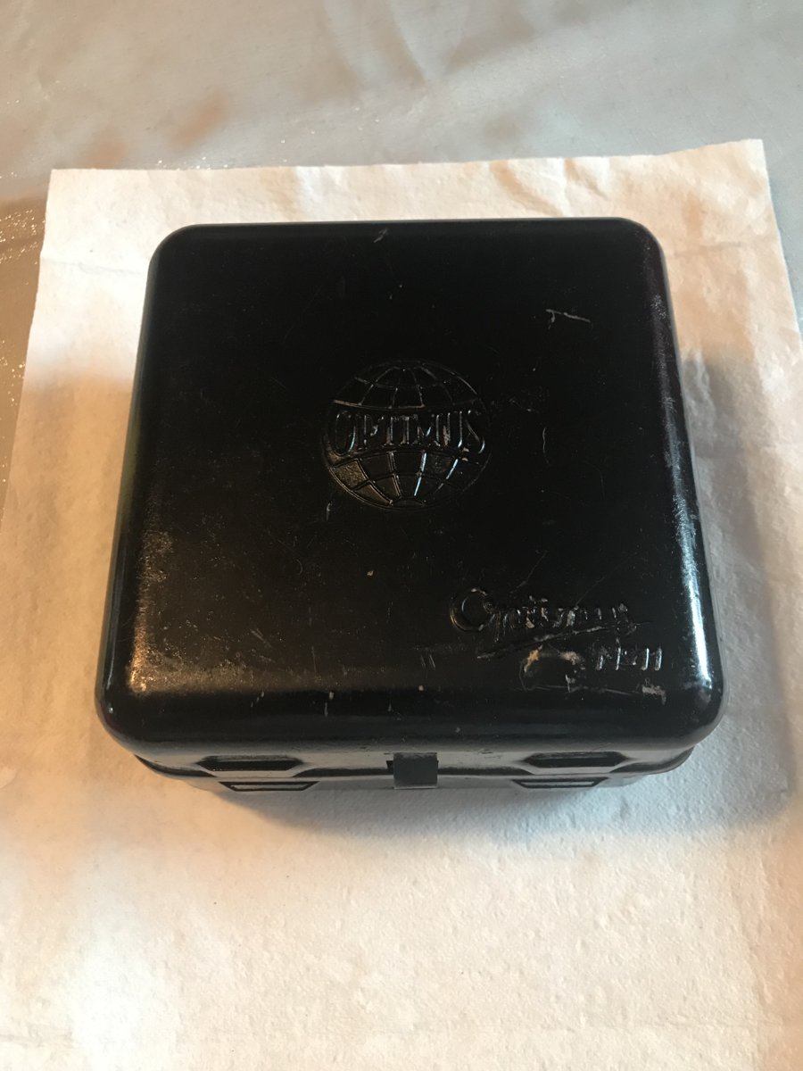

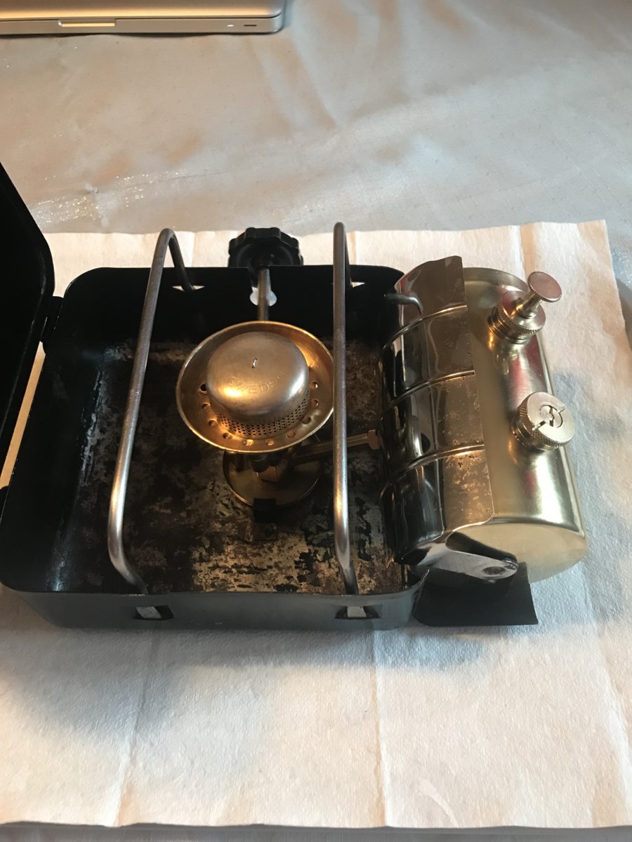

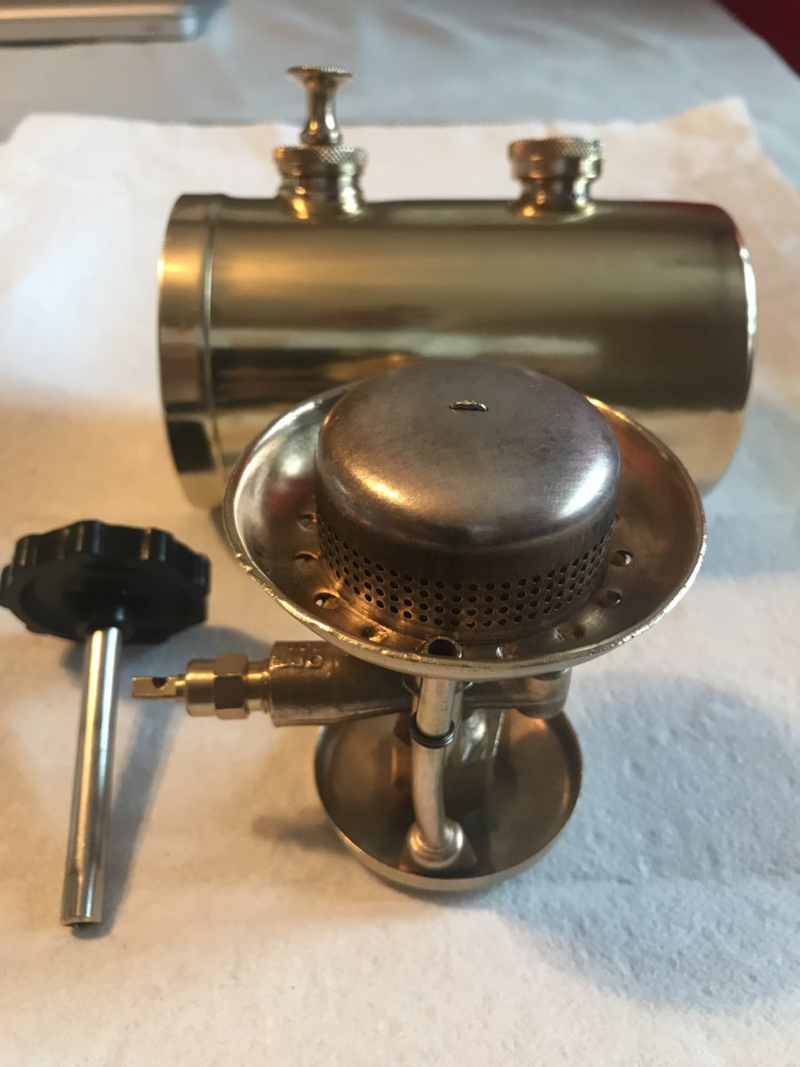

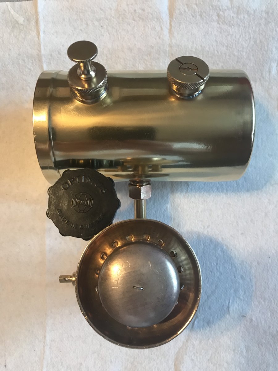

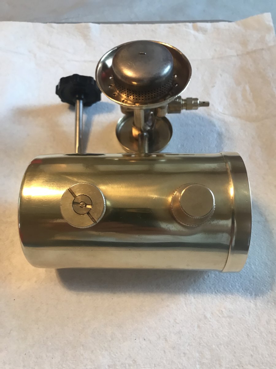

    Hi
    Here’s my Optimus no11 silent burner
    Is this stove run in kerosene, gasoline or alcohol? Any help will be appreciated
    Thank you
    ///Fernando

    White gas or kerosene.
    But, I only use kerosene to be on the safe side.

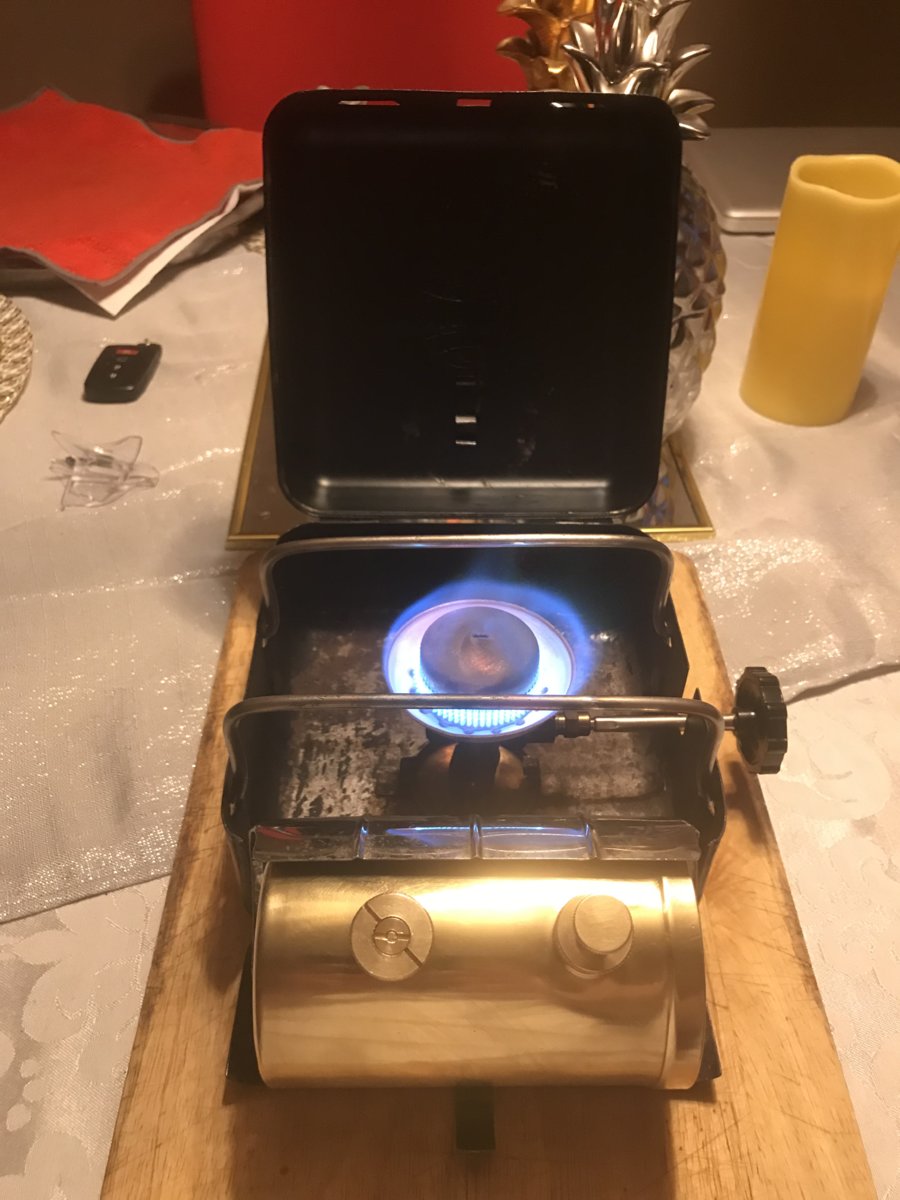

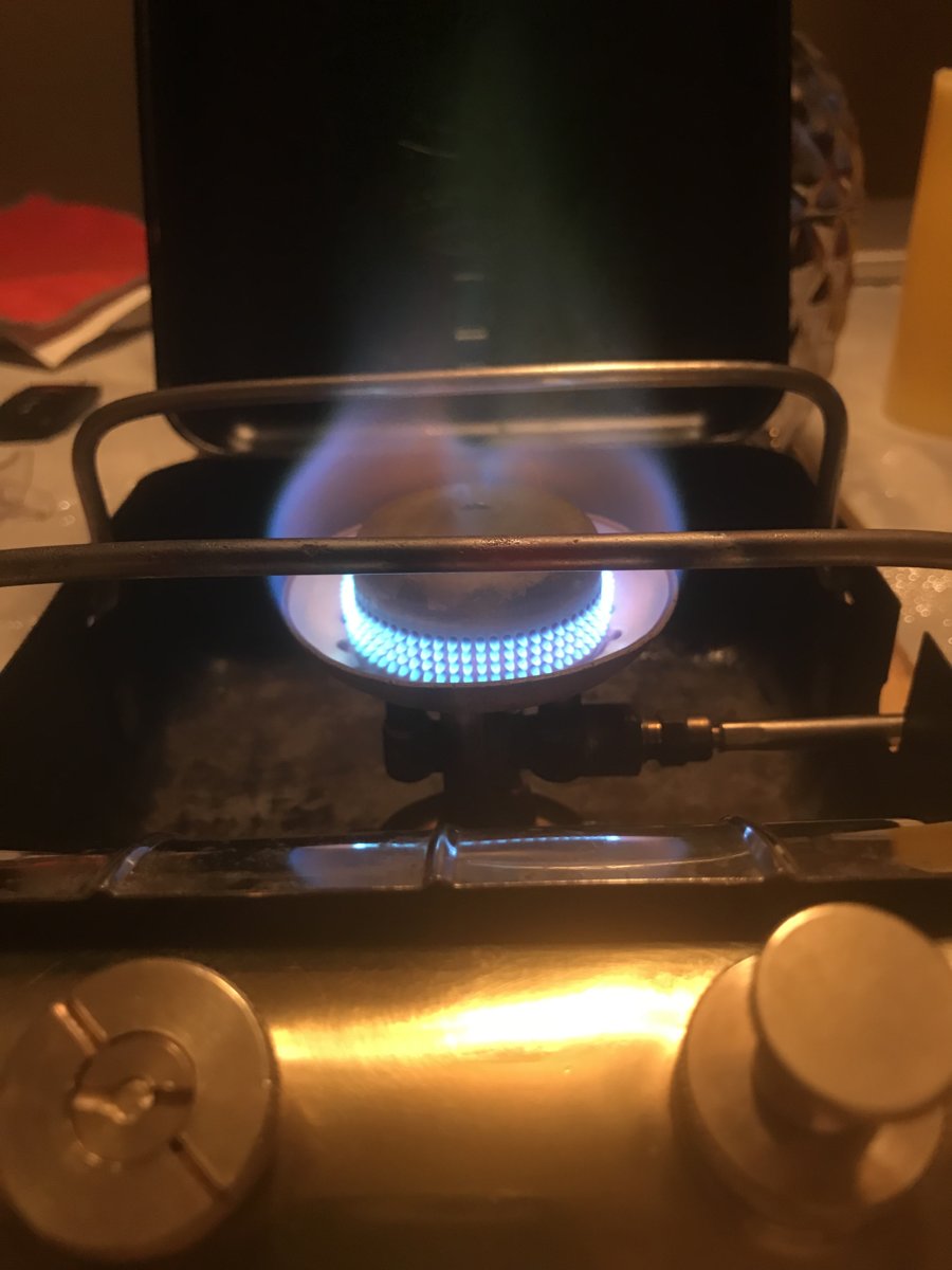

    Thank you
    Here some pictures in action.

    Purty

    Very Very nice.

    Very good recovery work. It uses a kerosene flame to be perfect, although it can also use gasoline, but considering it is a tin-welded tank, it is safer to use kerosene. thank you for your sharing
  7. kerophile
    12,574
    Hi @anfeng you make an interesting observation about “soft”, lead-based solder being used in the manufacture of the Op.11 stove tank.
    I believe that in the production of the later Op.111 stove tanks Optimus used lead based solder for kerosene fuelled stove tanks, and hard , copper-based braze for the tanks of gasoline/Coleman Fuel stoves:
