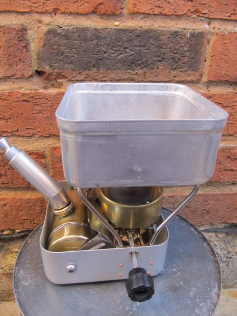

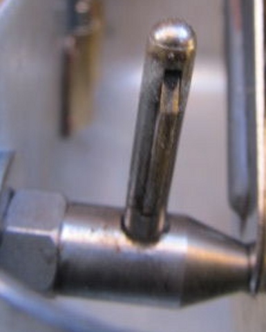

    Everything about this 199, is the same as in the reference library, apart from the riveted plate to hold the legs, and the control spindle and spindle holder.
    Does anyone know anything about this variant on the case ?
    1319893491-IMG_3100_opt.jpg 1319893520-IMG_3102_opt.jpg 1319893539-IMG_3101_opt.jpg 1319893564-IMG_3103_opt.jpg 1319893584-IMG_3105_opt.jpg 1319893605-IMG_3106_opt.jpg 1319893632-IMG_3107_opt.jpg 1319893679-IMG_3108_opt.jpg

    Congratulations on a nice find!
    I have to say, Iani, it look a bit homemade to me, albeit very nicely carried out.
    I doubt optimus would have used copper rivets together with aluminium, and that internal-hex that hold the tank also feels out of place, since it would need special tools in the field for dismantling the stove.
    Someone else might prove me wrong, but even if I'm right, it's still a very nice stove! The "parking place" for the control knob is a nice touch.

    Iani, I have never seen one like this before, it may be either a one off or someone took a 199 & improved what they felt were its weaknesses.
    Either way it looks very well done!

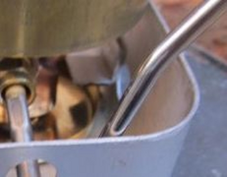

    That last picture changes things a little, Iani!
    I'm with BigBTU then. The weakness Riddarn pointed out could be one reason for modding the stove, and I'm thinking the previous owner maybe lost a X-style pot support and opted for the wires instead.
    The galvanic problem of the copper rivets isn't a big one, just keep an eye out for corrosion. If it occurs, just drill them out and use aluminium pop rivets instead.

    hi there
    it looks a very well thought out stove all the crappy bits about the 199 seem to have been sorted out on yours
    the normal alloy tank retainers weren't up to it as they worked loose if transported roughly ie bike saddlebag
    the key as mentioned can be a pain to use i used a 111 spindle but yours is a much neater idea also the key is of limited use on a 199 you still need a separate tool to change jets
    the slots in the 199 case for the pot legs don't look as strong as your riveted type plus yours can be drilled and replaced
    you didn't mention it but yours has a bracket to hold the spirit cup/burner in situ mine didn't just 2 small dimples in a bit of bent alloy holding that gert burner and tank
    also yours has a hole in the case to light the prime i haven't seen that before or the spirit cup bracket on a 199 you can see them in the cropped bit
    how is the spirit cup bracket fitted to the case? more rivets or a weld?
    all those little practical mods on one stove that still looks new make me think custom built or built to specific order probably military like the army No7 was for the MOD or the curly 111c cobra burner in the norg111 though i have nothing to back that up
    if they had made the fuel cap captive like on the Swedish mill 111 and chained the control knob it would be pretty much perfect..........well i suppose a 111 roarer in there and a nickel tank :whistle:
    nice stove good luck on the hunt for more info

    i just noticed the biggest mod and it had gone right by me till now ](*,) how the bloody hell have they got the burner in the centre of the case and central under the potstands? 199's don't do that the burner is way off to the left

    So perhaps pysen78 could help putting a picture on of the bottom section of the inner case, of his stove.
    The only reason I can see it being off centre to the left is that there are so many odds and sods to go into the case, not an easy bugger to pack.

    on yours the burner appears central to the case and if you look at the burner in relation to the tank yours isn't as far to the left
    it doesn't seem to protrude past the left of the tank on my old one the tank is way off
    Bryans burner to the left
    and another from the ref gal
    the burner might be an illusion only better/more pics will tell but all the other features on yours are pretty unique
    prime hole
    burner spirit cup bracket
    riveted pot holders
    the tank mounts
    and the spindle and spindle holder
    also on the spindle holder is that a spring loaded retainer?
    the more i look at it the more details i seem to notice, i still think military who else could afford to pay for all those extra's (think army no12 or the centerforge for army extravagance}
    it would be an awesome stove for a Swiss mountain trooper or one of the Swiss army mountain bike units powerful quiet easy to transport and with all those mods very rugged
    all that work and beefing the stove up isn't imo natural stove evolution it looks more like it has been beefed up for a specific purpose
