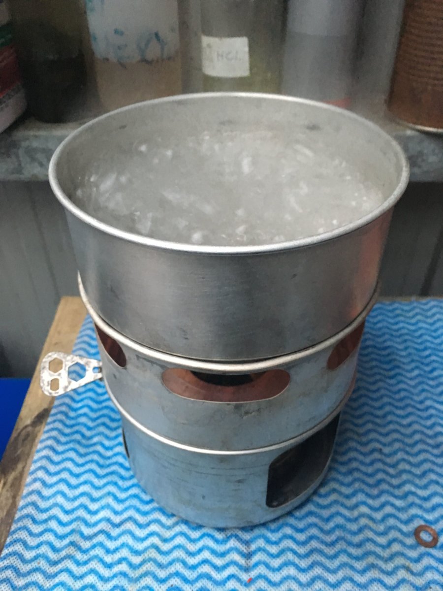

    Here is an Optimus No. 88 I picked up. Even though it is incomplete I thought it worthwhile, seeing they are as rare as hen's teeth in Australia.
    The (incomplete) windshield/pot stand and cook set.
    First in pack-up configuration:
    Then the aluminium:
    This is the Svea 123R stove with the kit:
    NOTE the marks of the stove clip that holds the stove to the base.
    I left this on.
    This is the box (the top was long gone):
    Here it is up and running:
    Starting.
    First boil.
    No soot!
    Second boil.
    No soot!
    I did the minimal fettle on this stove. It had been roughly cleaned before I bought it so I replaced the washer in the filler cap and the pip in the SRV (The Fettle Box). I soaked the tank and burner tube in acetone. That's all.
    I'll try to find a pot and/or lid to complete this set, because its a very good size for one-person bushwalking. It will he a user.

    @Tony Press That's a very functional piece of kit. The marks left by the retaining clip just show that the stove is original to the kit. Someone's made a lot of use of it.
    Looks like you left the control key fitted. Did it stay cool or were you wearing gloves? There's plenty of warnings on this site about burnt thumbs. I don't want to find out the hard way should I ever get lucky enough to own an 88 (or Sigg Tourist) set.

    You noticed!
    I was surprised at how ‘cool’ the key was. Maybe all the aluminium of the 88 takes the heat from the key.

    On my 123R, I always left the key in place, it has never been too hot to touch.
    But the key of my 123 becomes hot, so it is best to take it off.
    I do not have the 88-cookset, so I do not know if that makes any difference.
