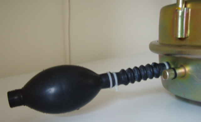

    Here's the unconventional pump and pressure release. The point of the pump is that it can be used whilst a pot is on the stove without any risk of the pot becoming dislodged and distributing it's hot contents as might be the case with a conventional pump rod arrangement.

    It works very well with a strong and controllable flame. The pump is quite effective and whilst bulky requires significantly less effort to use than a conventional pump.

    Interesting stove. Good to see the innovations. The pump however is going back to the early days!

    Looks like a squeeze bulb from an outboard motor :shock:
