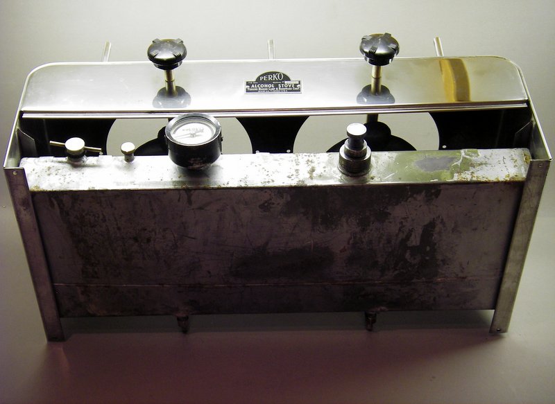

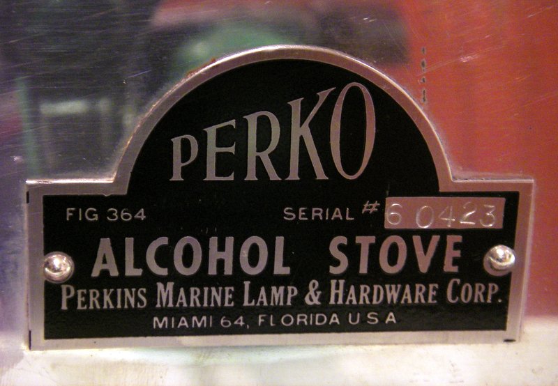

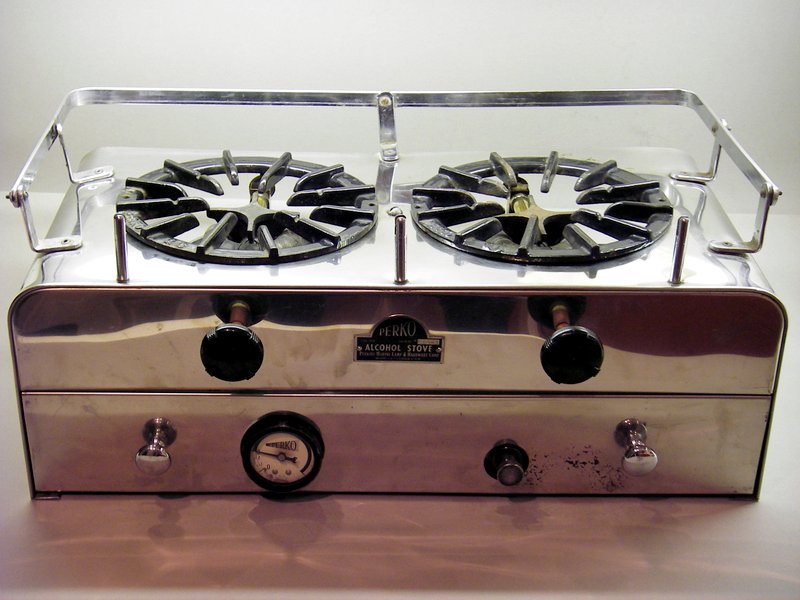

    An unexpected find over here in the UK, a Perko alcohol-fuelled marine stove
    I emailed BernieDawg for anything he might know about the marque and he put me onto Alexander, who very kindly sent me some extracts from a Perko catalogue dating from 1949. Many thanks Alexander and BD
    1384293545-2.jpg 1384293554-3.jpg 1384293563-4.jpg 1384293574-5.jpg 1384293582-6.jpg 1384293597-7.JPG 1384293610-8.JPG
    Without sight of the stove specification from that catalogue I'd have assumed that the stove outer skin is stainless steel, but it's not, it's made of monel metal, an alloy of nickel (typically 67%) and copper. Monel has quite a list of applications to its credit, including the frames and skin of the North American X-15 rocket plane that made such an enormous contribution to the development of NASA space programme.

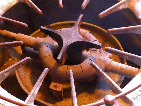

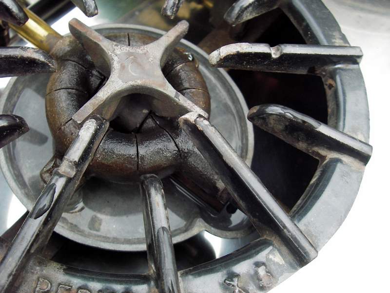

    Checking out the burners ...
    ... one of which required a repair, the fuel injector jet missing, which I'd to fabricate and silbraze in place
    The scale of the burners and stove can be judged from this comparison of a Perko burner with a Phoebus alcohol stove
    The Perko burners incorporate a brass wire brush in the fuel supply tube that slows down the fuel flow at the burner as an aid to vapourisation

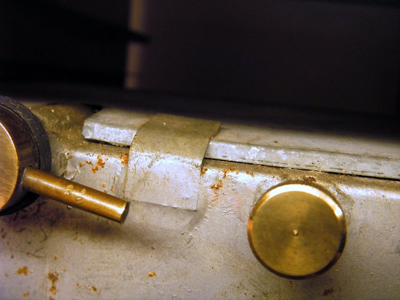

    Pressurised fuel is fed from a large rectangular tank (a gallon capacity evidently) beneath the burners and isolated from the heat with a panel of asbestos clipped to the top surface of the tank
    MORE TO FOLLOW

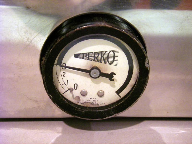

    The stove passed the pressure test once seals had been replaced, with no needle creep at 3psi

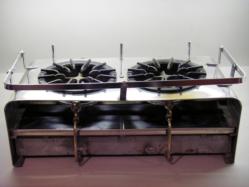

    Here's the splash tray partly withdrawn

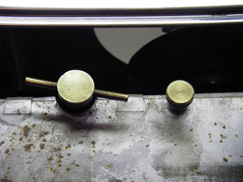

    Fuel filler cap on the left, air screw (pressure release) on the right
    Detail of the asbestos heat insulation clipped to the top of the fuel tank
    View with the splash tray removed

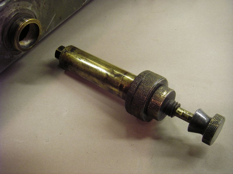

    Pump in situ ...
    ... and removed

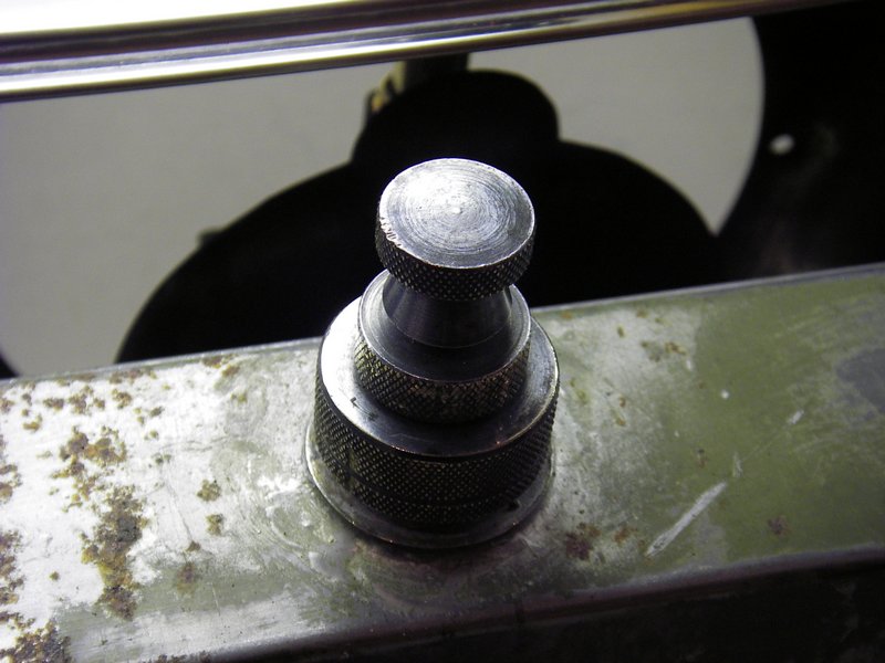

    One of the control knobs

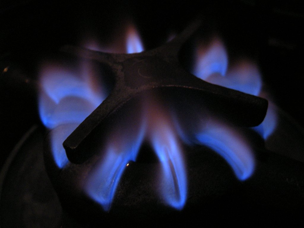

    Got a flame at the burners

    That is one outstanding stove, and as usual, your detailed work is brilliant!! It's also interesting to me to see the burner which was used on your Perko. It looks almost identical to the one on a Landers, Frary, and Clark Universal #110 Meths stove I've had for many years. Here are a few pics, so you can see the family resemblance between our two stoves:
    Don't you think they look like they came from the same Mom and Dad? I am now looking at my LF&C, and wondering if I might be able to cobble together a pressurized Meths Frankenstove out of it!! :-k :-k :idea: :idea: :D :D Thanks, again, John, for the wonderful report and photos. Great work, always! God Bless!

    You know, I've read the account you posted HERE about your stove before now Doc, but hadn't made the connection with the burner type, which I agree is surely from the same manufacturer.
    I shouldn't be surprised, because there are parallels with other spheres of manufacturing from that sort of era, such as the way Villiers engines found their way into the frames of umpteen motorcycle marques.
    It must have made commercial sense to buy in a more complex component (burner, engine) and save on the cost of development, tooling up and manufacture of your own design, particularly when - as with Perko evidently - a wide range of products were marketed under the label.
    Thanks for that, Doc - very well spotted!

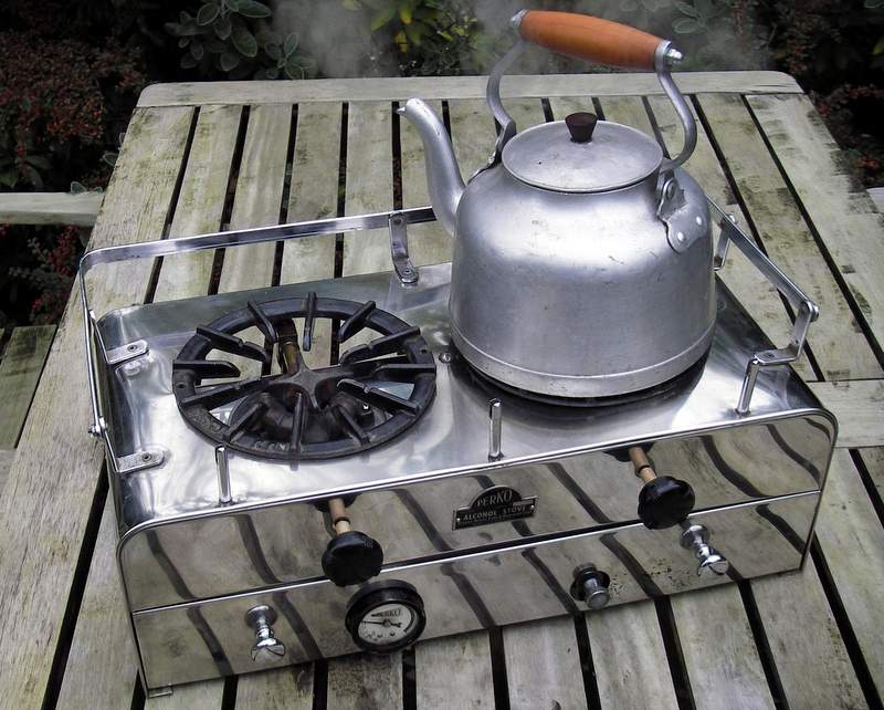

    Got a bit more output out of the stove burners tonight, the result of judicious application of an airline.
    It's possible now to get the flame to lift off when the control valve's opened up that bit more. Heat output is colossal considering it's meths fuelled

    9,770
    Methanol the fuel (used up what's left of Big Si's gift of a gallon of the stuff at Newark).
    Tank pressurised, burner control valve opened, primer cup charged ...
    ... probably a bit too much if anything, though there's a lot of bronze in the burner to get up to vapourisation temperature
    I've a Homestrand Mariner to compare it with and I'd say subjectively that the Perko puts out more heat on full power.
    Given the thirst that must go with the output, the gallon capacity fuel tank is probably worth having, expecially since somewhere short of maximum output would be more usual, with correspondingly moderate fuel consumption and long refilling intervals
