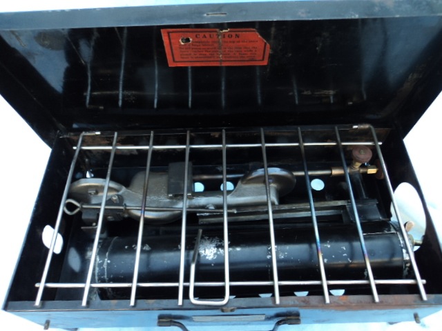

    Prentiss Wabers Model 405 stove made at least 1936.
    While it is not shown in the main PW '36 catalogue, I have a supplemental brochure that came with the catalogue that shows this stove only. It was a new model introduced during the production year. What is unusual about this stove is that PW painted it black and not the usual green. In fact, 1921 was the last time PW painted their stoves black. This stove also has no wind wings and while PW continued to make the burner manifold assembly mounted with the fuel tank as one unit, as was their practice for the previous years since 1925, PW designed this so the burner assembly slides into the stove from a large opening on the right side of the stove body, along a guide, which is on the inside bottom of the stove with the burner assembly having a counterpart guide that overlaps the stove guide and the fuel tank goes underneath the stove body itself.
    Removal of the generator requires one to loosen a square nut placed underneath the main burner, then one slides the burner assembly back about 1/2". Then one can turn the generator/fuel valve away at an angle so as to permit removal of the burner assembly. Re-assembly is the reverse. The fuel valve itself is screwed on to a pipe nipple, which extends up from the tank about 3 inches or so. As you can imagine, the fuel pickup tube is rather long.
    Why Prentiss Wabers designed it this way is unknown. But when one looks at the stove itself, it appears that this stove was designed to be an entry level model for the budget minded camper or for those who want a basic stove for picnics. Nothing fancy about it like its stablemates.
    While I knew this stove model existed, this is the first one I have ever seen or come across. Of course, there may be others out there but they have yet to surface. I know the 400 series of stoves do come up on eBay(Models 401, 408, 409 & 412) but this model would appear to be one vary rare later model stove.
    Paint is original to the stove. No re-painting has been done. Just a cleaning and polish of the stove body & fuel tank paint with the burner assembly and wire grate undergoing a thorough cleaning.
    Photos:
    On behalf of Joe, many thanks for looking at this old Prentiss Waber #405!

    Hey Doc, another odd design by PB, glad you helped out Joe posting the pictures. Seems to me the PW's are more subtle as far a the flames are concerned or perhaps because they are silent burners. It looks to me in very good condition :thumbup:

    Hi Doc, Thanks for posting this. Nice to see the stoves brought back to life. Really the paint on the tank and box are in very good condition for its age and rareity.

    Actual paint in person is not as nice as in the pictures. Lots of scratches, etc but most of the paint is intact. But this is one stove that will not receive a complete restoration to its paint. I felt it was better off in a "as found" condition.

    Hi Doc and Joe what a very nice, PW suitcase stove it realy looks a head of it's time.
    And in realy nice condition, even with the few scratches, and as you mention it looks better in the photo's, i can understand you not wanting to cary out a full restoration, keeping the paint work in original condition.lokking at the pics of the burner and grill i dont think it has been used much,unless these parts have been replaced at some time.
    Your 405 realy does give a great flame in fact it looks like a modern gasie flame pattern,a great addition to your collection,and will be perfect for a family camp

    Actually, the burner parts are original to the stove and it did see a lot of use. It's the cleaning solution I used that got it to clean up as well as it did, along with fine steel wool. What little didn't come off, I used a wire wheel. Same with the wire grate. This stuff much like as if I used electrolysys.

    A very interesting stove. You can always count on Prentiss Wabers to come up with some interesting designs.
    This stove is quite far and away different from any of the designs that most stove manufacturers were using at that time. They were radical thinkers to come up with something like this. Another one that I can think of is this one in the SRG:
