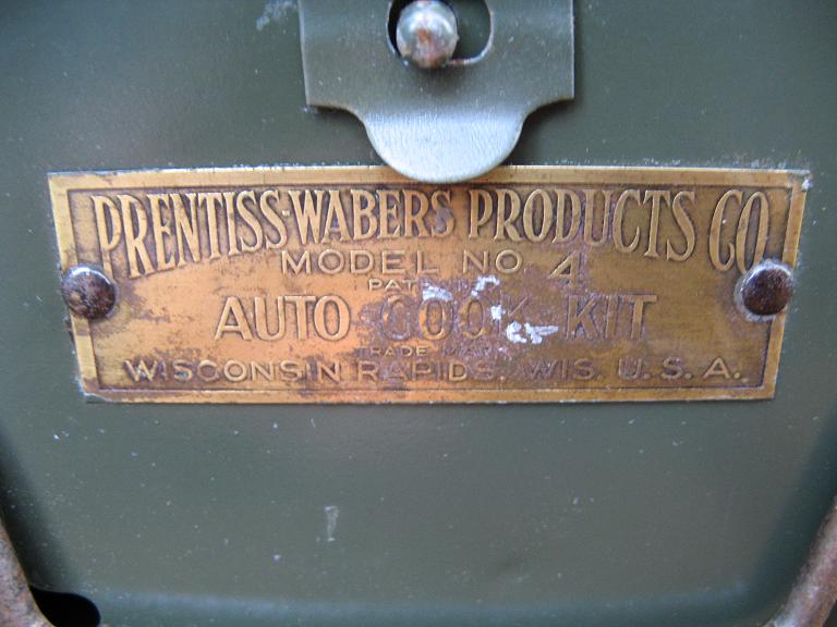

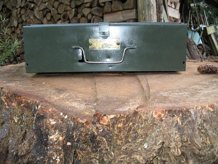

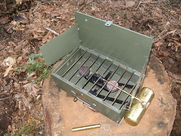

    This is another P-W from the 20's (I'm pretty sure, it's not in front of me to check). It's was previously re-painted before I got it and the only thing I've yet to fix on it is the generator. Other than that, it's a very nice unit that works, just not well, haha. Hope you enjoy the pics. Edit: I noticed that I forget to put the legs on it so it stands up, but they're there too.

    Hi VDC, nice looking stove - has the same burner manifold as my P/W 8, with pre-heat cup and sliding baffle to control aux . burner . Also the pre-heat system is cool ! I checked on Terry Marsh's site:
    http://terrence.marsh.faculty.noctrl.edu/lantern/stovepz.html
    and they have a #4 pictured
    Would be nice to see some pics of it running ?
    You can use a rifle cleaning kit to clean out generator - I think the .273, .243 caliber brushes should be about right for this gen. ? But check to be sure

    As pretty as she is, the needle at the end of the generator is broken and MIA. I might rob a generator out of another stove, but that'd leave that one non-working too. Maybe I'll find a way to adapt a coleman generator to it. More stove pics are on the way, had to stop for the night last night as I get up at 1 am for work.

    Hi Voo Doo, I believe in my post about my P/W 8 I was told you could adopt a coleman 425 generator
    "can tell you that the generator can be replaced with one from a Coleman 425. There is some minor modifying to get it to work, but it ain't much"
    This quote is from "bikamper" so email him for specifics Cheers Tom

    Did you get it to burn yet? I read you talk about the needle being broken and using a 425 needle as replacement. The needle on mine broke also and I used a 425 needle and it works pretty good. It looks like mine broke because of a slightly bent generator tube, which causes the needle tip to rotate at an eccentric and get bound up at the gas tip. I had to scavenge it from both of my 425 ( I broke the replacement also) but you can order just the needle online. The threads don't match so I had to solder it on.
