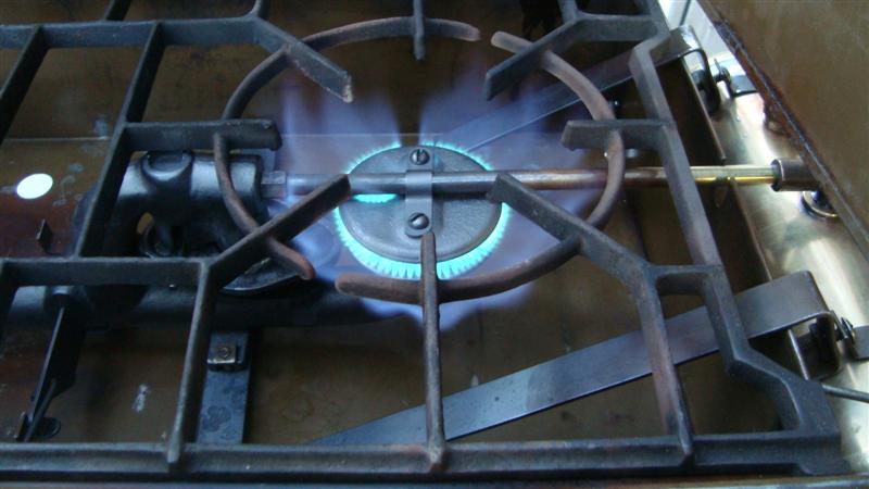

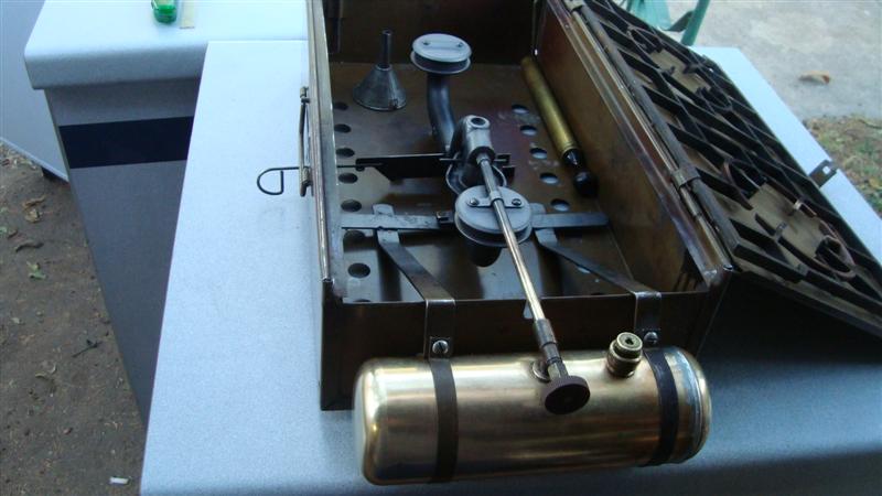

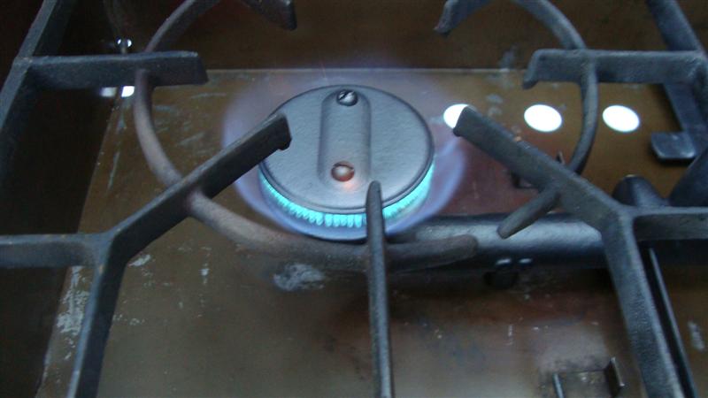

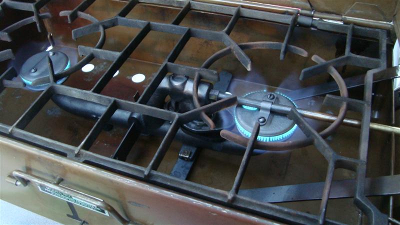

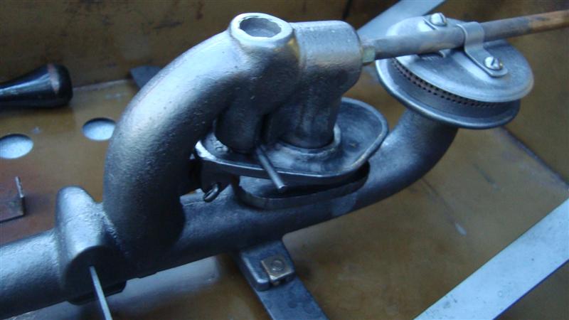

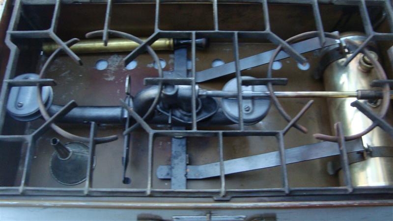

    Got this in yesterday and it was today's project. I didn't see this model anywhere, so thought I'd add it. I know someone was putting together a P/W list, so I hope this helps. I don't know what year this was made.
    The Tank was a mess. Huge gobs of solder from a previous unsuccessful repair attempt. Heated it up, got the end cap off, cleaned it up and resoldered it. Had to braze the support bracket on the bottom as well. Cleaned the generator and burners.
    These were very well built units.
    After the burner cleaning, I decided to try something different. I used spray graphite on it, and am so far very pleased with it. It's a very volatile spray that dries very quickly. Looks pretty good too. Not sure how it will hold up, but we'll see.

    I just hit the case with some 409(spray cleaner) and a rag. Gave the tank a vinegar bath while it was apart and hit it with some fine steel wool under running water afterward. The generator(brass) was solidly packed with carbon and even several heat/quench cycles and heat/compressed air didn't clear it. I got hold of the spring coil and just yanked it out along with about a pound of carbon. Had an old coil from a Coleman 425 that fit perfectly. The cast iron grate is as found, haven't messed with it and may not.
    Unfortunately, the seller did a horrible job packing it(1 layer of bubble wrap under brown paper) and one of the retainer tabs on the bottom of the cast broke off en route. A testament to how solid this thing is. It's very heavy too. I'll braze that tab if I paint the case, but don't want to burn the existing paint as it's in pretty good condition for its age.
    The pump works beautifully too. So I'm happy with it.

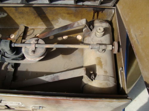

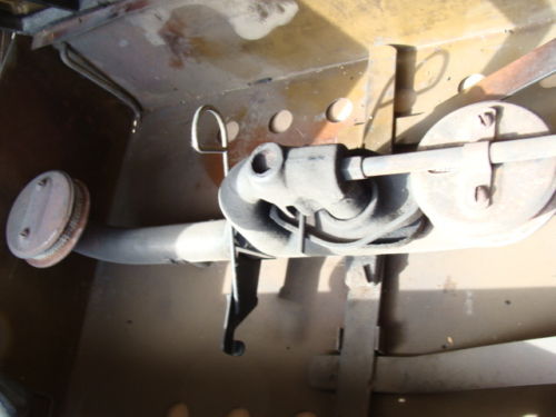

    The valve on these is a bit odd to me. The spindle just threads right through the packing. Unless I'm missing something, that is.
    Here are some before pics.
    1288405437-Before_1.JPG 1288405446-Before_2.JPG 1288405455-Before_3.JPG 1288405464-Before_4.JPG
    I wish I'd taken some pics of the tank in detail before I worked on it. It had about an eight inch of solder gobbed on the bottom half of the end cap joint. Looked like a solder bird crapped on it for a week. And it still leaked. Good to go now though.
    Is there a good way to remove the solder tinning that remains from that debacle?
    Mike

  10. kerophile
    11,619
    Hi Sergeant, The best way to remove solder "tinning" is to use a mild abrasive, wet and dry, paper such as #600 or finer. The tinned layer should be very thin, so material loss is minimal.
    Krophile.
  11. toonsgt
    Oct 23, 2005
    934
    Thanks Kerophile,
    I have some of that and some 1000 and finer wet/dry. I did a pretty decent job of wiping it with my leather glove while it was hot so it shouldn't take too long. It's thin enough that you can't detect it by feel. The inside of the tank was immaculate after the vinegar bath. Just some varnish deposits from old gasoline that wiped right off. The original solder line was only about 1/16 into the joint, so I see why it was leaking.
