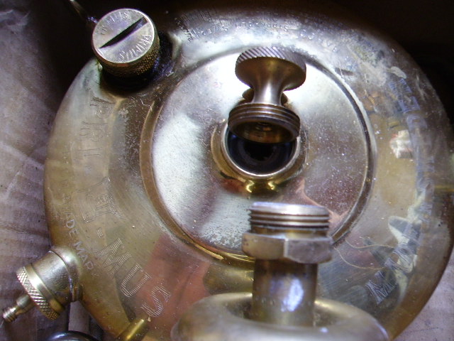

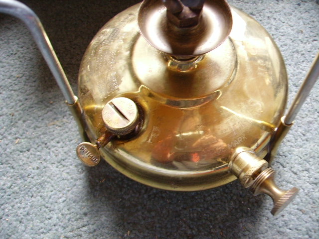

    Date unknown .. But similar to Georges 100's 1961 ,1962 .
    The 4128 designation is for the roarer burner .. although in the plastic bag is a lipstick burner and components .

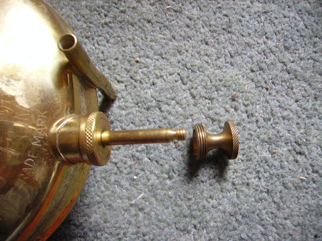

    Noting the travel cap which doubles as pump knob .
    Very light engraving on the tank ... but sharp & uniform .

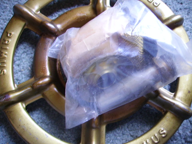

    Very tidy example. I guess the lipstick and bits were added sometime after purchase. Can't really see from the pictures but is the burner bell and plate also included or just the lipstick, spirit cup and filter? Some useful spares if nothing else!

    In the bag are :- lipstick , burner bell , spirit cup , gauze , silent cap and cast roarer plate .
    The lipstick burner in either silent or roarer mode is not as powerful as the 4128/4138 multi tube burners .

    Very nice outfit Nick. And with a choice of burners, too! :clap:
    I find the use of the pump knob for the reserve cap especially nice. It looks so elegant when in it's reserve cap mode.

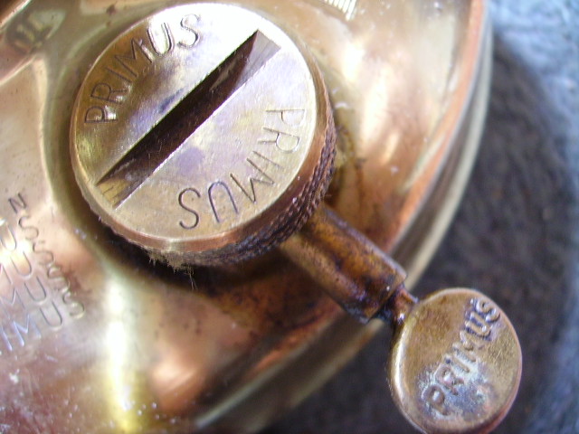

    If the stove was assembled by Bahco it should have a date code either on the rising tube or on a foot. If there is no date code it is more probable that the stove was assembled by Optimus and put out with Bahco labels on it. There definitely were some Optimus assembled Bahco stoves.
    Does the Bahco name appear on the tank? Your photo cuts off short of that printing.
    What markings are there on your vapourising tube, burner head, burner plate and silent damper?

    I can see BAHCO on the 6th image.

    Hi Bryan , I've looked over the stove again and cant find any date markings .. the roarer riser (4128) is marked simply PRIMUS within 2 narrow bands of machining serrations .
    The lipstick burner vapourising tube (1003 burner assembly) is marked SWEDEN on one of the brass hex. flats ... The cast top plate is indent cast Made In Sweden ..poor quality casting .

    Further inspection shows numerical markings on the burner hex. of 466 & 26 on opposite flats .
    NO markings on the tank base & Bahco engraved on the top of the tank .
    The legs are Primus legs...measured on screen against your simple/elegant template .
