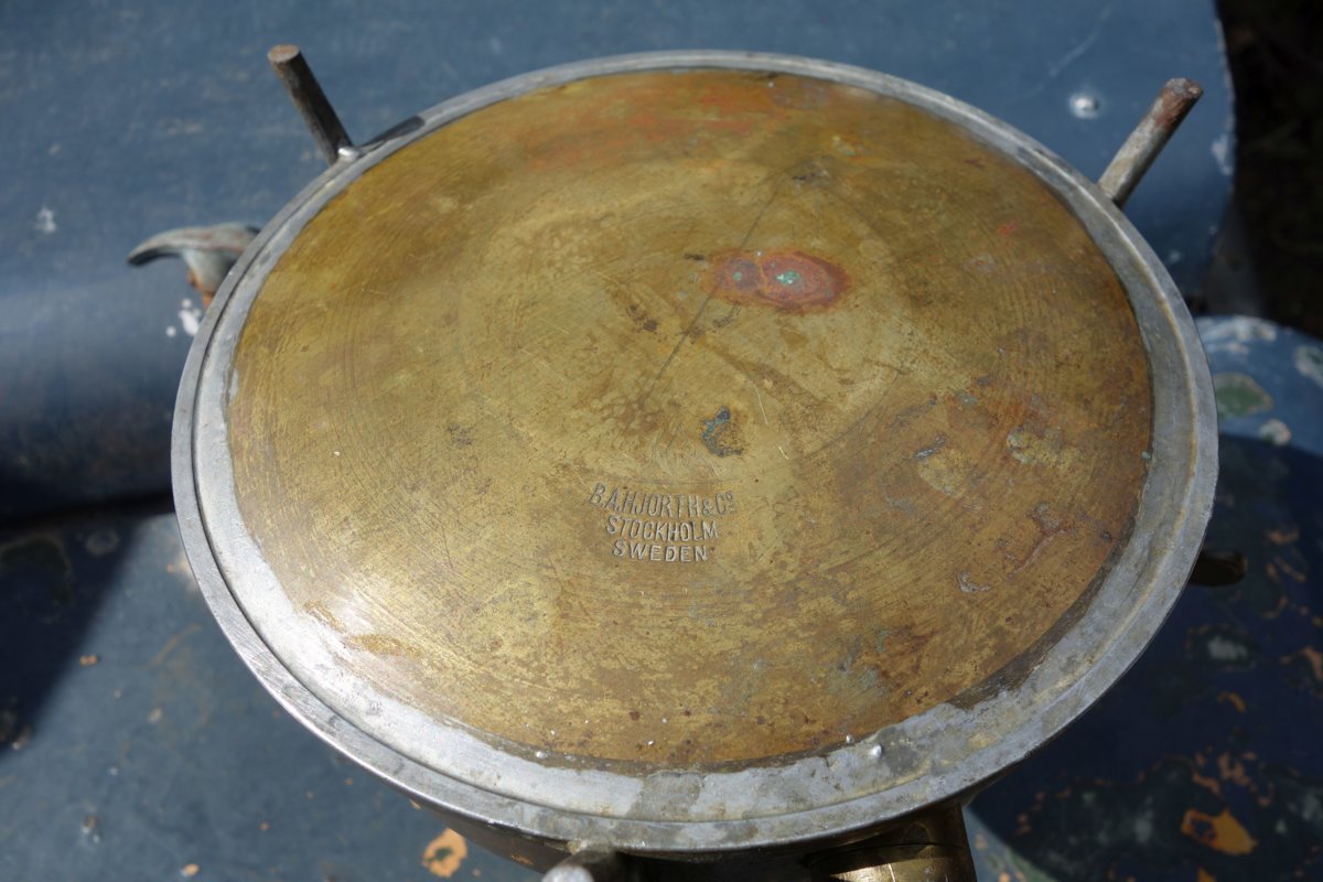

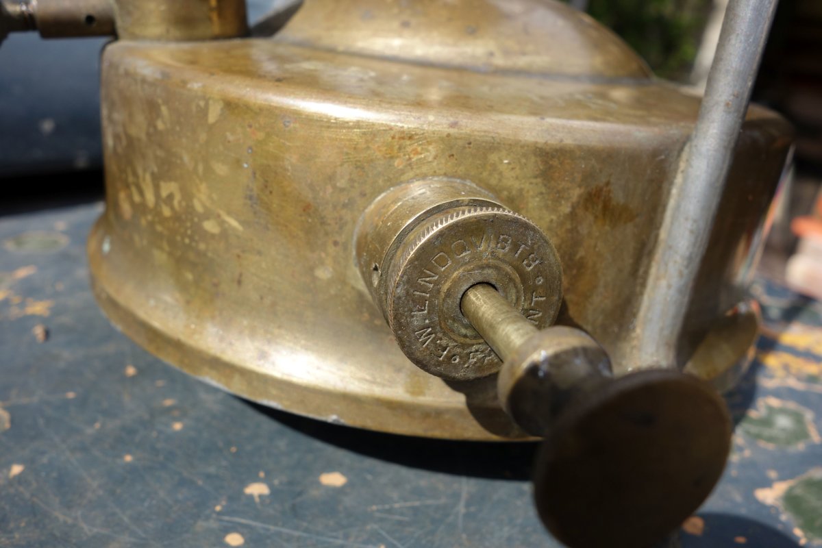

    This old Primus shares almost all of the features seen on the examples from "1892 or earlier '', and on the 1891 illustration in Primus' official history published in 1929. On the other hand it is clearly marked B.A.Hjorth on the filler, the trivet and tank base and so cannot have been produced any earlier than May 1892 when Hjorth took over the marketing of the stoves. The tank base has been spun with a flat central area and has a folded over seam at the sides. The only markings on the base are the Hjorth company mark and a tiny single letter 'Z'. The only markings anywhere else on the stove are the words 'PRIMUS' and 'PATENT ' on the tank top. The removable pump is of the peg spanner installation form which was later replaced by a hexagon fitting type either at the same time, or just before(c/f), the adoption of model numbering sometime in 1894 or '5.

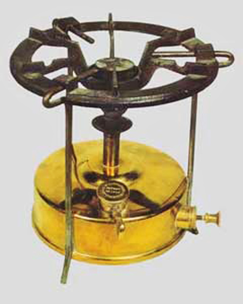

    I have wondered a bit about that myself.
    It started when I saw how large the recessed hole on the supposed flamespreader was on my Victoria with a similar trivet (As you can see in Gieorgijewskis post above).
    And checking those few illustrations from the time show a similar look as yours, giving it all a bit too much space between the burner/vapouriser and the part from the trivet.
    It is hard to tell, but in the dark part between burner and trivet, it has what might look like a regular loose flamespreader too.:-k

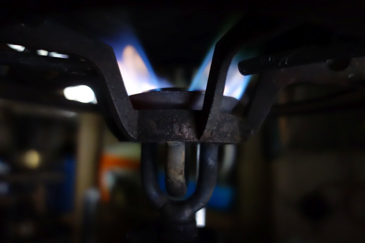

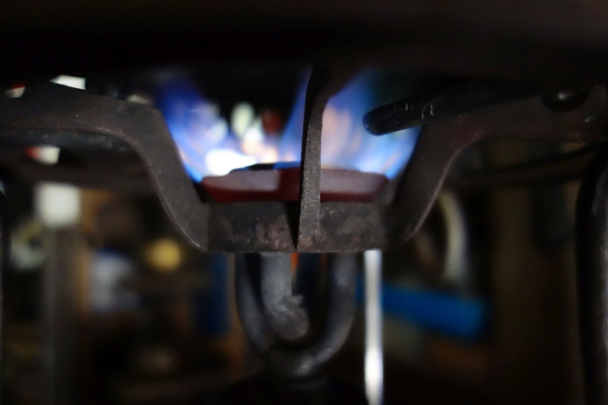

    Will it or won't it? After a week or so of careful treatment to the original pump leather and special NRV cork block, and pricking out the burner too of course ... will it or won't it?
    The first priming and 3 strokes of the pump:
    Ok; so now gently does it[-o<, and the real moment of truth:
    So far so good, the trivet center drop ring is shielded from the flame by the spreader:idea: And the flame is then directed up just inside the open cone left clear by the clever shape of the trivet spokes. So now for a kettle and a bit more welly:
