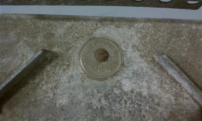

    Any clue what I have? I've read that it was likely a marine stove, designed to burn on alcohol. From the previous owner: "It's an alcohol or "methalated spirit" stove, used frequently on old sailing vessels (I live in an old sea coast town). It's in pretty fair shape, everything is there, including the funnel"
    Worth fixing up as a regular use stove?

    Looks like a 527 to me. Check the listings here at CCS's Stove Reference Gallery and also the catalogs in the Reference Library and see what you think. If a 527, then it's an awesome stove with kerosene and an ok stove with alcohol. It can be set up for either.
    Whoops! Needed to grab my glasses! :oops: Sure enough, it's a 347 in your photo. How about a closeup of the burner(s)? I'll bet they are alcohol-only.
    The date code should be on the front of the tank so you can tell how old it is. Go here for the code translation:
    https://classiccampstoves.com/threads/11464/
    Nice stove.

    OK. Here it is:
    https://classiccampstoves.com/fusion/gallery/1/1210007053-004.jpg
    From the 1952 brochure here at CCS.
    After doing some enlarging of your photos I'd say those do look like alcohol burners. If you don't mind the slower heat times of alcohol, it could be a nice user. Relatively uncommon, I'd guess, so could be a good collector stove as well.

    I did find that it is a 1937, has an AB date code:
