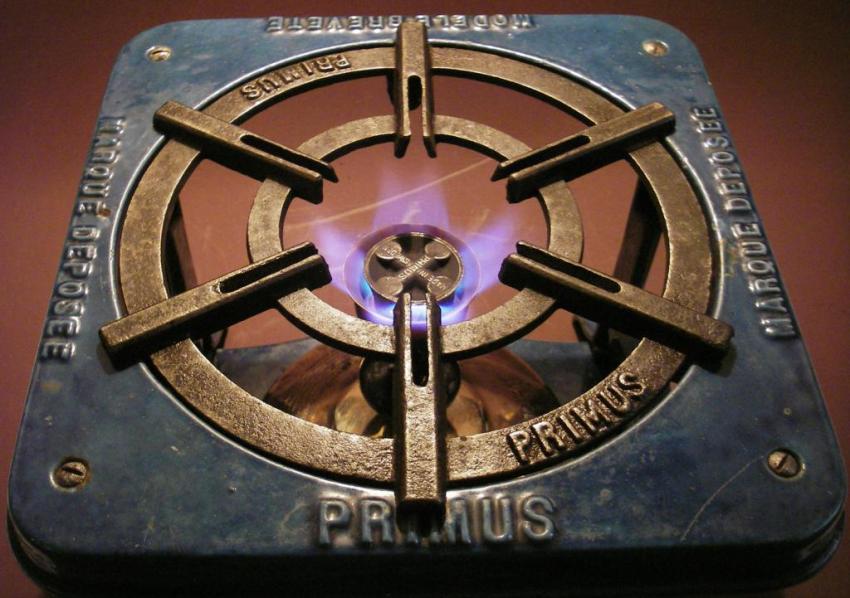

    The designation 51SE is drawn from Kerophile's 1929 Primus, France, catalogue, where it is described (page 2) as a 'special model on cast pedestal' (my rough translation). Specifically, it's a Primus 51 sold with a blue enamelled cast iron stand
    George's catalogue
    Here's the stove and the stand

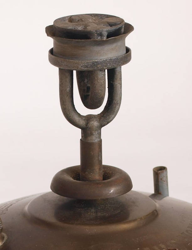

    That model of stove was an economy version, with a Primus 210 sized pump diameter and a roarer burner without the usual separate riser tube or hexagonal mounting flats to take a spanner (wrench). It meant hand-tightening it, though the stove was intended for the kitchen and not as a camping stove to be packed away, so once assembled it could stay that way. The spirit cup too was a different arrangement because of the lack of a separate riser tube

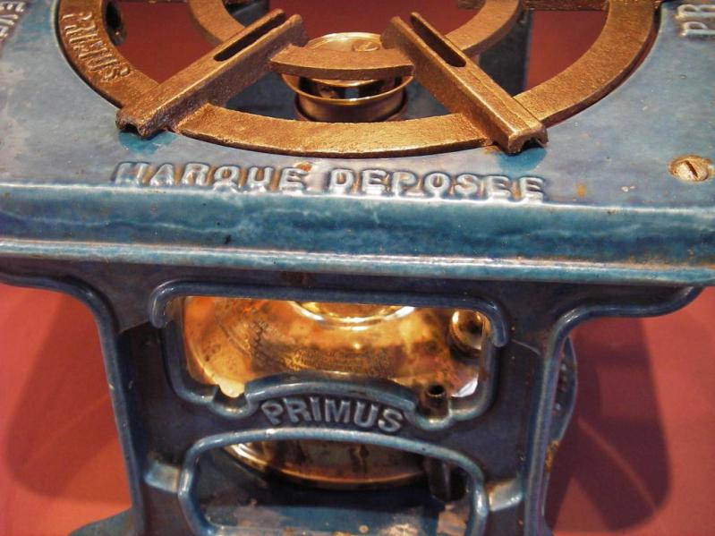

    Back to the enamelled stand, which has some beautiful detailing - Primus, obviously - marque deposee (registered trademark) - modelle brevette (patented design)

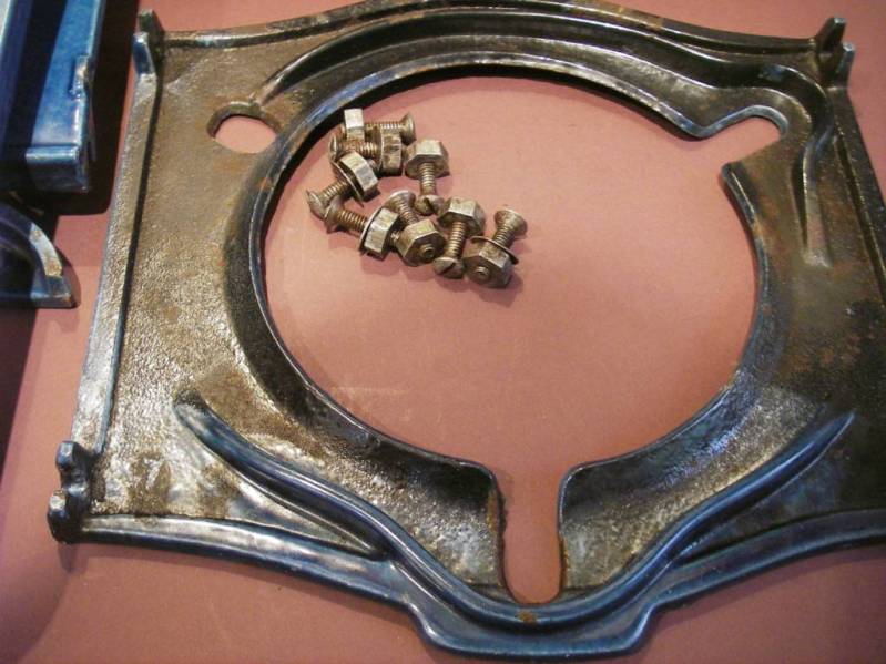

    Eight countersunk headed machine screws, nuts and washers and a clever arrangement of lugs and cast ridges makes for a solid assembly
    1279746287-10.JPG 1279746298-11.JPG 1279746312-12.JPG 1279746327-13.JPG 1279746341-14.JPG

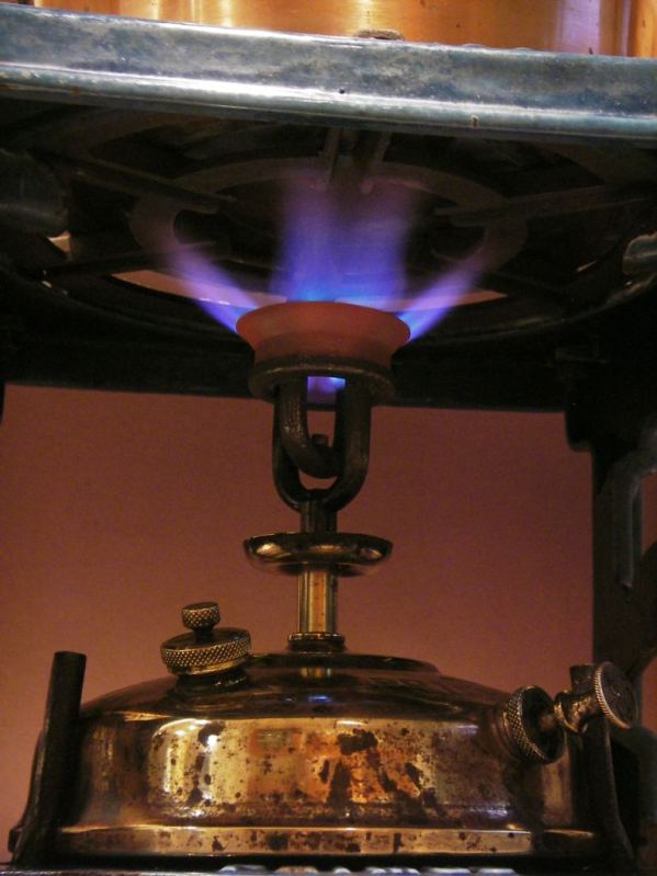

    Stand reassembled, I prime the burner
    'Economy' model maybe, but it fires up beautifully
