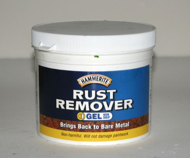

    Hammerite will stop rust and do nothing to the paint.
    But I don't know if it will do something to decal.
    Maybe someone else can answer. @kerophile
