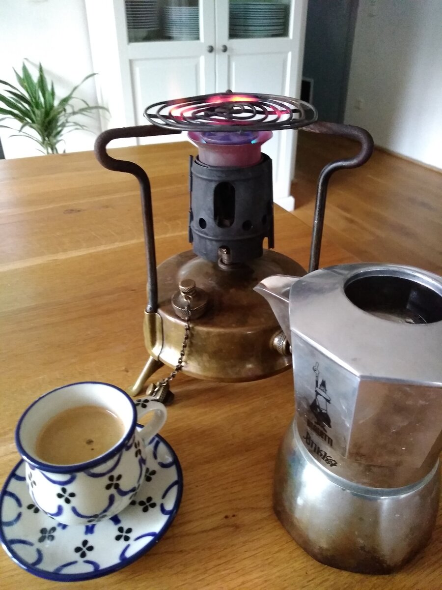

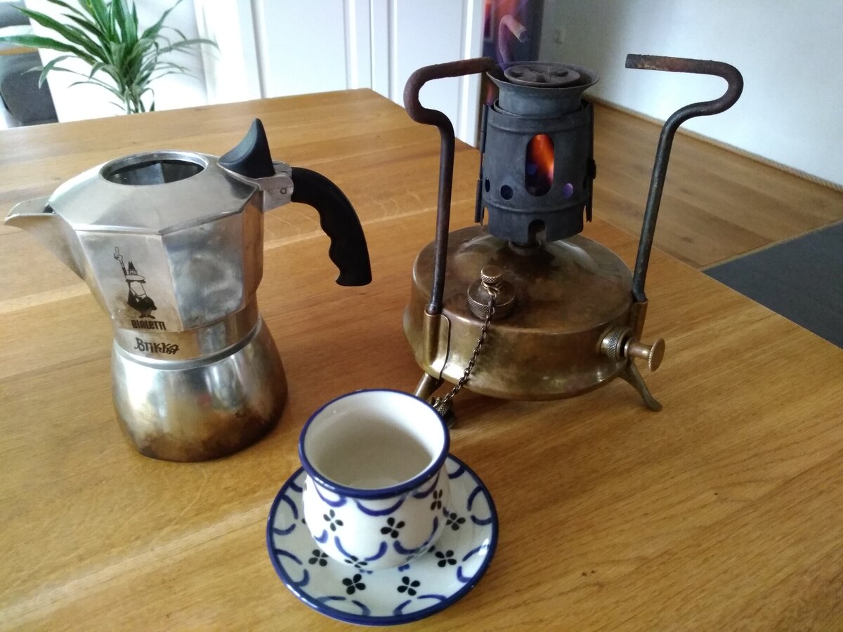

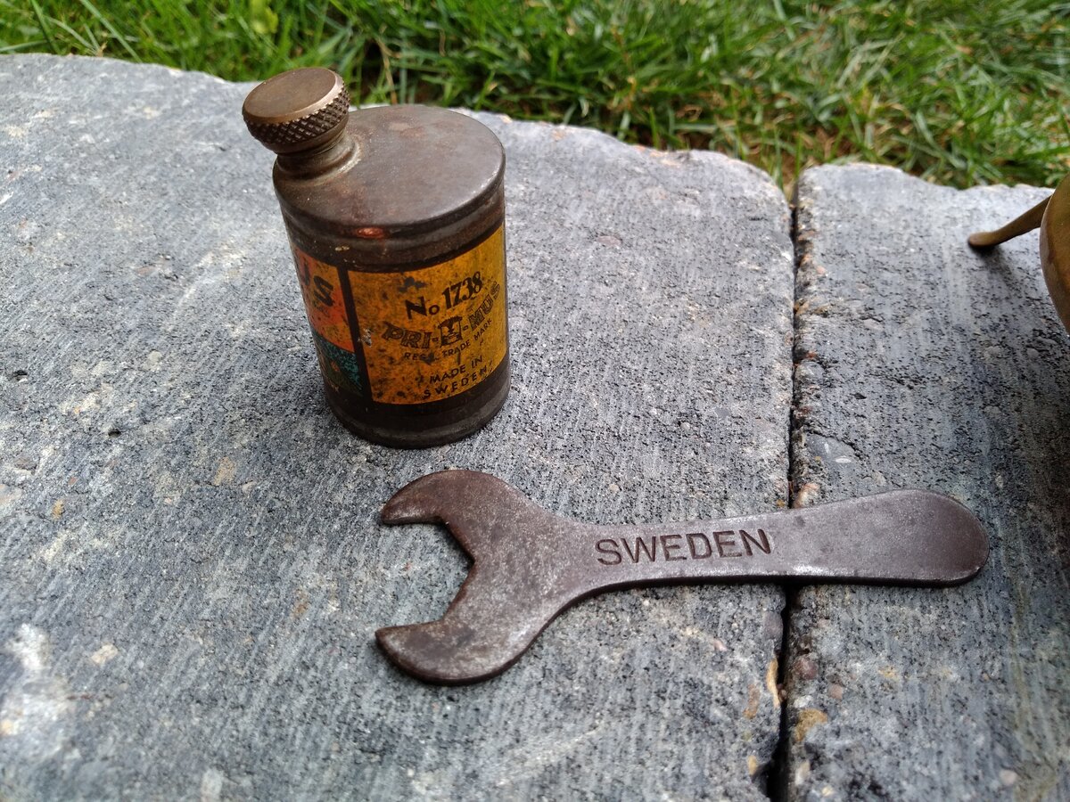

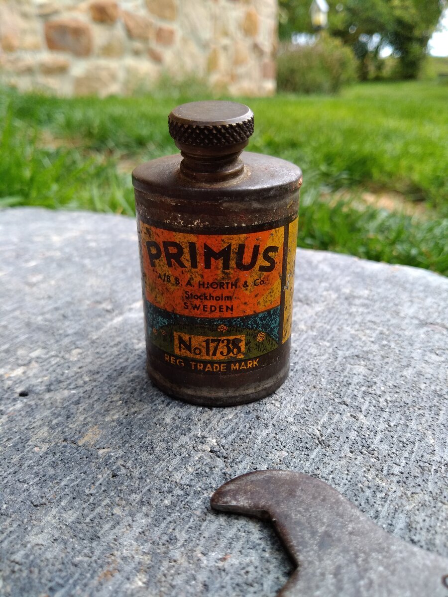

    I ever asked me, why so many people love their 210... now I know! Fascinating cool stoves! I really like them!
    Mine is from 1953, the birth date of my parents and the first succesful ascent of Mt. Everest by Hillary and Norgay. So two further reasons for me to like it ;)

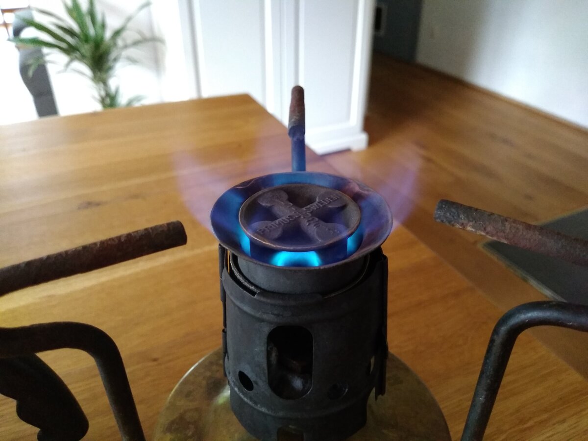

    Mine came in a good shape, instead of the burner (and the tin). It is quite corroded and was leaking at three spots, the seat of the jet and the flame ring holder. I brazed it (my first try with the Rothenberger Superfire 2 and MAPP gas, worked great).
    I changed all rubber and cork parts. The NRV had no lead washer, but I got it easily out with the alternating usage of cooling spray and boiling water and a good fitting NRV tool.
    Ciao, Bastian

    Well done Bastian, perfect kit to get the job done.

    Thanks John, you gave me the perfect advice!!

    Hele mooie brander Bastiaan.ik heb er ook verschillende van die kleine.
    Ik neem der vaak eentje mee op men reizen.
    Goede tip met dat hardsolderen,ik ga het ook eens proberen.
