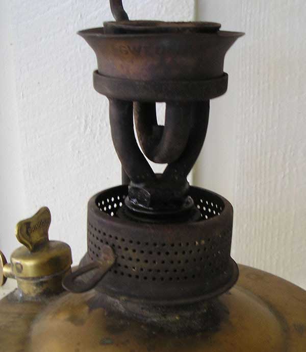

    Hi!
    Just want to add some pictures of my 303 just taken out of my "garage queue" awaiting fettling (no way near Johan's beautiful one).
    The 303 have a very interesting pre-heating arrangement.
    Stefan

  6. hobowonkanobe
    Aug 18, 2004
    1,835
    any one see a preheating arangement like that on any onther stoves? Realy curious lookin.
  7. Locksmith_500
    Feb 10, 2008
    89
    Hello :D
    I just found out that there is a LUX stove using the same type of device
    :shock:
  8. Guzz Denmark
    Nov 29, 2005
    73
    While looking for some other patents I stumbled across the ones for this preheater. The first design was in Swedish patent 33082 from Dec 1910 and an improved design in patent 34321 from Sep 1911.
    Basically it is so that you can preheat with kerosene or use less alcohol if you still preheat with that.
  9. David Shouksmith
    David Shouksmith Subscriber
    Jul 28, 2004
    6,917
    Yes - on the Monitor Regal No. 16. Trevor and I have examples...
    They're also to be found on various Tilley lamps and lanterns, notably the BR49, BR49A and BR49B British Rail(ways) lanterns but also on some of the lifebuoy lamps and some of the earlier lanterns such as the PL54 and PL56...
  10. Spiritburner
    Spiritburner Admin Subscriber
    10,417
    & on some Hasag & Bat stoves
