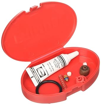

    Fuel line filters are available as spares (or at least they WERE available). Years back Primus retailers had a box that they had all parts as a spare part to sell out individually. Then spare part kits came for sale. Earlier they contained the fuel line filters also (this one is for Omnifuel):
    https://www.subzerostore.co.uk/equi...ice-kit-for-omnifuel-and-multifuel-ex-stoves/
    Current Primus spare parts kits doesn't contain fuel line filters ](*,):
    https://www.primus.eu/store/spare-parts/service-kits-tools/
    Old Primus (Ergo)pump service kit had the fuel filters:
    https://www.amazon.co.uk/Primus-spare-accessories-fuel-pumps/dp/B000XYUOEA
    Current pump service kit doesn't contain fuel line filters:rage: :
    https://www.primus.eu/shop/primus-fuel-pump-service-kit-P721460/
    If you know some local store that has sold Primus stoves for 10-20 years. They might have those fuel filters and other spares individually (or in older service kits).

    Are those fuel filters indicated by the red arrows in the attached photo from the link above? Maybe they are in the kit but have been excluded from the contents list inadvertently.

    Hello, from my information, it's not the guaranteed anyway, Primus has been modifying the contents of Primus part # 721460 [fuel pump service kit] several times up to now.
    Your attachment photo's contents might be the current one.
