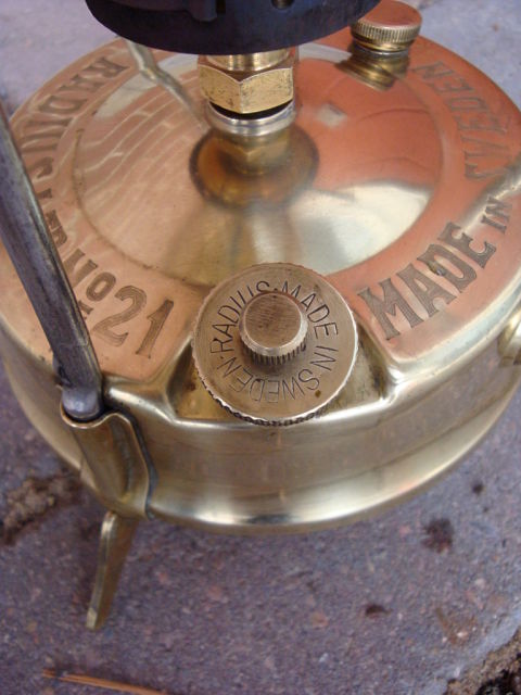

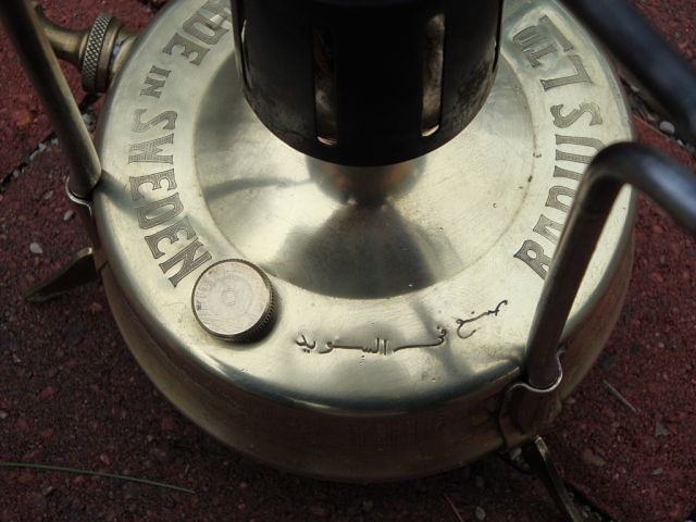

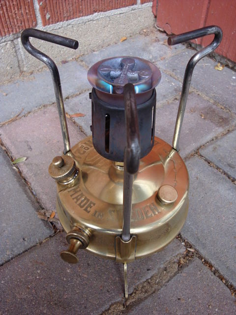

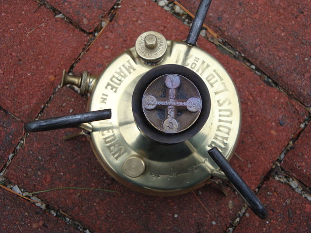

    This Radius 21 has one line of Arabic writing in place of the shooting star logo.

    Hi Matt, a lovely outfit, beautifully presented.
    I reckon this was one of the last Radius No.21 stoves produced, as the "shooting star" logo has disappeared and we have the Radius Ltd. and Arabic script dominating the lettering.
    I believe that no Radius stoves were made post-1963, so that puts a likely date on it.
    The tin and it's graphics are outstanding.

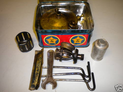

    Hi George,
    I agree with your date assesment. The condition of the stove and it's overall state seemed to tell me it wasn't that old. The tin is in remarkable condition with not one speck of rust and just a tiny scratch here and there. The small meths can is actually useable. The others I've got have tiny rust holes and are for the most part, for show only. Certainly not something you'd find stored in a shed or garage for 50 years. I was initially disappointed to see the logo missing, however the sheer quality of manufacturing of the stove itself made me feel much better! This stove has quite a heft to it, the brass is heavy. Cleaning it up was not too hard. It was dirty, but mostly just wet and oily. The NRV was fine as it was. The leather was serviceable although I need to get some more from Sefa. It would benefit from a new one. I've always wanted a Radius 21, and over here they are very hard to find. This stove came from a seller in Sweden. It looks as though I STILL have to find one with the shooting star to satisfy my stove urges...this just never ends does it?
    Even without the shooting star logo, I am very pleased with wonderful stove!

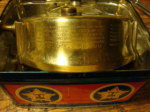

    I just realized I neglected to show the side of the fount and it's engraving.
    Ron, as long as there are stoves not yet acquired, I think the quest will continue. I always tell my wife there are worse things I could be doing...and her friends tell her the same thing!

    Great Radius 21! Its one of my favorite versions without the shooting star. It was manufactured in the 1940s. If the tin is without graphics or traces of them its most likely manufactured during WWII.

    Based on variations in knurling of the spare lid for the riser tube, the tin without graphics, being a so called "TYPE 3" Ltd, and furthermore not being the first or last variation of the TYPE 3, I came to the conclusion that "It was manufactured in the 1940s. If the tin is without graphics or traces of them its most likely manufactured during WWII."
    Your Radius 21 stove for example is the second variation in brass of the so called TYPE 3 stove. The first variation is slightly different. E.g. spare lid for the riser tube. See CCS examples. The spirit cans without graphics on them were in use from about 1940 and ceased to be delivered after the war. I have both examples in my collection and they were delivered with nickel plated Radius 21 stoves. One complete set without graphics. One complete set with graphics, plus matching examples of lanterns. I believe it was a war related. It coincides with changes of other Radius products. Tins were delivered to Radius by another Swedish company. I will try to publish the Radius 21 stoves I have. The catalogues are often inaccurate regarding the details.
