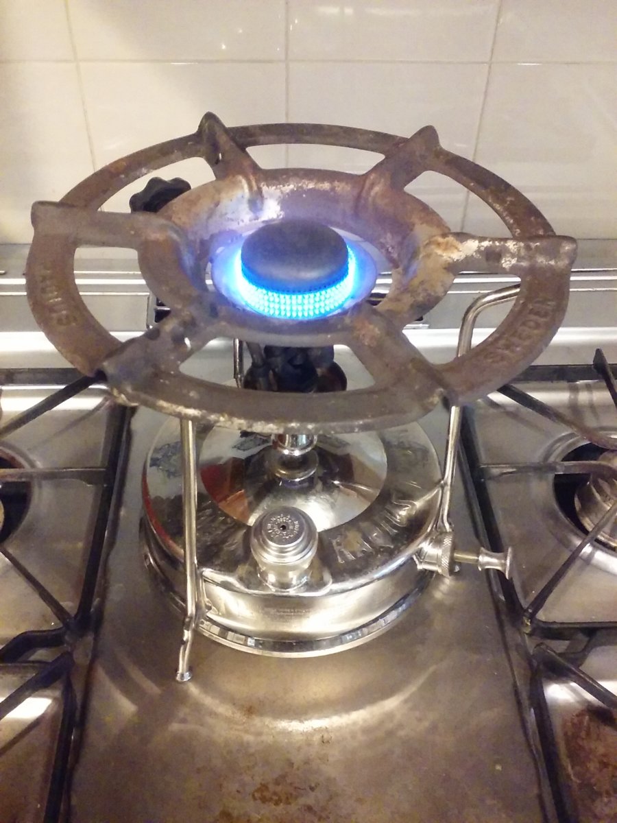

    Got my hands on a Radius no6 with a silent burner instead of a roarer burner (as shown in the picture above).
    I now wonder if my stove has been modified or did the no 6 came with different burner options?
    If it has been modified, do you think the stove will be safe to use with the silent burner?
    Thanks
    /Daniel

    Daniel
    As far as I can see, the photos above show the Radius with a silent burner (incomplete).
    In any case, as long as the silent burner is fitted properly it should work fine.
