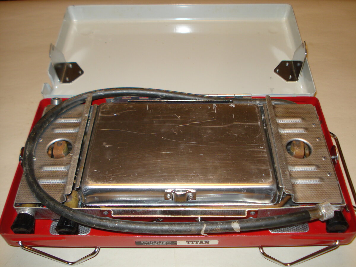

    I posted this here with all the other Tilley stoves, although the stove was made by The Tilley Lamp Company in Belfast, N Ireland - which, although part of the United Kingdom, is not part of Great Britain.
    (I know I am being pedantic, it's my age).

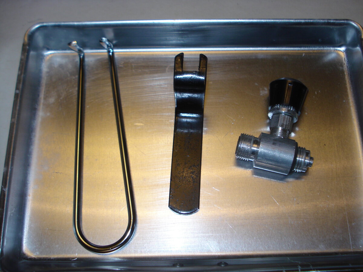

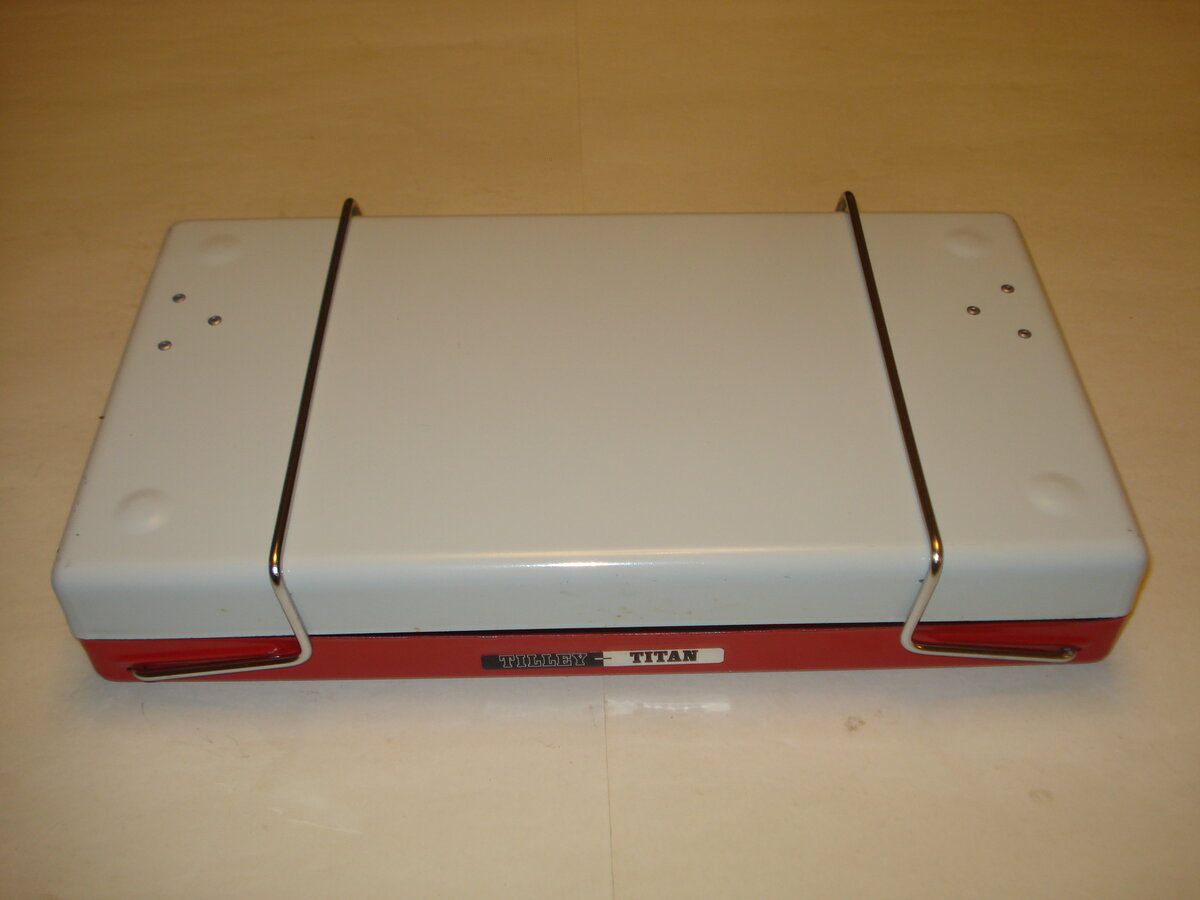

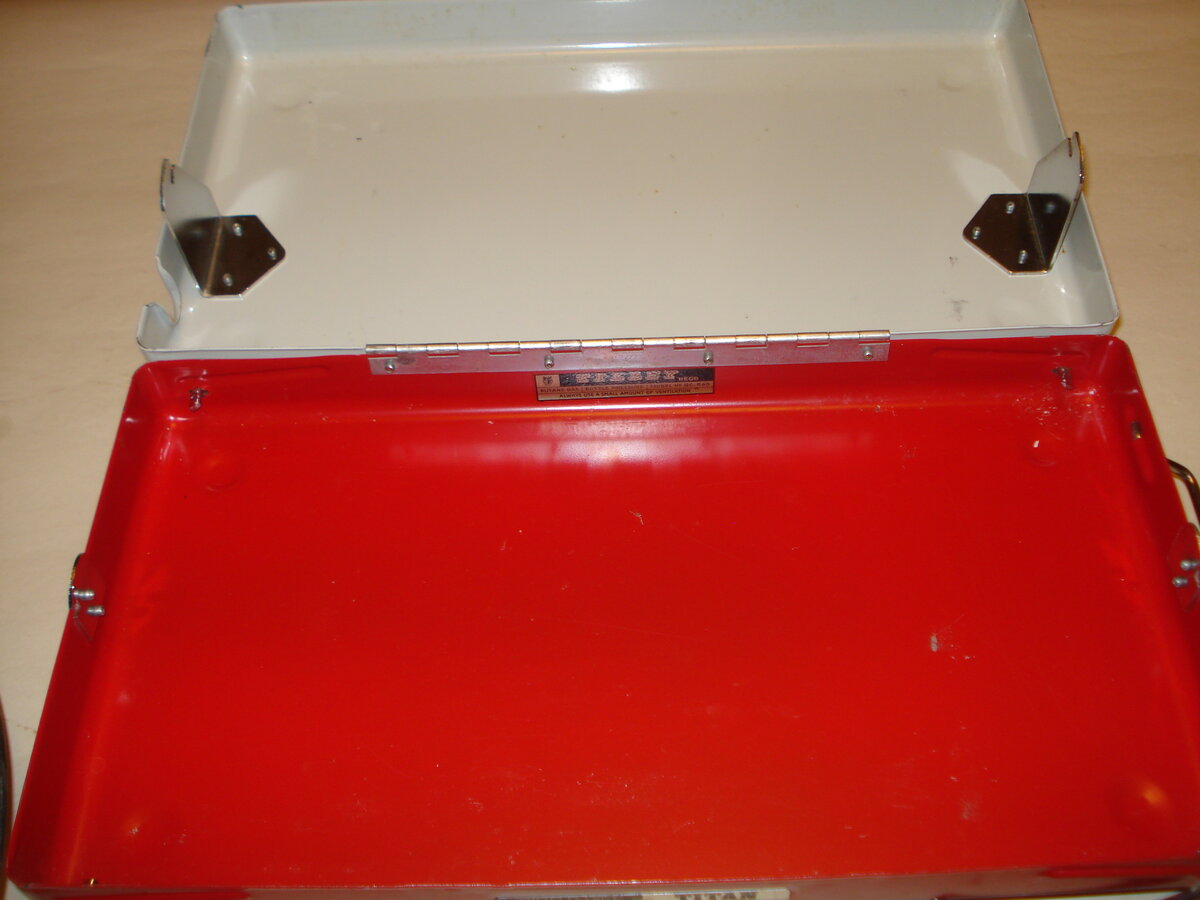

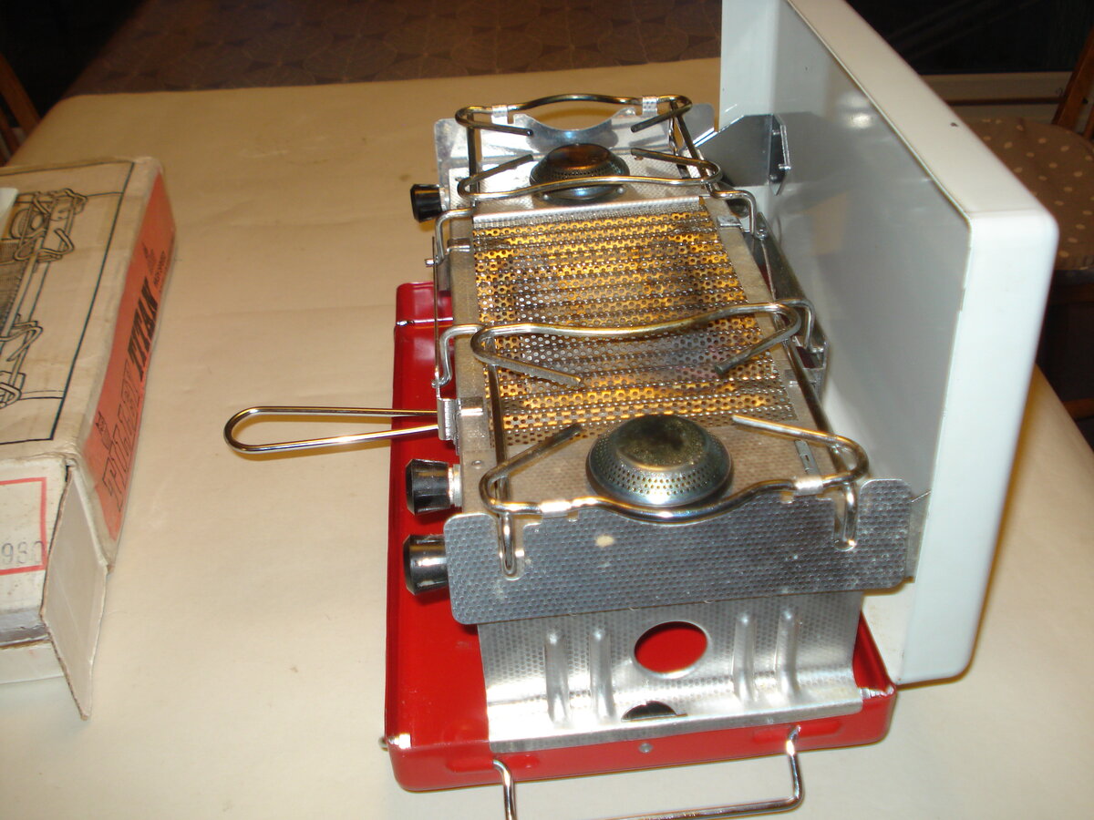

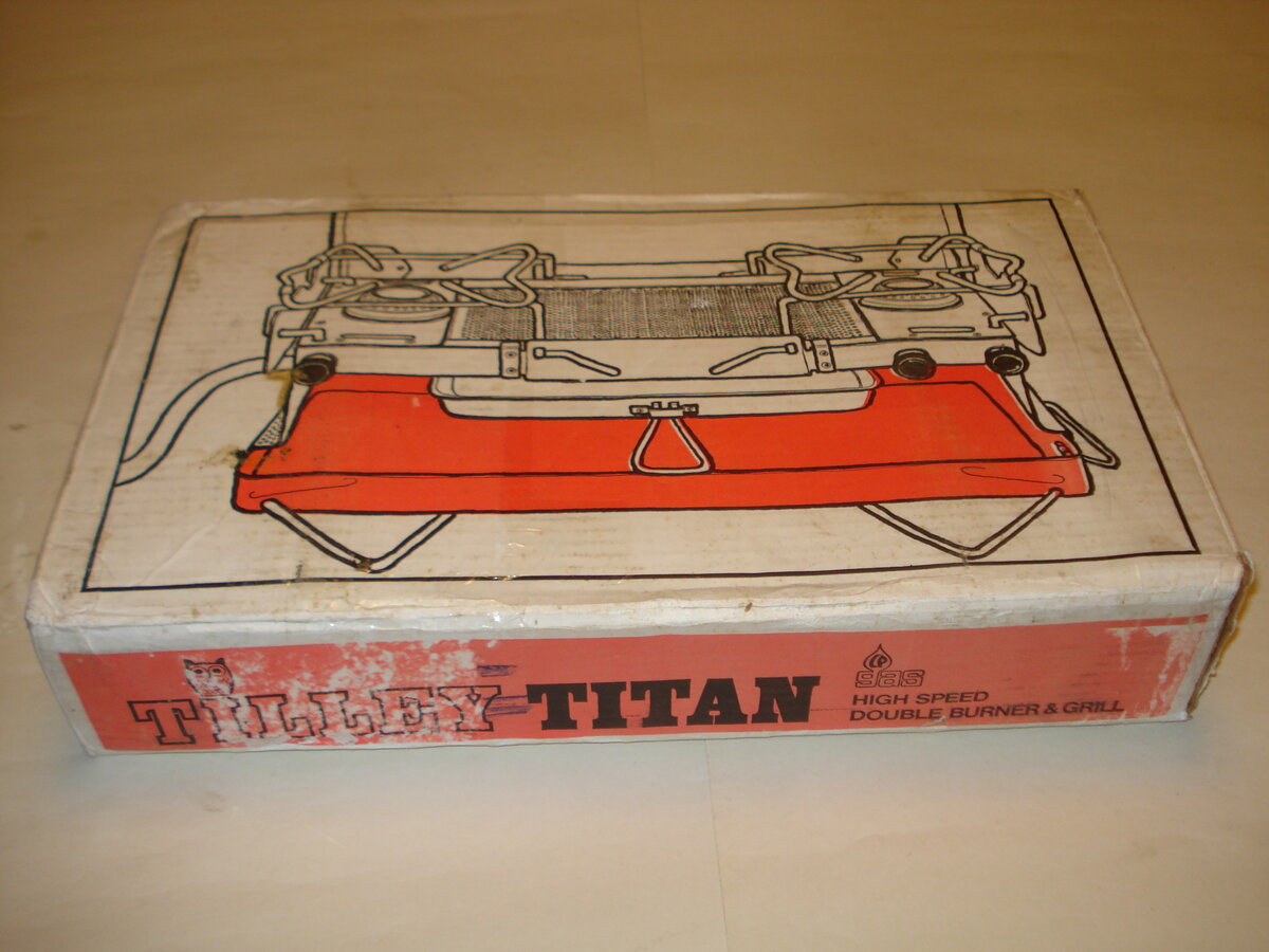

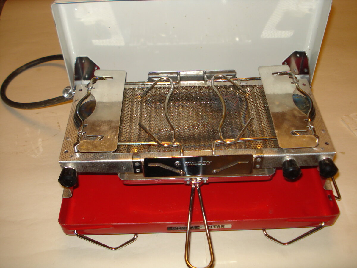

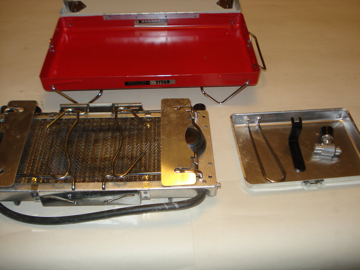

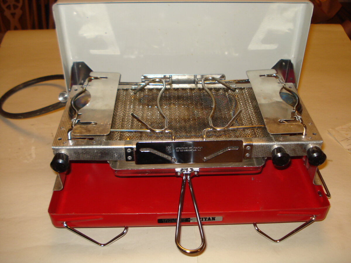

    The stove is a heavy beast, and build like the proverbial brick sxxxhouse. It came complete with 'regulator', nipple key, instructions and packing slip. It also came with the grill pan and handle, but no grill rack. Does anyone know if it was supplied with a grill rack?

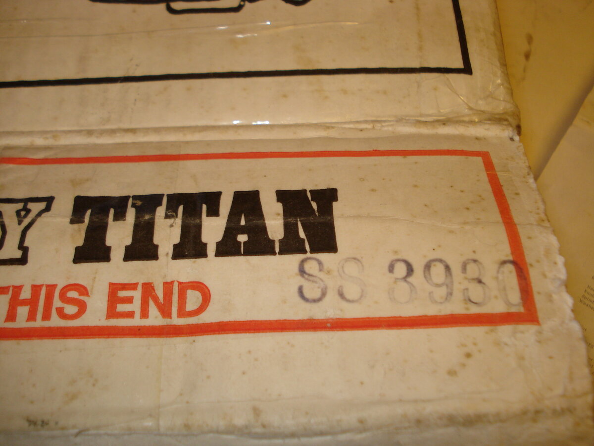

    There are no dates on any of the documents or the packaging.

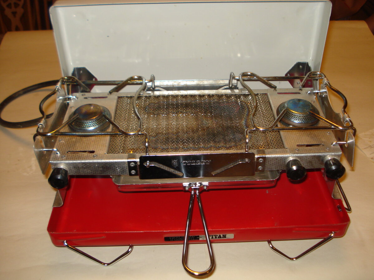

    However back to the OP, I have made a rack for the grill pan from a larger rack.
    I had to cut off one of the thicker side rods, bend the 'legs' on the end wires and cut to size. Then braze the side rod back on again.
  10. sammonsmx
    Sep 1, 2012
    28
    Ayrshire, Scotland
    No grill rack is supplied with the stove from new. I believe this as I have owned maybe 6 of these over the years - the first being one I inherited from my dad, which he bought new back in the 1970's and we camped with it for years. Your mod looks super. Would you make me one? I have two of these stoves, one I use regularly on camping trips, the other I keep nice. I replaced the original 1970's rubber pipe with a new pipe, as I was concerned about high pressure and the old pipe. I have adapted it to run off of EN417 type canisters, though the joints and pipe are not ideal. I am in the process of changing to a braided tube from China available on Ebay. The challenge is to get a clean join onto the stove. I do wonder what the thread is where the pipe meets the stove. I am guessing 10mm but I don't have the means to be sure. I am also short of one pan handle. All good fun.

    In case you're still wondering about the date of the stove, the black hose often has a date (month & year) printed or moulded on/in to it. I forget where I read it, but do seem to remember reading that Tilley stopped making the bottle pressure stoves somewhere in the mid 70's. The bottle pressure stoves can also run on regulated Propane, I think this is mentioned in the instructions?

    On the subject of the grill on the Titan, does it also function as a 3rd ring burner? With the top/upper part of the grill being open I wondered if it was dual purpose. While grilling you can also heat up other food in a pan placed on top of the grill between the two rings? Thanks.
