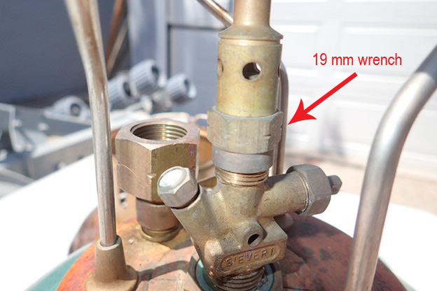

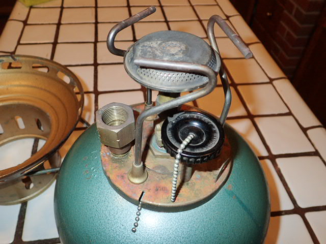

  11. z1ulike
    3,542
    Use a 19 mm wrench and turn it clockwise. The threads are backwards.
    If you want to fill it then screw on the adapter, attach a propane source, and open the valve.

  13. Simes
    Simes Subscriber
    4,541
    I'm on the way....
    That is neat, the refill adaptor parked on the tank.
    Gas hose connectors left hand thread so adaptor has to be self tightening when connecting the refill hose I assume, burner obviously the same. Happy to be corrected working from dodgy memory here.

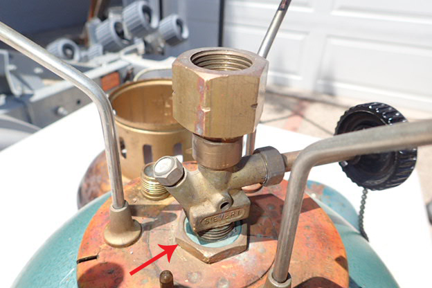

  14. z1ulike
    3,542
    Yes, of course. First loosen this big nut at the bottom of the burner.
    Then remove these two semi-circular plates. This will allow you to remove the pot supports from the stove.
    With the pot supports removed you can then unscrew the entire valve and burner assembly from the tank using a wrench across the flats where it says "Sievert." I believe a 21 mm wrench would fit but I don't have one. I do have a 13/16" wrench which will work as well.

  16. Oskarsweden
    Oskarsweden Sweden Subscriber
    Jul 19, 2018
    30
    Sweden
    Wich way to turn the big nut to unscrew? Clockwise? Thanks again
  17. z1ulike
    3,542
    The big nut has normal threads. Turn counter clockwise to take it off.
