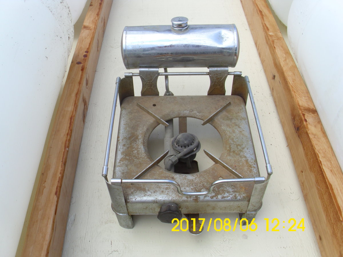

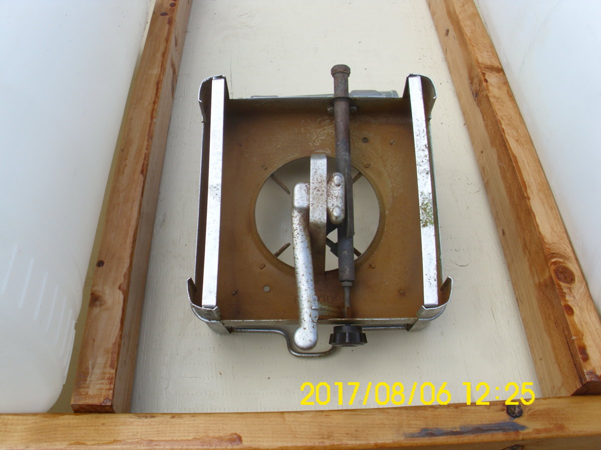

    It's been a LONG time since I found a stove and bought it. This is one of a type that I've wanted ever since learning about them. I've never owned a boat, but the stove type fascinates me. I found this advertised locally. I've not tried to test it yet, so no flame shots. If I can remember how to load the pics, I'll edit and add to the post later on!
    Apparently, the new forum doesn't require resizing of images? SWEET! :-)
    Oh, does anyone know the easy way to remove the surface rust?

  2. Tony Press
    6,499
    @Matukat
    For delicate jobs with paint and plating, I use "Hammerite Rust Removing Gel". It's been excellent on nickel-plated tanks and similar. Patience is the key.
