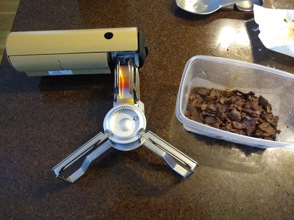

    Hello all,
    New, not classic (yet.) Ordered directly from Japan as they don't offer it in the US. Very silent running stove. Has igniter, very good simmer control. Very much as described, for home & camp.

    It's a good brand but the proximity of the valve on the cartridge to the heat would be a bit of a concern for me.

    That was my initial thought too. There’s heat-shielding, true, but the discolouration due to heat of the base of the channel beneath the pot rest closest to the fuel cartridge inlet suggests it’s a close call.
    Locating slot upwards with the fuel cartridge installed, so a gaseous and not a liquefied gas feed, which is usual. Consequently, I wonder if performance tails off in use with the evaporative cooling of the fuel? Maybe not if there’s an amount of radiant heat reaching it from the burner!

    If you note the 5th photo, there is a wide copper channel running from the burner and then mating to a second copper piece at the pivot. I think that they are purposely trying to channel heat from the burner to the length of the canister for this very reason. They have obviously engineered the heck out of this design. But that doesn't always guarantee long term reliability. I assume they have tested that safely part, but...

    From my understanding the "cassette" type stoves that run on 100% butane generally have the little heat strip feature that runs to the canister since when you begin to run down on the canister of gas they start to chill out. This is really noticible with pure butane since the cans will lose a lot of pressure as they drop towards 32F. Being an owner of two cassette stoves (a 15k GasOne and an Iwantai Eco Premium) they all have the little metallic plate that goes from near the burner head as a little finger that sticks out into the flame or near it and then runs back to the canister:
    In a way, some of the crazier appearing things like "Alpine Bombs" and "Moulder Strips" (upright stoves with a little copper or aluminum strip velcroed/rubberbanded to the side) are imitating the mechanism that these cassette stoves are already doing with their gas feed 100% butane.
