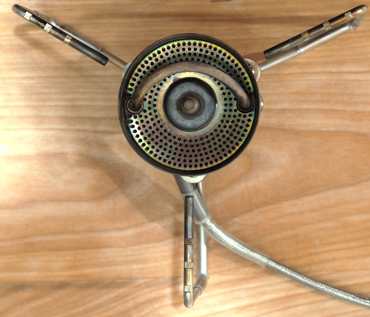

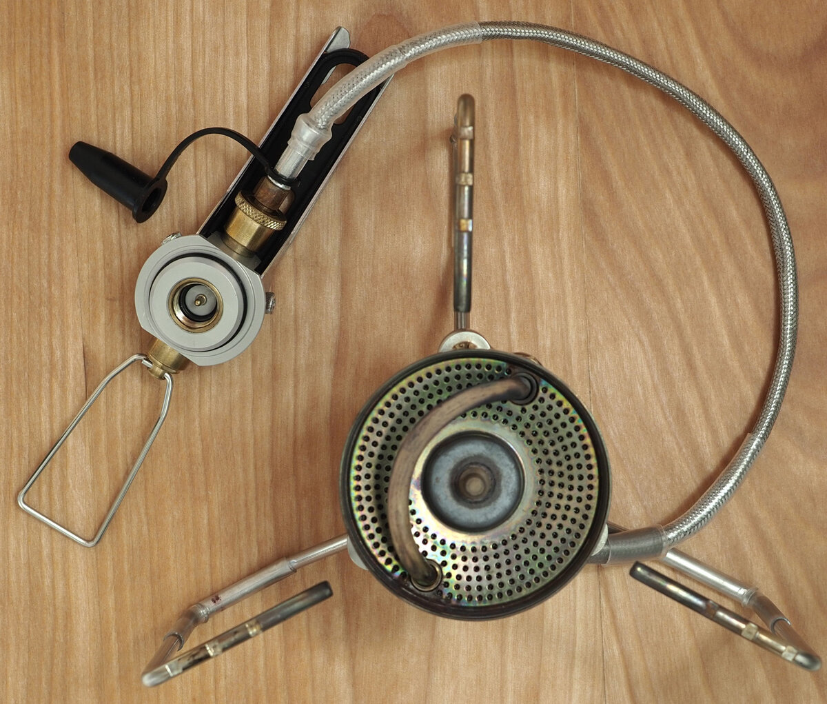

    I'm surprised the Soto Stormbreaker never got a post nor did Hikin' Jim finish his review, especially as the Stormbreaker seems to be temporarily out of the US market (according to the Soto US website blog). I was fortunate enough to get a second hand one from someone who was parting from theirs and it is now my second air-fuel mix start stove next to a Snow Peak Gigapower WG.
    I have it modified with a lot of heatshrink because the fuel line is extremely flexible. So flexible that I feel that it needed some protection around the ends, especially on the end that goes to the pump. On that end there are two layers of heatshrink to give the line variable compliance. Where it is closer to the crimp, there is more stiffness and then the single layer allows for a "soft" transition rather than a hard pinch. Equally, the silicone boot on the stove end is a good idea but it acts like a hard pinch point potentially so I added heat shrink. There is a little bit of heat shrink on the legs/pot stands to act as rubber feet and to serve as insulation for handling the stove as well.
    Stormbreaker Box Front.jpg Stormbreaker Box Back.jpg Stormbreaker Box Side 1.jpg Stormbreaker Box Side 2.jpg

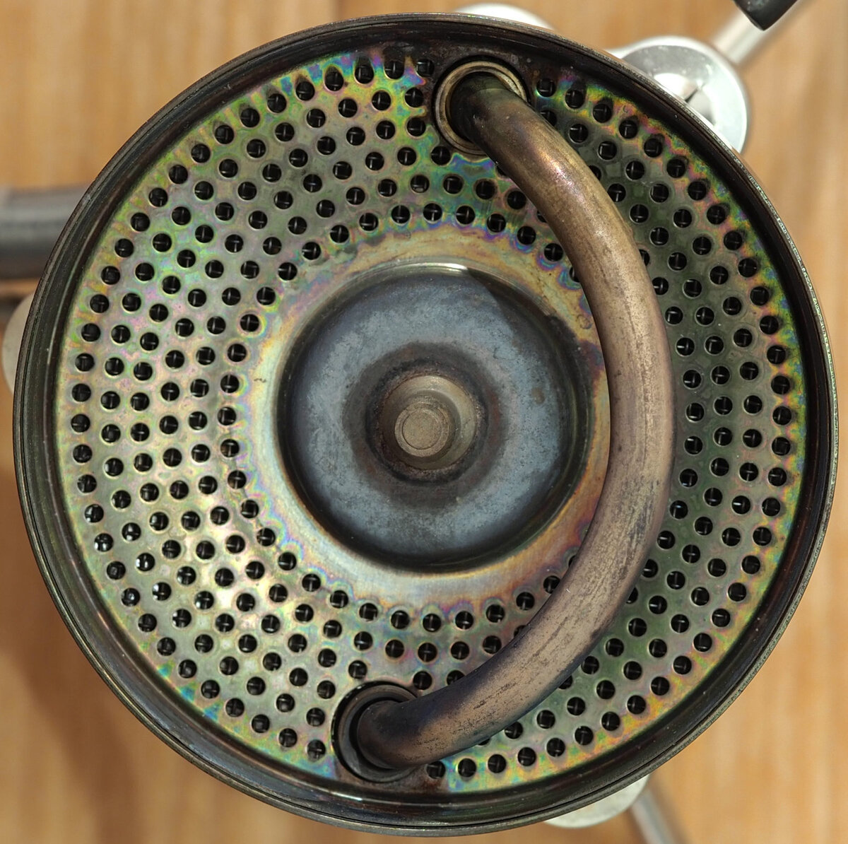

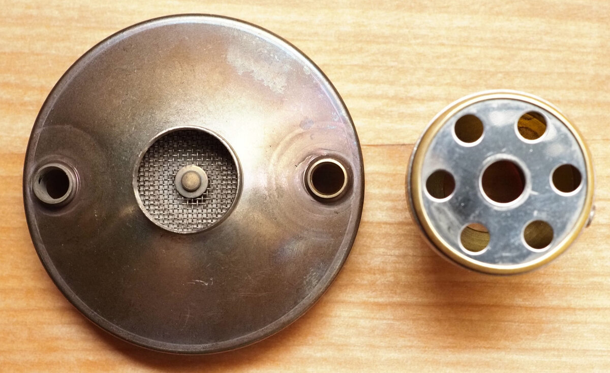

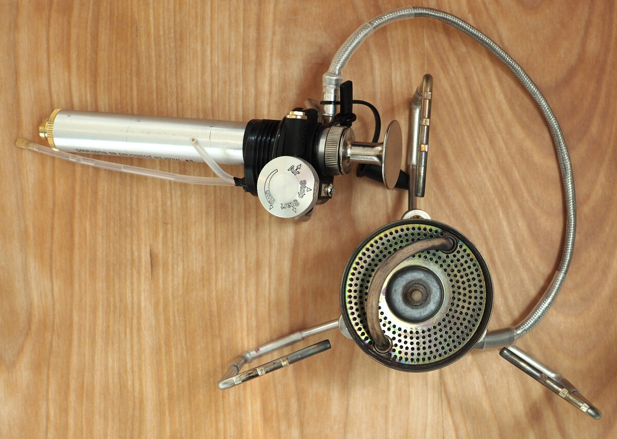

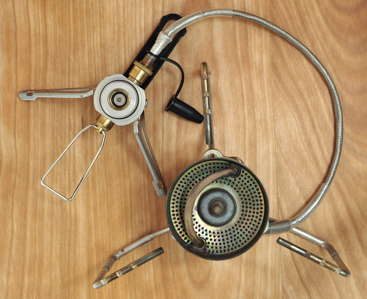

    Stormbreaker with Pump.jpg Stormbreaker with Isobutane Adapter Folded.jpg Stormbreaker with Isobutane Adapter Unfolded.jpg

    I read about the pump potentially leaking but so far with my very gentle use of a second hand pump it seems to have held up fine. I have left it pressurized before and it doesn't seem to have leaked but the bottle was stored upright. The pump reminds me of the Primus ErgoPump where the piston, cylinder and a few other pieces of hardware are plastic but the threaded part is plastic.
    The (very complex) valve mechanism is probably the niftiest feature. Push down to cut the flow is nice and having a 90-ish degree swing arc for flame adjustment makes it behave more like an actual kitchen range. The only thing is that with a lot of pressure in the bottle it is kind of finicky to get the super low simmer settings as it involves slowly dialing the valve setting while watching for the flame to bump it back up before it goes out in a shaded area or at night. Beyond very slow simmers, general adjustment is quick enough that it seems to slowly begin to throttle back within 1-2 seconds with a little bit of latency. Throttling up is super-fast and responsive by contrast.
    The fuel filter which is a sintered piece of bronze can be twisted off the line. The line doesn't have to be cut like Soto's diagrams advise and I wouldn't cut it because the fuel and air lines seem to be additionally caulked to seal it in or otherwise glued in on the outflow side. While a little cut probably means very little, I would avoid any destructive acts to the line, especially when the filter just inserts back in. Maybe it could be "backwashed" or otherwise replaced for long term purposes.
    The little debris guard is a nice feature but it isn't included on the butane adapter for some reason. The small hole on the quick connect fitting along with the debris blocking mesh just before the jet makes me believe that it is a little vulnerable. I would put something like a piece of heatshrink with the end sealed or a plastic cap over the butane adapter because of that.
    Output difference between pure butane vs white gas and additional remarks:
    Room temperature pure butane (not isobutane mixes) has reduced output even in liquid feed mode in contrast to white gas. A little bit of "warming" of pure butane cans (as in the long cassette stove type) to bring them closer to body temperature will cause the output to rise but the Stormbreaker seems to be optimized for white gas in my opinion. With a fully pressurized bottle (read: hard to put any more pumps into if the bottle isn't pressed against something on the bottom end) the Stormbreaker just throws heat out with a nice warm glow.
    Pure butane does have a lower operating pressure: At 125F it only hits 61psi. In contrast, a 70/30 butane/propane mix which is comparable to some isobutane/propane mix ratios has around 60psi of pressure at 40F. At 70F, pure butane only has 17psi of pressure, the 70/30 butane mix has 20psi at 40F. I can only assume that the Stormbreaker operates excellently off proper isobutane mixes compared to butane and otherwise would be very happy with propane assuming nothing bad happens with the seals.
    Pure butane seems to vaporize in the adapter readily when it is 70F, the butane doesn't actually hit the loop as a liquid. A little bit of chill is felt on the adapter.
    The long cassette stove canisters actually can be used in a nifty way with the right adapters where the adapter doesn't need to have both legs deployed. The double o-ring on the butane adapter seems to fully seal against the cassette canister adapters early on and has over an entire turn more in which it can be tightened. I have found this allows me to start the stove with the butane canister lying on the side with the notch facing up for gas feed before further tightening the adapter to rotate the notch 180 degrees so it feeds in liquid mode.

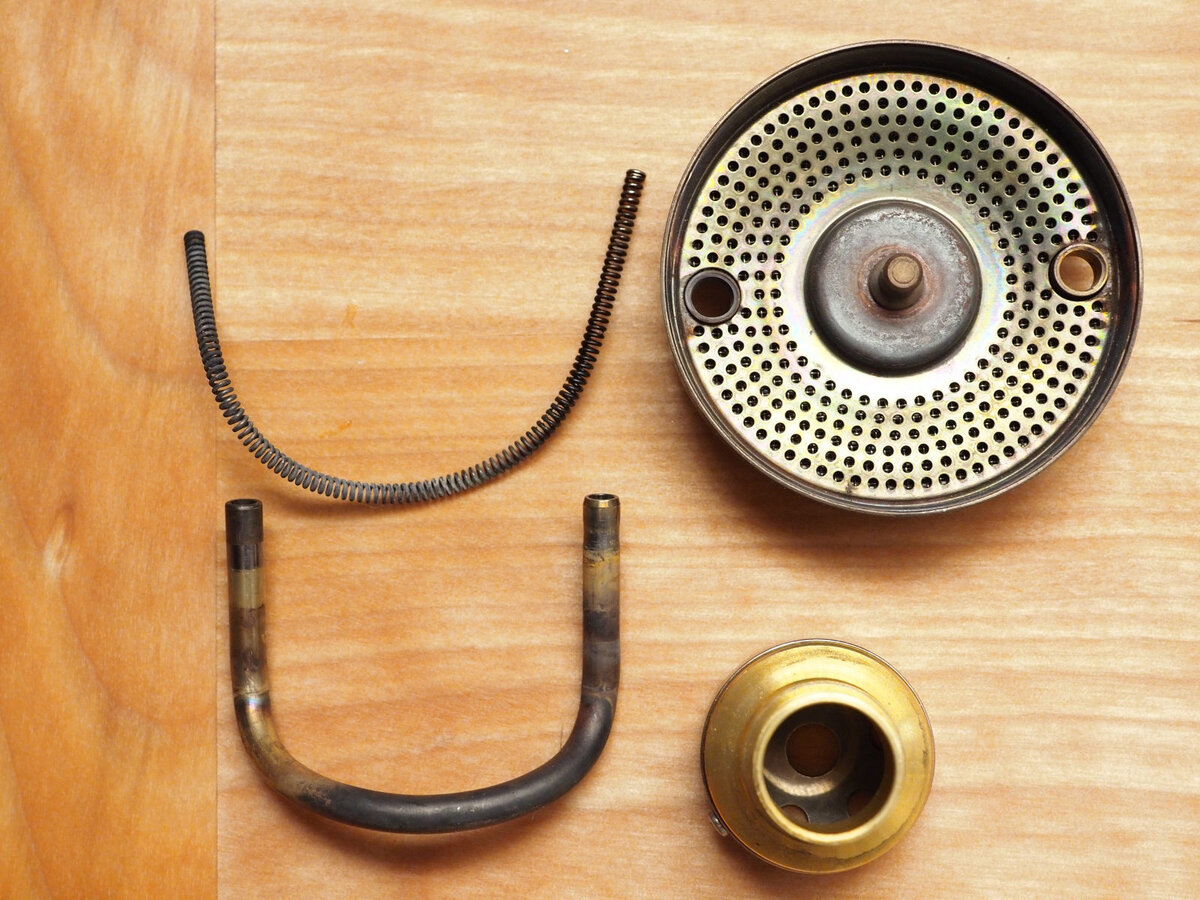

    Jet prefilter and cleaning the stove
    I may have to retract the statement about very well pressurized fuel canister for power, it seems I may have had a very slow acting clog that built up over time. This also marks my first "malfunction" with the Stormbreaker so far but I think the charcoal starter fluid is likely attribute of my own fault. I had noticed that not only was the butane performance underwhelming in a recent firing but significant underburn was occurring. Later in the day I had fired the Stormbreaker up on liquid fuel and it seemingly struggled to the point that barely any output was there.
    When I took the little cap and filter on the bottom off a bunch of fine black powdered specs dropped onto the aluminum plate I was working on as a surface. There were a ton of little specs captured by the filter with some pieces embedded into it. They easily bounced off with the gentle fingertip touch. Taking the little cleaning wire out and prodding into the jet, I noticed even more pieces of fine carbon falling apart. Inverting the stove I had even finer pieces fall out into the plate I was working on...
    A few prods and with the cleaning cap reassembled all the power was there and even some more with how pressurized that bottle was. The flames were more than enough to saturate the heat exchanger fins on the kettle I was using at full power. Curiously no smell of unburned fuel this time, just disk of fire that was over a half inch/centimeter "thick" off the base of the kettle that rushed towards the fins of the kettle. Maybe there was just enough heat there to ensure total combustion just as the flames hit the heat exchanger fins. A bit of a different experience than when I had set a very thick pan onto the Stormbreaker and I could smell a little bit of the stink from the charcoal starter fluid I had mixed into the fuel.
    To conclude: There was plenty of power without having to crank the valve full open after significant work to pressurize the fuel bottle until it was very difficult to pump after a cleaning.

    Generator color as a "flame indicator"
    Also the generator will visibly "change color" in aforementioned low simmer operation. It goes from the reddish-brassy color to a brief dark coating forms from the heat being insufficient before the pulse of heat turns it briefly blue towards the jet end and then back to the reddish-brassy color. The Stormbreaker's generator will turn dark as the stove is shut off from what I suspect is unburnt fuel so aside from the acoustic tone of the stove turning, examining the generator's "color" at low throttle settings is a good way to determine if the stove is lit or not in daylight.
    Part-way settings from start and air
    The valve will allow for operation with it not being set fully to air or start, it simply reduces the flow rate and makes the stove run a little richer towards the start side if it is set a little low. I have found that the Stormbreaker can be operated at a "reduced power" start setting for less of a huge flame during startup, especially on white gas. If the generator is sufficiently hot from a jet lighter helping out, the valve can be set between off and start and warmed up with less pressure in the bottle being lost from the start position.
    Watch the flame color and the Stormbreaker after heating the generator with a lighter and it will practically "start" like a canister stove. It can be immediately followed up by placing a pot or pan over it in the start position to practically eliminate fuel wastage from starting it up all without sooting the pot or pan. The flame won't overrun the bottom of the pot and come up the sides, either. A little bit of pumping and after a minute the valve can be turned over to the normal run position.
