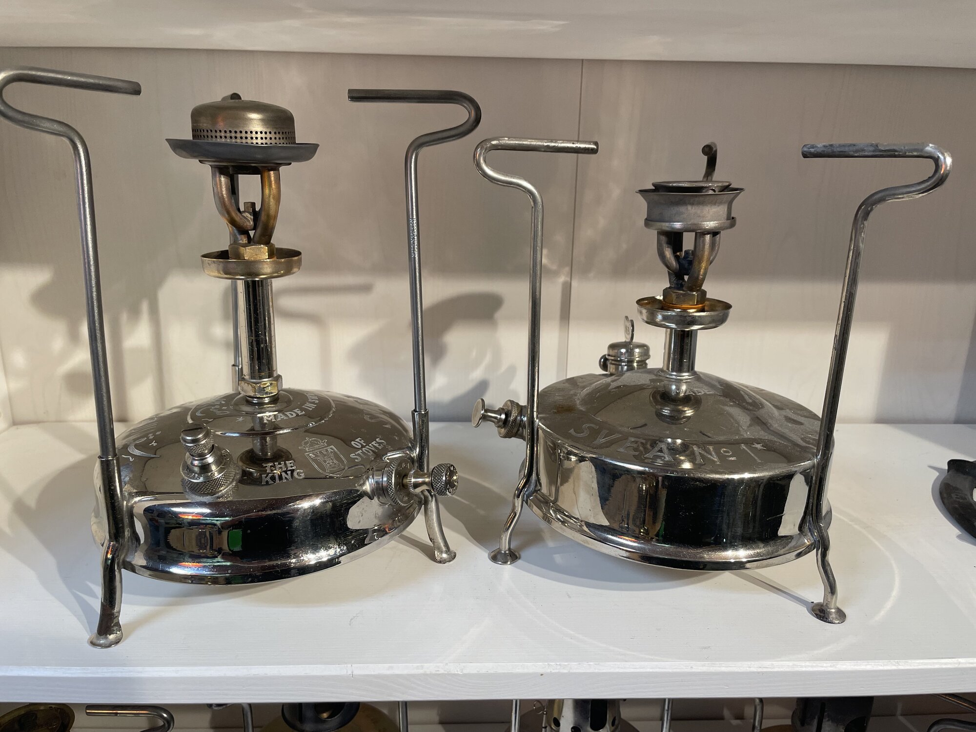

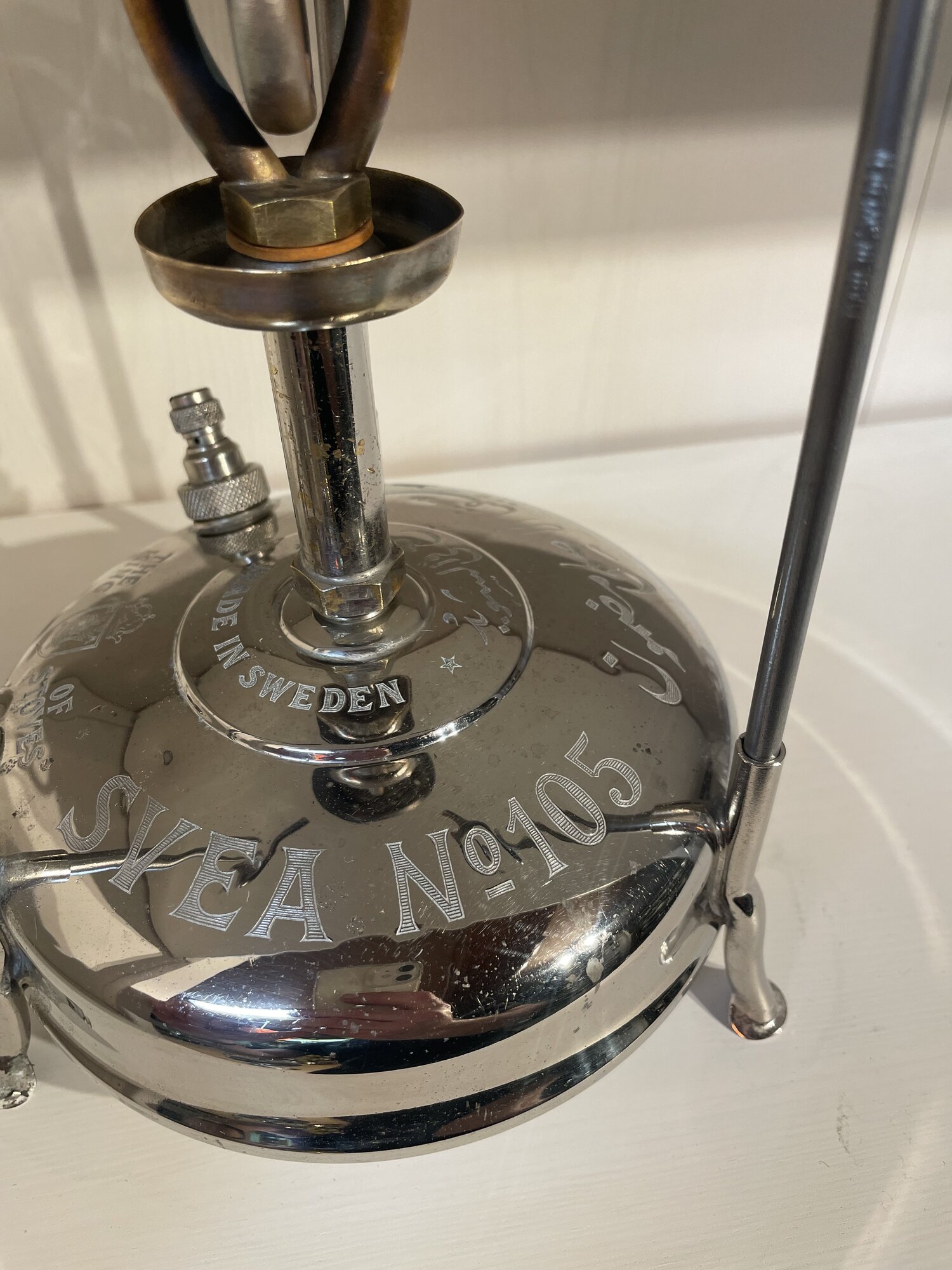

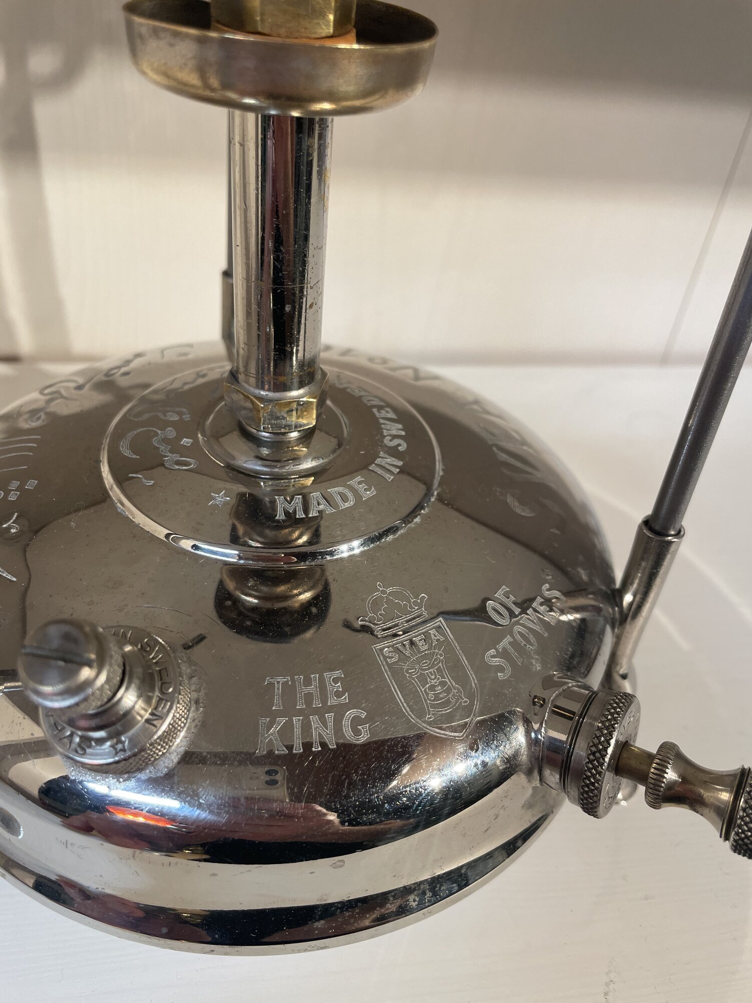

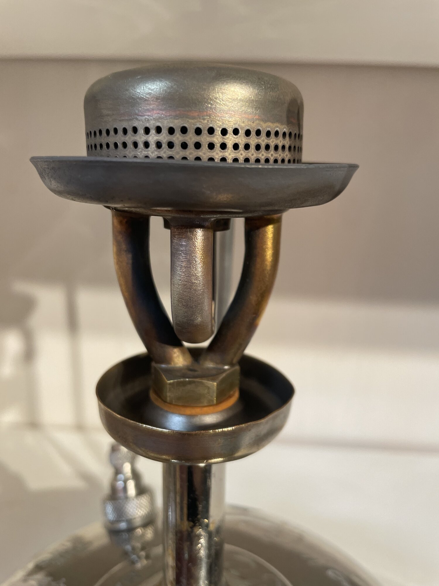

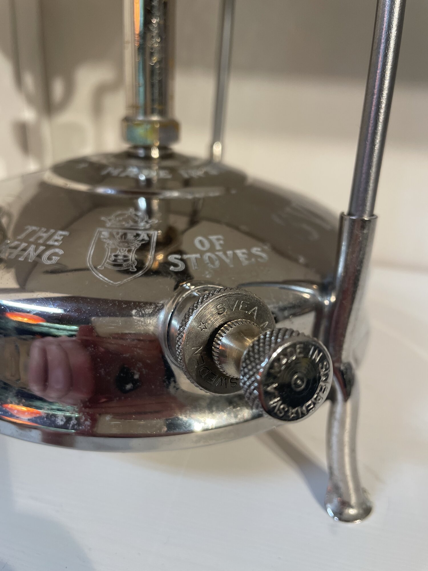

    I have this longlegged mystery.

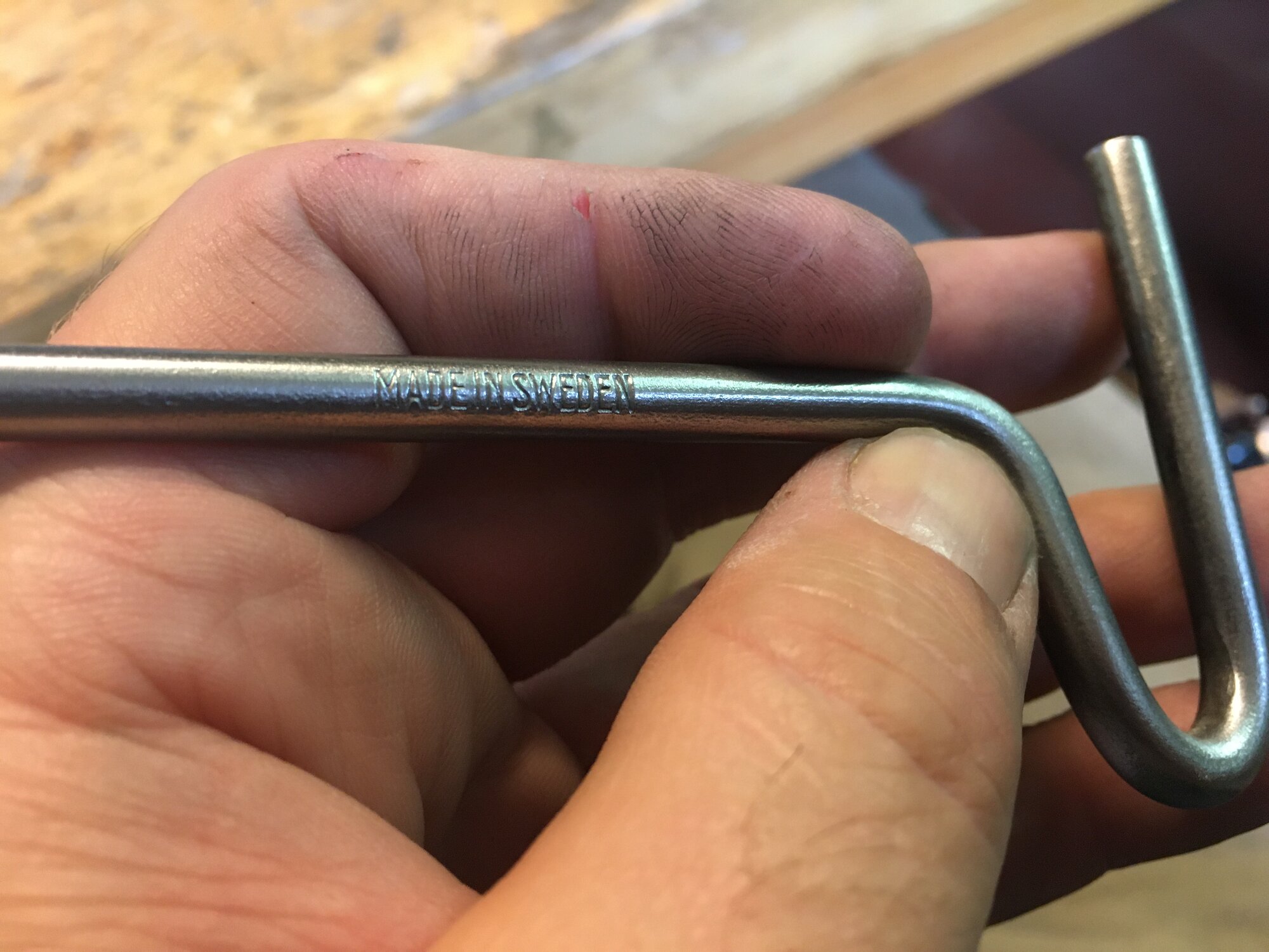

    The legs and risertube are longer, and as you can see, there are original Svea markings on the legs "Made in Sweden"
    IMG_2346.JPG IMG_2347.JPG IMG_2348.JPG IMG_2349.JPG IMG_2350.JPG IMG_9563.JPG IMG_2343.JPG eryer.jpg

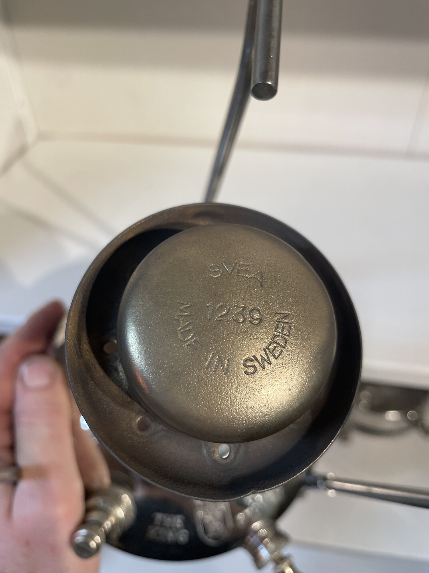

    It burns great with the 1239 spreader.

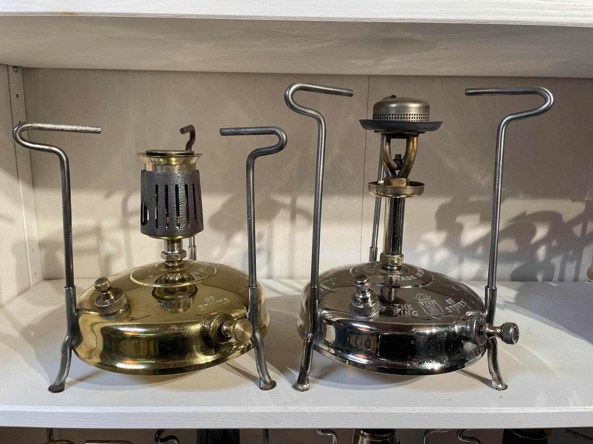

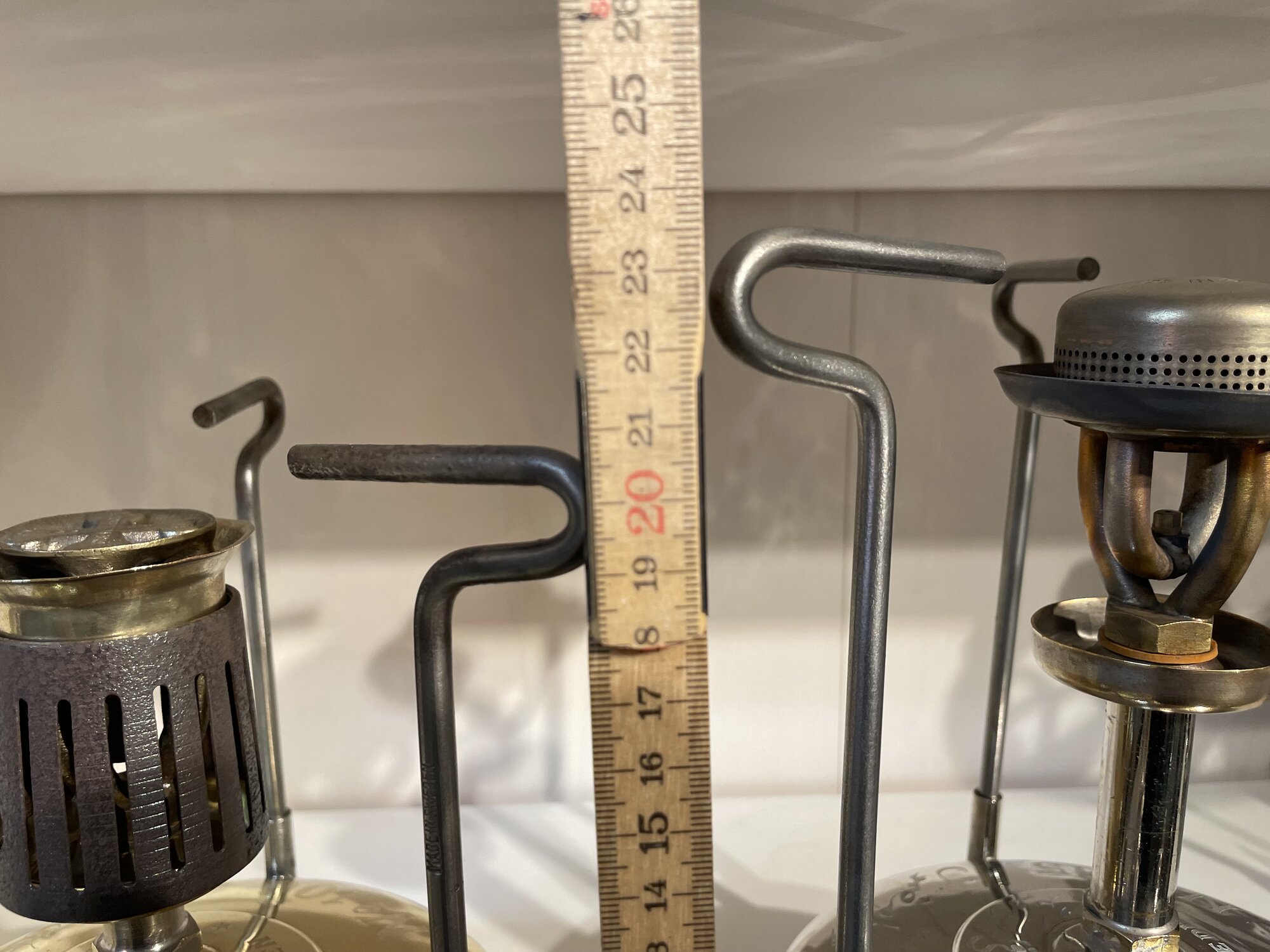

    Here you can see it next to siblings no 106, and no 1.

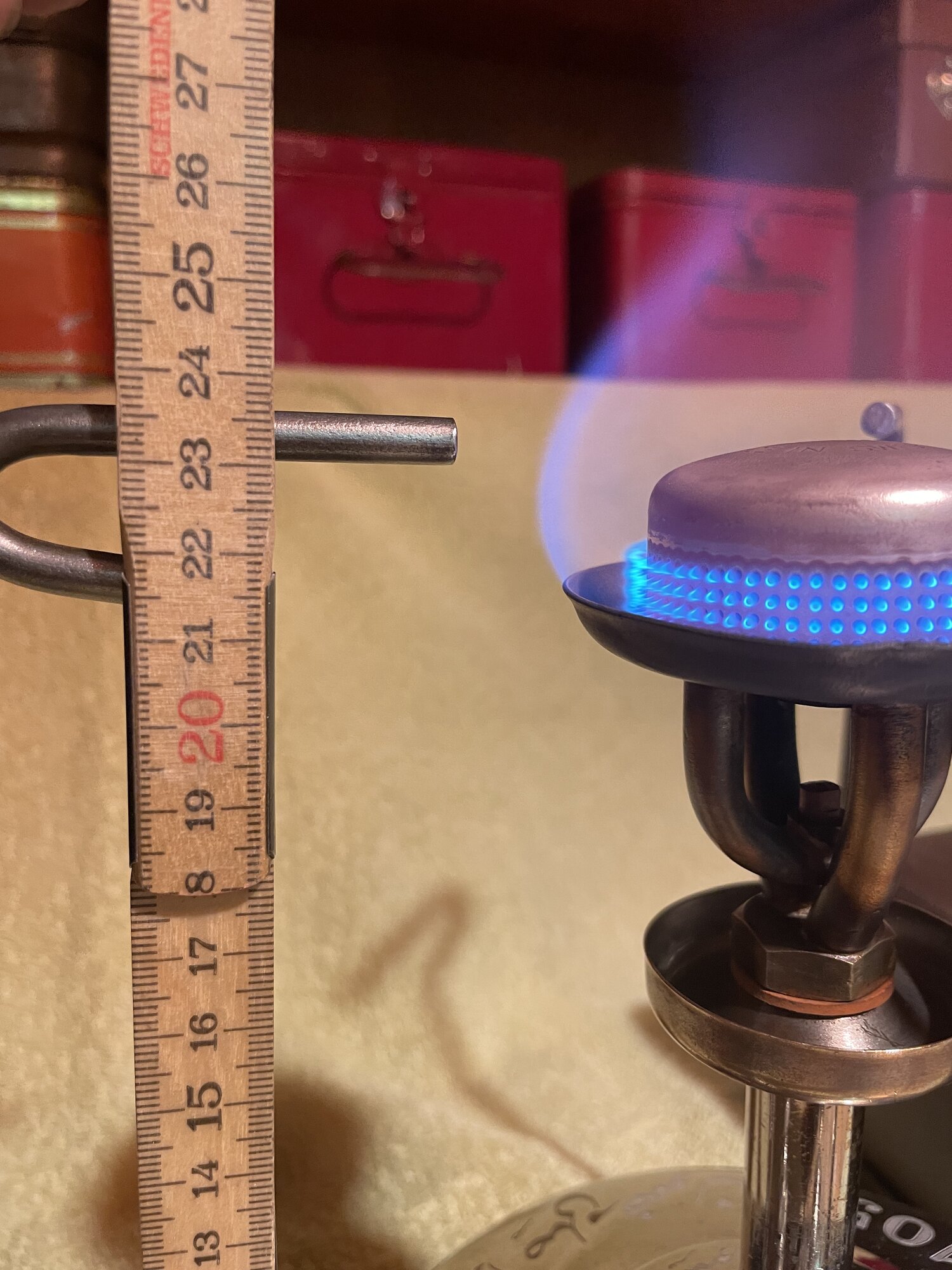

    Does anybody have a clue to what the long legs are for?

    I have some detail to add. to your reference post, re your question. I do not recall seeing a 105 heater / stove but the long riser, long removeable legs, and SRV filler cap are parts used on models originally produced/sold as a stove/heater. All parts new in the box allowed use as both a heater or a daddy long legs stove.
    In-general SRV filler cap is often provided when "original" stove is/was fitted with regulated burner. I for one would appreciate better look at SRV cap (w/PN?) if that is still handy.

    My guess (and I emphasize GUESS) would be that the legs and burner of a different heater/stove have been swapped on. My reasoning is open to challenge but is simple. Heater/stove combination devices I have seen have a ring that the feet are attached to, making the device easier to push along a floor and less likely to dig holes in pine boards.

    Hi, I reckon that this @Swe-stove Beautiful stove heater came out off the factory this way. It is effectively a Svea No.35 with a Svea No.105 tank
    1. All the parts are period correct except the tank, which is marked Svea No.105 rather than Svea No.35.
    2 The polished Nickel plate is uniform and near perfect.
    3. Swe-stove’s Svea 105 carries the same distinctive combined filler cap incorporating both pressure release and SRV valve as used on the earliest Svea No.35 stoves.
    Swe-stove Svea 105 @Swe-stove
    Distinctive Combined Filler/Pressure Release/SRV Used on the earliest Svea No.35 stoves.
    Reference @igh371.
    Ian says: No way to give precise dates but this variant must be from the late-'20s/early '30s.

    I can see the riser being from a heater, that is plausible,, but not the legs, heaters have no legs...
    Or were they sold to be combined stoves/heaters? Dual settings weather you were heating or cooking?
  14. kerophile
    14,338
    H @Swe-stove the particular models we are discussing here were dual-purpose and could be set up as either heaters using parabolic reflectors, or as conventional stoves.

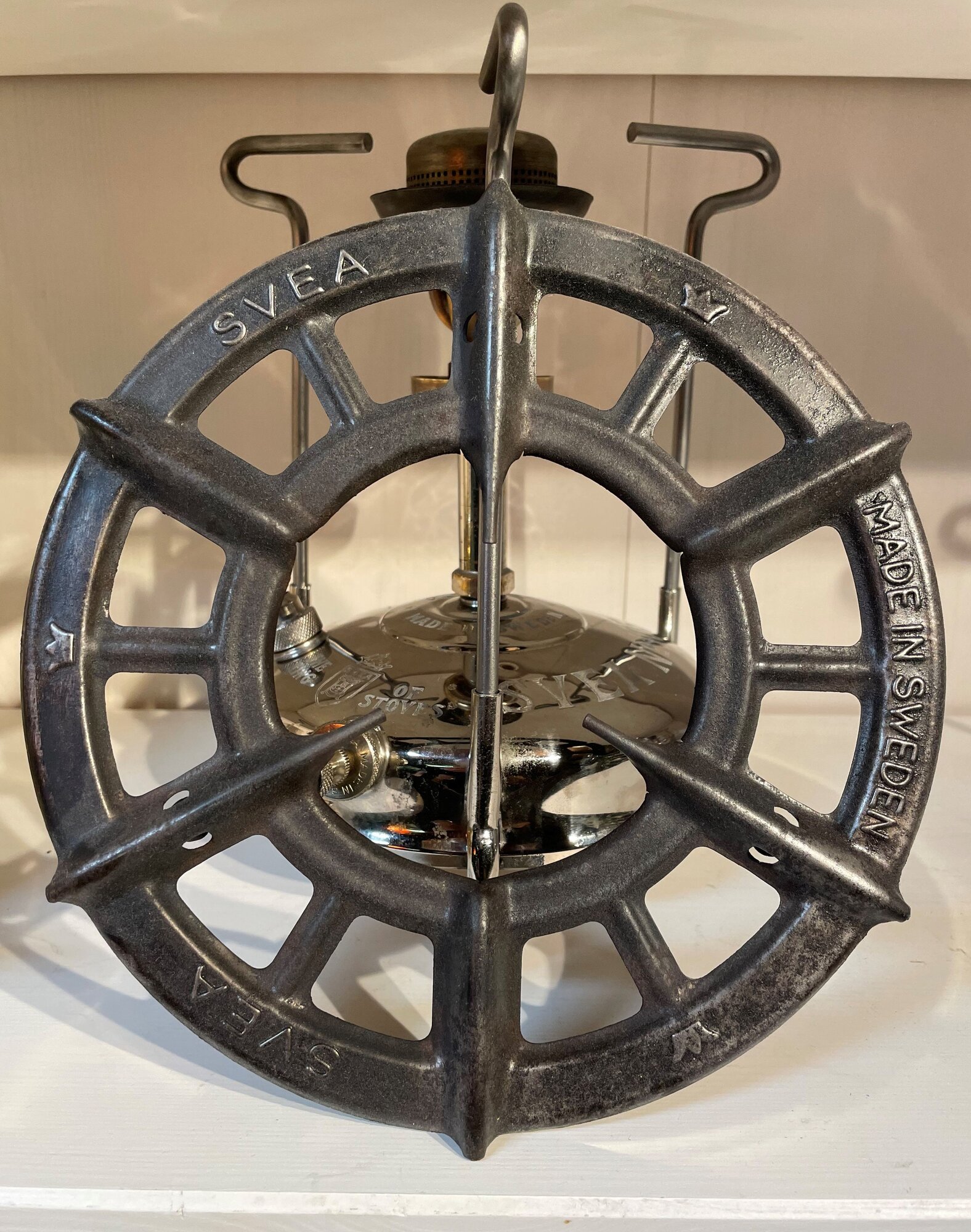

  16. Tony Press
    Tony Press Ukraine Subscriber
    10,788
  17. Swe-stove
    Swe-stove Sweden SotM Winner Subscriber
    Dec 9, 2019
    44
    Sweden
    @kerophile - thanx for explaining for me, i see now what i did not realise before...
    @Tony Press - thanx for that illustration, and link to your beautiful heater.
